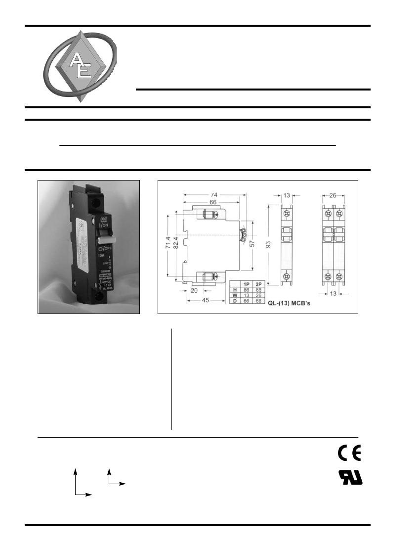

DIN Rail Mounted Circuit Breakers
UL 1077 Rated
Features:
• UL 1077 Approved (UL 489
also Available)
• DIN Rail Mounted
• Compact 13 mm width
• One, Two & Three Pole
• Current Rating up to 50 A
• 100% Rating Capability
• Hydraulic-Magnetic
Technology
Technical Data:
Numbers of Poles
maximum Voltage
Minimum Amp Rating
maximum Amp Rating
Interrupting Cap.
1, 2 & 3
277/480 50/60 Hz
1 Amp
50 Amp
5000A @ 120V
1000A @ 277V
1000A @ 480V
1960V 50/60 Hz
100 Megaohm
-40˚C to +60˚C
Dielectric Strength
insulation resistance
Operating Temp. Range
Part Numbering System:
C____A___P
No. of Poles: 1, 2 or 3
Amperage:
e.g., 1 for 1 Amp, 15 for 15 Amp, etc.
Example: C10A1P = 10A single Pole Circuit Breaker
