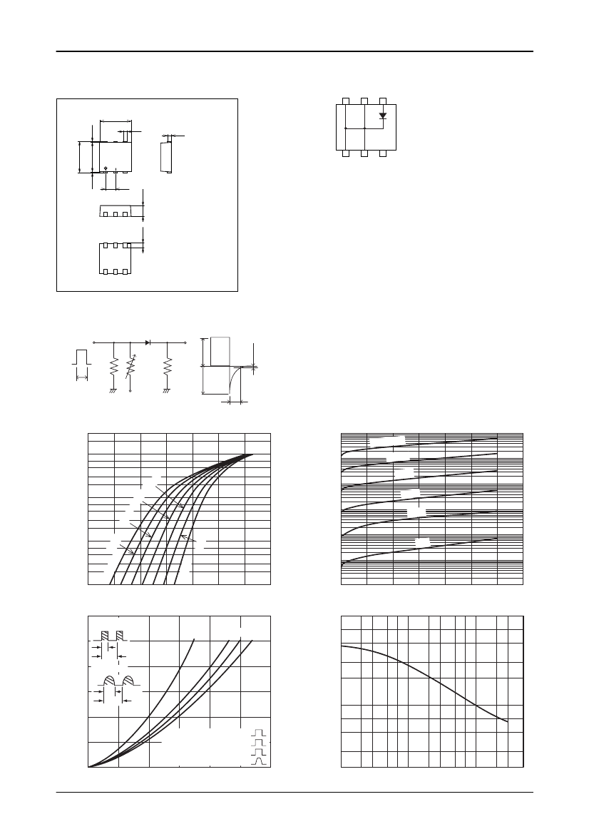

SB0503SH
Package Dimensions
unit : mm
7028-001
1.6
0.05
0.2
Electrical Connection
6 5 4
0.2
1 : Cathode
2 : Cathode
3 : No Contact
4 : Anode
5 : Cathode
6 : Cathode
Top view
1.6
2 3
0.56
0.05
1 : Cathode
2 : Cathode
3 : No Contact
4 : Anode
5 : Cathode
6 : Cathode
SANYO : SCH6
trr Test Circuit
Duty≤10%
100mA 100mA
10mA
50Ω
10µs
100Ω
0.25
10Ω
--5V
trr
0.1
0.01
0.001
IF -- VF
1000
0.1
0.01
IR -- VR
Ta=125
75
Reverse Current, IR --
µA
Forward Current, IF -- A
Ta=
125
75
--25
0.001
0.6
0.7
IT08547
35
IT09655
0.1
0.2
0.3
0.4
Forward Voltage, VF -- V
Average Forward Power Dissipation, PF(AV) -- W
1.2
PF(AV) -- IO
(1)
Reverse Voltage, VR -- V
C -- VR
Rectangular
wave
θ
360°
(2) (4) (3)
Interterminal Capacitance, C -- pF
1.2
0.8
Sine
wave
180°
360°
0.6
0.1
7 1.0
7 10
0.4
0.2
(1)Rectangular wave
θ
=60
(2)Rectangular wave
θ
=120
(3)Rectangular wave
θ
=180
(4)Sine wave
θ
=180
0.2
0.4
0.6
0.8
Average Output Current, IO -- A
IT09347
IT09348
No.8374-2/3
