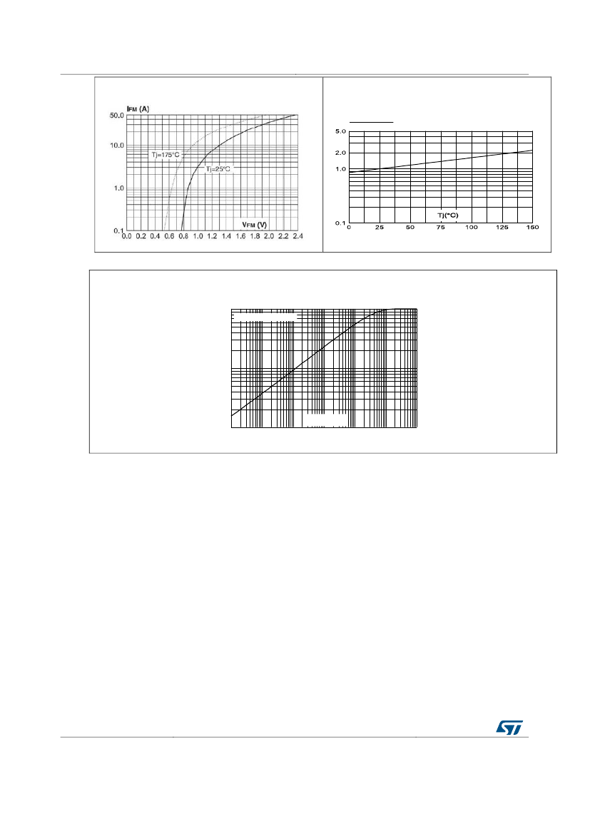

Figure 7: Peak forward voltage drop versus peak
forward current (typical values)
SMLVT3V3
Figure 8: Transient thermal impedance, junction to
ambient, versus pulse duration (PCB - FR4)
IR(Tj)
IR(Tj = 25 °C)
Figure 9: Relative variation of leakage current versus junction temperature
Z
th(j-a)
/ R
th(j-a)
Recommended pad layout
1.00
0.10
0.01
1.0E-03
(µs)
1.0E-02
1.0E-01
1.0E+00
1.0E+01
1.0E+02
1.0E+03
