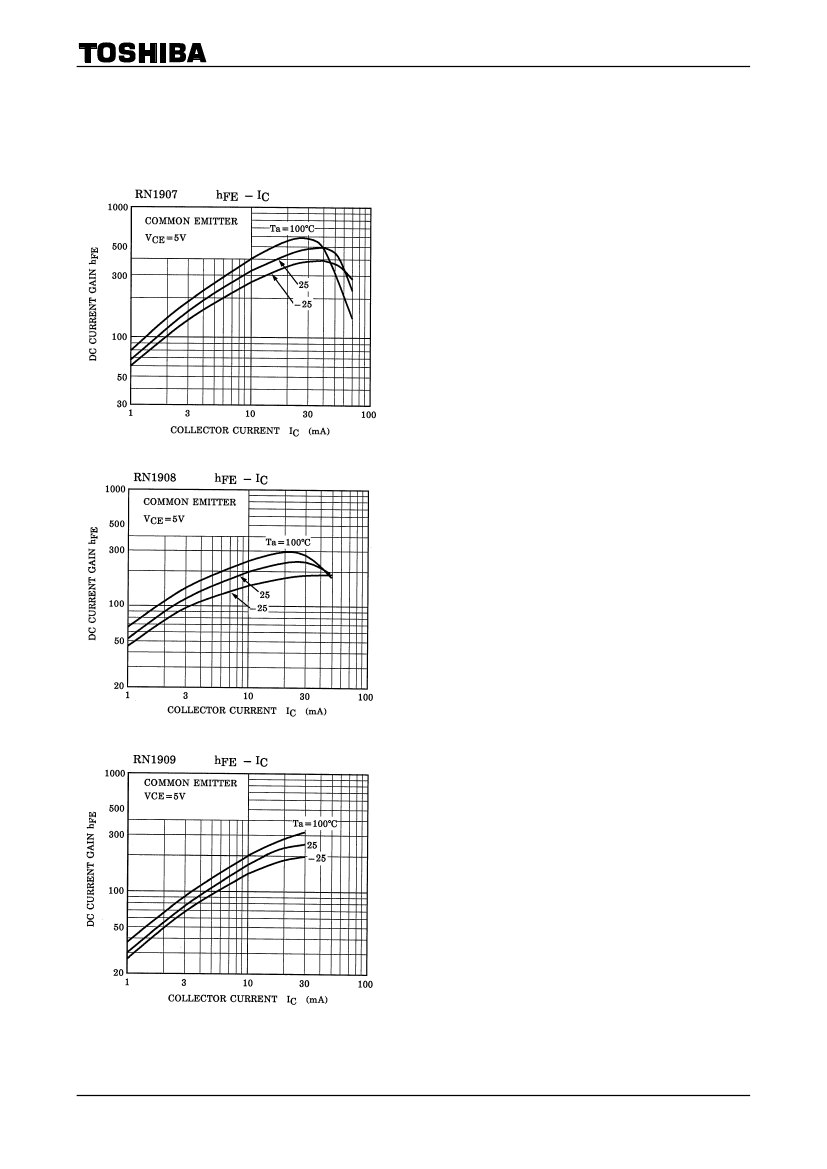

RN1907~RN1909
TOSHIBA Transistor
Silicon NPN Epitaxial Type (PCT Process) (Bias Resistor built-in Transistor)
RN1907, RN1908, RN1909
Switching, Inverter Circuit, Interface Circuit
and Driver Circuit Applications
Including two devices in US6 (ultra super mini type with 6 leads)
With built-in bias resistors
Simplify circuit design
Reduce a quantity of parts and manufacturing process
Complementary to RN2907 to RN2909

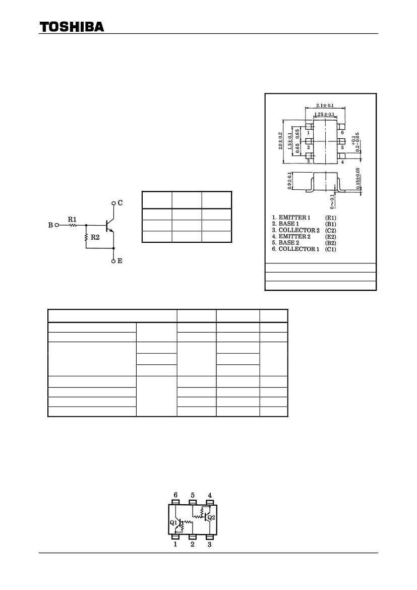

Unit: mm
Equivalent Circuit and Bias Resistor Values
Type No.
RN1907
RN1908
RN1909
R1 (kΩ)
22
47
R2 (kΩ)
47
47
22
Absolute Maximum Ratings
(Ta = 25°C) (Q1, Q2 Common)
Characteristic
Collector-base voltage
Collector-emitter voltage
RN1907 to
1909
RN1907
Emitter-base voltage
RN1908
RN1909
Collector current
Collector power dissipation
Junction temperature
Storage temperature range
RN1907 to
1909
j
stg
EBO
CBO
CEO
Rating
−55
to 150
US6
JEDEC
JEITA
TOSHIBA
2-2J1A
Weight: 6.8mg(typ.)
mW
Note: Using continuously under heavy loads (e.g. the application of high temperature/current/voltage and the
significant change in temperature, etc.) may cause this product to decrease in the reliability significantly even
if the operating conditions (i.e. operating temperature/current/voltage, etc.) are within the absolute maximum
ratings.
Please design the appropriate reliability upon reviewing the Toshiba Semiconductor Reliability Handbook
(“Handling Precautions”/“Derating Concept and Methods”) and individual reliability data (i.e. reliability test
report and estimated failure rate, etc).
*: Total rating
Equivalent Circuit
(Top View)
