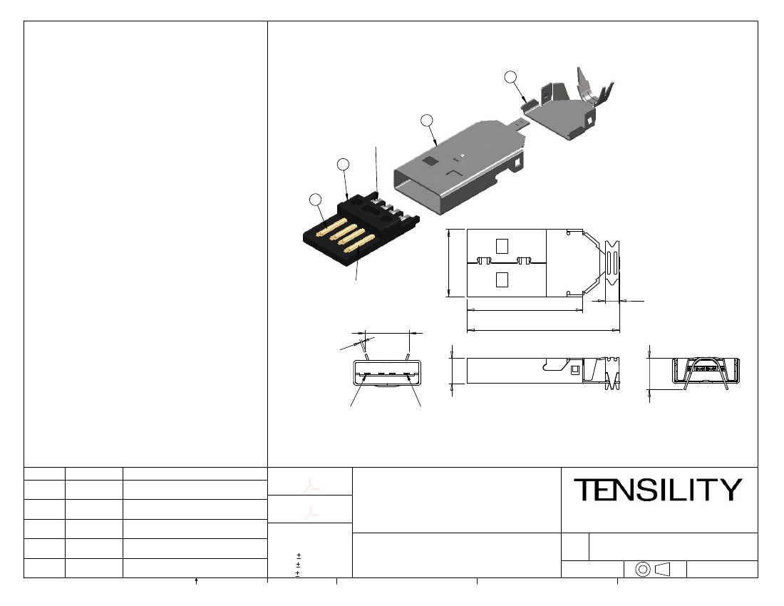

Materials
1. Shell, steel, nickel plated
2. Pins, brass, 5
μ"
gold and tin plating
3. Insulator, PBT, black
Electrical
Rated voltage: 30 Vdc
Rated current: 3 A
Dielectric strength: 1 min @ 500 Vac
Insulation resistance: 500 MΩ @ 500 Vdc
Contact resistance: 50 mΩ or less
Mechanical
Insertion force: 3.5 kgf maximum
Withdrawal force: 1.0 kgf minimum
Durability: 1500 cycle minimum life; less than 100 mΩ
contact resistance, minimum 100 MΩ insulation
resistance
Terminal strength: 0.3 kgf in any direction without
damage or looseness
Soldering
Solderability: 75% minimum coverage when terminals
dipped 2 mm in 245 ±5 °C solder bath for 3 ±0.5
seconds
Solder bath durability: no deformation when immersed
in 255 ±5 °C up to surface of the board for 5 seconds
or less
Solder iron durability: no deformation when exposed to
350 ±10 °C for 3 ±0.5 seconds
Environmental
Cold test: -40 ±3 °C for 48 hours without deformation
Heat test: 85 ±2 °C for 48 hours without deformation
Humidity test: 40 ±2 °C and humidity between 90 and
98 % for 48 hours without deformation
Operating range
-40 ~ 85 °C
tin plating
USB A 2.0 plug molding style
gold plating
20.5
8 ±0.20
0 .3
2.5
27.2
Pin 4
Pin 1
Revision:
A1
Date:
12/15/2015
07/27/2018
Description:
Initial release
Corrected operating temp range
Prepared:
GL
RS
Notes:
Digitally signed by GL
Date: 2018.08.06
09:13:03 -07'00'
RoHS and REACH compliant
Function test: no open, no short circuit, no
intermittent
Description:
Connector, USB A plug, molding style, nickel shell,
shielded, black insulator
tel
fax
Verified:
Digitally signed by RS
Date: 2018.08.08
16:41:35 -07'00'
Dimensions are in
millimeters.
Tolerances:
X:
0.5 mm
X.X:
0.3 mm
X.XX: 0.05 mm
1.541.323.3228
1.541.323.4202
Part number:
5.8 ±0.20
4.5
800
web
877.670.7118
tensility.com
Size:
Scale:
50-00466
2:1
Sheet 1 of 1
