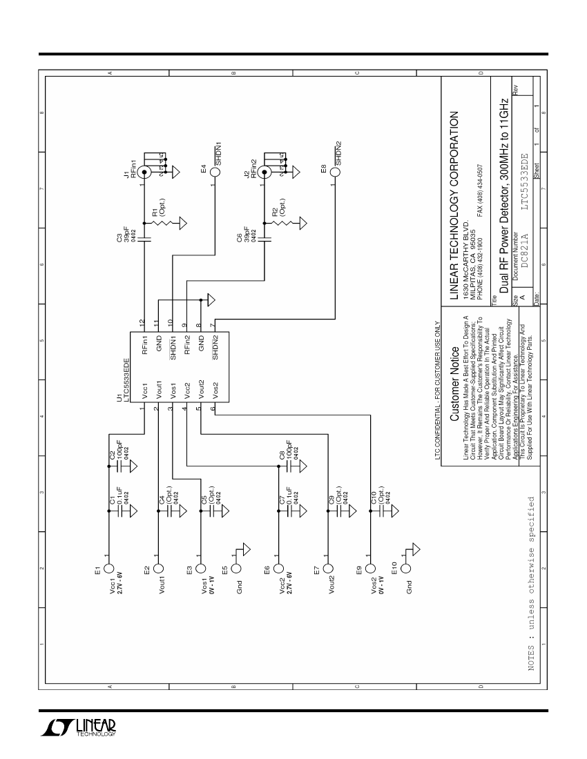

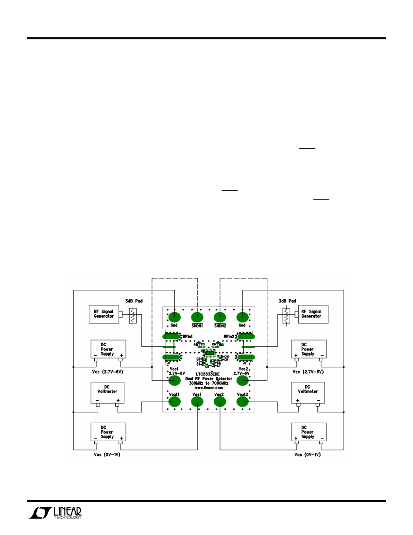

QUICK START GUIDE FOR DEMONSTRATION CIRCUIT 821
300MHZ TO 11GHZ PRECISION DUAL RF POWER DETECTOR
LTC5533
DESCRIPTION
Demonstration circuit 821 is a precision dual RF
power detector featuring the LTC
5533.
The LTC5533 is a dual channel RF power detector for
RF applications operating in the 300MHz to 11GHz
range. Two independent temperature compensated
Schottky diode peak detectors and buffer amplifiers
are combined in a small 4mm x 3mm DFN package.
The RF input voltage is peak detected using on-chip
Schottky diodes. The detected voltage is buffered
and supplied to the V
OUT
pins. A power saving shut-
down mode reduces current to less than
2µA/channel. The initial output starting voltages of
130mV±35mV can be precisely adjusted using the
OS
pins.
The LTC5533 operates with input power levels from
-32dBm to 12dBm.
Design files for this circuit board are available. Call
the LTC factory.
LTC is a trademark of Linear Technology Corporation
Table 1. Typical Performance Summary (V
CC
