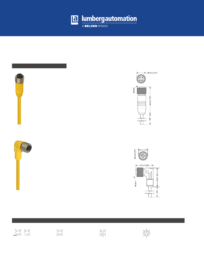

M12-Round-Plug Connector, Single-Ended Cordsets,
According to IEC 61076-2-101
RKT | RKWT
3-, 4-, 5-, and 8-Poles
Actuator/sensor cordset, single-ended, M12,
3-, 4-, 5-, and 8-poles, female straight connec-
tor with self-locking thread and
molded cable.
— RKT 8-627 has black cable
and overmold —
RKT
3-, 4-, 5-, and 8-poles, female 90° connector
with self-locking thread and molded cable.
— RKWT 8-627 has black cable
and overmold —
RKWT
Pin Assignments
M12 - Female
3 poles
1=
2=
3=
4=
brown
n.c.
blue
black
4 poles
1=
2=
3=
4=
brown
white
blue
black
5 poles
1=
2=
3=
4=
5=
brown
white
blue
black
grey
8 poles
1=
2=
3=
4=
5=
6=
7=
8=
white
brown
green
yellow
grey
pink
blue
red
