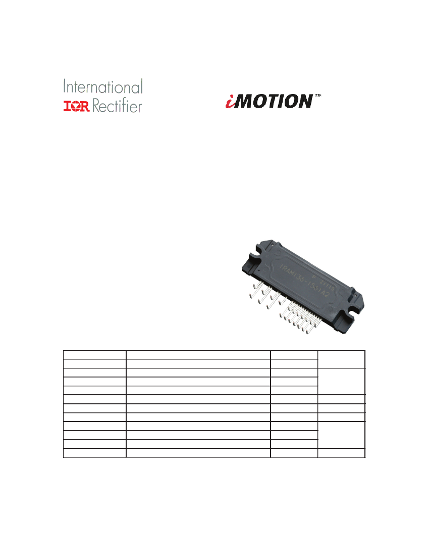

International Rectifier's IRAM136-1561A is a 15A, 600V Integrated Power Hybrid IC with Open Emitter pins
for advanced Appliance Motor Drives applications such as energy efficient Washing Machine and Refrigerator
Compressor Drivers. IR's technology offers an extremely compact, high performance AC motor-driver in a
single isolated package to simplify design.
This advanced HIC is a combination of IR's low V
CE (on)
Trench IGBT technology and the industry benchmark
3 phase high voltage, high speed driver (3.3V compatible) in a fully isolated thermally enhanced package. A
built-in high precision temperature monitor and over-current protection feature, along with the short-circuit
rated IGBTs and integrated under-voltage lockout function, deliver high level of protection and fail-safe
operation. Using a Single in line package with full transfer mold structure and CTI>600 minimizes PCB space
and resolves isolation problems to heatsink.
