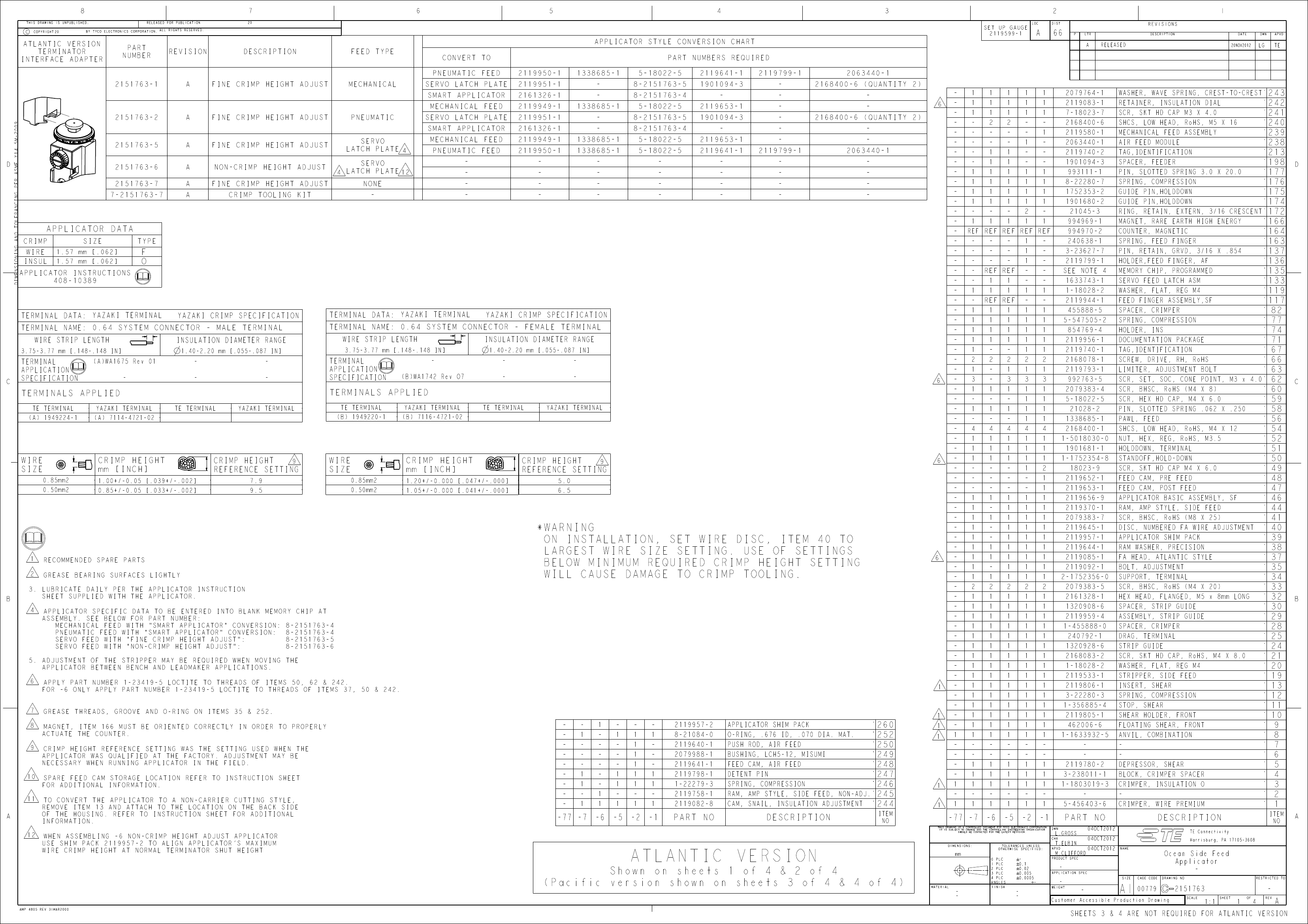

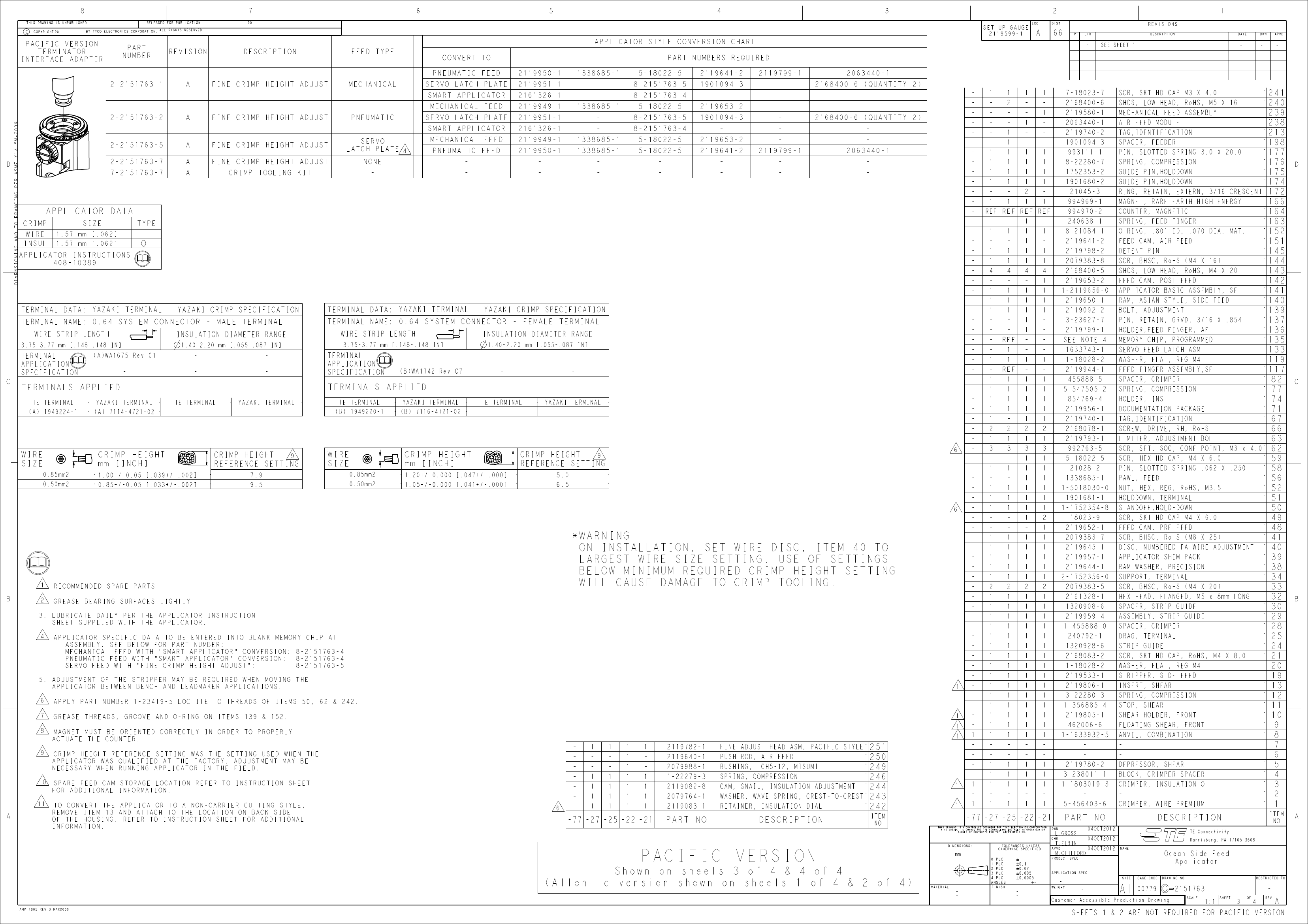

THIS DRAWING IS UNPUBLISHED.
RELEASED FOR PUBLICATION
BY TYCO ELECTRONICS CORPORATION.
ALL RIGHTS RESERVED.
SET UP GAUGE
2119599-1
LOC
DIST
LTR
REVISIONS
DESCRIPTION
DATE
DWN
APVD
COPYRIGHT
ATLANTIC VERSION
TERMINATOR
INTERFACE ADAPTER
PART
NUMBER
REVISION
DESCRIPTION
FEED TYPE
APPLICATOR STYLE CONVERSION CHART
CONVERT TO
SERVO LATCH PLATE
SMART APPLICATOR
MECHANICAL FEED
PNEUMATIC FEED
2119950-1
2161326-1
2119951-1
2119949-1
2161326-1
2119949-1
2119951-1
1338685-1
PART NUMBERS REQUIRED
8- 2151763 -5
5-18022-5
5-18022-5
1901094-3
2119653-1
1901094-3
2119653-1
2119641-1
2119641-1
2119799-1
2168400-6
2063440-1
(QUANTITY 2)
2151763 -1
FINE CRIMP HEIGHT ADJUST
MECHANICAL
2151763 -2
2151763 -5
NON-CRIMP HEIGHT ADJUST
CRIMP TOOLING KIT
PNEUMATIC
SERVO
LATCH PLATE
SERVO
LATCH PLATE
NONE
SERVO LATCH PLATE
SMART APPLICATOR
MECHANICAL FEED
PNEUMATIC FEED
1338685-1
8- 2151763 -4
8- 2151763 -5
5-18022-5
REF
2119950-1
1338685-1
1338685-1
8- 2151763 -4
5-18022-5
2168400-6
(QUANTITY 2)
2119799-1
2063440-1
2151763 -6
7- 2151763 -7
2151763 -7
CRIMP
WIRE
INSUL
APPLICATOR DATA
1.57 mm [.062]
1.57 mm [.062]
SIZE
TYPE
REF REF REF REF
APPLICATOR INSTRUCTIONS
408-10389
O
REF REF
TERMINAL DATA:
YAZAKI TERMINAL
TERMINAL NAME:
0.64 SYSTEM CONNECTOR - MALE TERMINAL
YAZAKI CRIMP SPECIFICATION
TERMINAL DATA:
TERMINAL NAME:
YAZAKI TERMINAL
0.64 SYSTEM CONNECTOR - FEMALE TERMINAL
REF REF
3.75-3.77 mm [.148-.148 IN]
WIRE STRIP LENGTH
INSULATION DIAMETER RANGE
1.40-2.20 mm [.055-.087 IN]
WIRE STRIP LENGTH
TERMINAL
APPLICATION
SPECIFICATION
TERMINAL
APPLICATION
SPECIFICATION
(A)WA1675 Rev 01
(B)WA1742 Rev O7
TERMINALS APPLIED
TE TERMINAL
(A) 1949224-1
C1__DWG_PN_1_0
C1__DWG_PN_1_1
TERMINALS APPLIED
C1__DWG_PN_2_0
YAZAKI TERMINAL
(A) 7114-4721-02
TE TERMINAL
C1__DWG_PN_3_0
YAZAKI TERMINAL
C1__DWG_PN_4_0
C1__DWG_PN_2_1
(B) 1949220-1
TE TERMINAL
C2__DWG_PN_1_0
C2__DWG_PN_1_1
(B) 7116-4721-02
YAZAKI TERMINAL
C2__DWG_PN_2_0
TE TERMINAL
C2__DWG_PN_3_0
YAZAKI TERMINAL
C2__DWG_PN_4_0
C2__DWG_PN_2_1
WIRE
SIZE
0.85mm2
0.50mm2
CRIMP HEIGHT
mm [INCH]
W1__DWG_WGAUGE_1
W1__DWG_WGAUGE_2
1.00+/-0.05 [.039+/-.002]
0.85+/-0.05 [.033+/-.002]
CRIMP HEIGHT
REFERENCE SETTING
W1__DWG_CRIMP_HT_1
7.9
9.5
WIRE
SIZE
W1__FA_SETTING_1
W1__FA_SETTING_2
0.85mm2
0.50mm2
CRIMP HEIGHT
mm [INCH]
W2__DWG_WGAUGE_1
W2__DWG_WGAUGE_2
1.20+/-0.000 [.047+/-.000]
1.05+/-0.000 [.041+/-.000]
CRIMP HEIGHT
REFERENCE SETTING
W2__DWG_CRIMP_HT_1
W2__FA_SETTING_1
5.0
6.5
W1__DWG_CRIMP_HT_2
W2__FA_SETTING_2
W2__DWG_CRIMP_HT_2
*WARNING
ON INSTALLATION, SET WIRE DISC, ITEM 40 TO
LARGEST WIRE SIZE SETTING. USE OF SETTINGS
BELOW MINIMUM REQUIRED CRIMP HEIGHT SETTING
WILL CAUSE DAMAGE TO CRIMP TOOLING.
2119957-2
8-21084-0
2119640-1
2079988-1
2119641-1
2119798-1
1-22279-3
2119758-1
2119082-8
APPLICATOR SHIM PACK
O-RING, .676 ID, .070 DIA. MAT.
PUSH ROD, AIR FEED
BUSHING, LCH5-12, MISUMI
FEED CAM, AIR FEED
DETENT PIN
SPRING, COMPRESSION
RAM, AMP STYLE, SIDE FEED, NON-ADJ.
CAM, SNAIL, INSULATION ADJUSTMENT
2119957-2
8-21084-0_GATD
2119640-1
2079988_GATD
2119641-1
2119798-1
1-22279-3_SIMP
2119758
2119082-8
-77 -7
-6
-5
-2
-1
PART NO
DESCRIPTION
260
252
250
249
248
247
246
245
244
ITEM
NO
2079764-1
2119083-1
7-18023-7
2168400-6
2119580-1
2063440-1
2119740-2
1901094-3
993111-1
8-22280-7
1752353-2
1901680-2
21045-3
994969-1
994970-2
240638-1
3-23627-7
2119799-1
SEE NOTE 4
1633743-1
1-18028-2
2119944-1
455888-5
5-547505-2
854769-4
2119956-1
2119740-1
2168078-1
2119793-1
992763-5
2079383-4
5-18022-5
21028-2
1338685-1
2168400-1
1-5018030-0
1901681-1
1-1752354-8
18023-9
2119652-1
2119653-1
2119656-9
2119370-1
2079383-7
2119645-1
2119957-1
2119644-1
2119085-1
2119092-1
2-1752356-0
2079383-5
2161328-1
1320908-6
2119959-4
1-455888-0
240792-1
1320928-6
2168083-2
1-18028-2
2119533-1
2119806-1
3-22280-3
1-356885-4
2119805-1
462006-6
1-1633932-5
2119780-2
3-238011-1
1-1803019-3
5-456403-6
WASHER, WAVE SPRING, CREST-TO-CREST
RETAINER, INSULATION DIAL
SCR, SKT HD CAP M3 X 4.0
SHCS, LOW HEAD, RoHS, M5 X 16
MECHANICAL FEED ASSEMBLY
AIR FEED MODULE
TAG,IDENTIFICATION
SPACER, FEEDER
PIN, SLOTTED SPRING 3.0 X 20.0
SPRING, COMPRESSION
GUIDE PIN,HOLDDOWN
GUIDE PIN,HOLDDOWN
RING, RETAIN, EXTERN, 3/16 CRESCENT
MAGNET, RARE EARTH HIGH ENERGY
COUNTER, MAGNETIC
SPRING, FEED FINGER
PIN, RETAIN, GRVD, 3/16 X .854
HOLDER,FEED FINGER, AF
MEMORY CHIP, PROGRAMMED
SERVO FEED LATCH ASM
WASHER, FLAT, REG M4
FEED FINGER ASSEMBLY,SF
SPACER, CRIMPER
SPRING, COMPRESSION
HOLDER, INS
DOCUMENTATION PACKAGE
TAG,IDENTIFICATION
SCREW, DRIVE, RH, RoHS
LIMITER, ADJUSTMENT BOLT
SCR, SET, SOC, CONE POINT, M3 x 4.0
SCR, BHSC, RoHS (M4 X 8)
SCR, HEX HD CAP, M4 X 6.0
PIN, SLOTTED SPRING .062 X .250
PAWL, FEED
SHCS, LOW HEAD, RoHS, M4 X 12
NUT, HEX, REG, RoHS, M3.5
HOLDDOWN, TERMINAL
STANDOFF,HOLD-DOWN
SCR, SKT HD CAP M4 X 6.0
FEED CAM, PRE FEED
FEED CAM, POST FEED
APPLICATOR BASIC ASSEMBLY, SF
SCR, BHSC, RoHS (M8 X 25)
DISC, NUMBERED FA WIRE ADJUSTMENT
RAM WASHER, PRECISION
FA HEAD, ATLANTIC STYLE
BOLT, ADJUSTMENT
SUPPORT, TERMINAL
SCR, BHSC, RoHS (M4 X 20)
HEX HEAD, FLANGED, M5 x 8mm LONG
SPACER, STRIP GUIDE
ASSEMBLY, STRIP GUIDE
SPACER, CRIMPER
DRAG, TERMINAL
STRIP GUIDE
SCR, SKT HD CAP, RoHS, M4 X 8.0
STRIPPER, SIDE FEED
INSERT, SHEAR
SPRING, COMPRESSION
STOP, SHEAR
SHEAR HOLDER, FRONT
FLOATING SHEAR, FRONT
ANVIL, COMBINATION
DEPRESSOR, SHEAR
BLOCK, CRIMPER SPACER
CRIMPER, INSULATION O
CRIMPER, WIRE PREMIUM
2079764
2119083
7-18023-7
2168400-6
2119580-1
2063440-1
2119740-2
1901094-3
993111-1
8-22280-7_SIMP
1752353-2
1901680-2
21045-3
994969-1_GATD
COUNTER_994970
240638
3-23627-7
2119799
1901689_EMPTY_OCEAN_SF
1633743-1
1-18028-2
2119944-1
455888-5
SIMP_5-547505-2
854769-4
2119956-1
2119740-1
2168078-1
2119793
992763-5
2079383-4
5-18022-5
21028-2
1338685-1
2168400-1
1-5018030-0
1901681-1
1-1752354-8
18023-9
2119652
2119653
2119656-9
2119370
2079383-7
2119645
2119957-1
2119644-1
2119085
2119092-1
2-1752356-0
2079383-5
2161328
1320908-6
2119959-4
1-455888-0
240792-1
1320928-6
2168083-2
1-18028-2
2119533
2119806
SIMP_3-22280-3
1-356885-4
2119805-1
462006-6
1-1633932-5
ITEM_7
ITEM_6
2119780-2
3-238011-1
1-1803019-3
ITEM_2
5-456403-6
-77 -7
DIMENSIONS:
-6
-5
-2
-1
DWN
CHK
PART NO
DESCRIPTION
243
242
241
240
239
238
213
198
177
176
175
174
172
166
164
163
137
136
135
133
119
117
82
77
74
71
67
66
63
62
59
58
56
54
52
51
49
48
47
46
44
41
39
38
37
35
34
33
32
29
28
24
21
19
ITEM
NO
THIS DRAWING IS A CONTROLLED DOCUMENT FOR TYCO ELECTRONICS CORPORATION
IT IS SUBJECT TO CHANGE AND THE CONTROLLING ENGINEERING ORGANIZATION
SHOULD BE CONTACTED FOR THE LATEST REVISION.
Shown on sheets 1 of 4
& 2 of 4
(Pacific version shown on sheets 3 of 4
AMP 4805 REV 31MAR2000
ATLANTIC VERSION
TOLERANCES UNLESS
OTHERWISE SPECIFIED:
APVD
PRODUCT SPEC
NAME
& 4 of 4)
MATERIAL
0 PLC
1 PLC
2 PLC
3 PLC
4 PLC
ANGLES
FINISH
APPLICATION SPEC
WEIGHT
A1
SHEETS 3
SIZE
CAGE CODE
DRAWING NO
RESTRICTED TO
00779
SCALE
SHEET
OF
REV
& 4 ARE NOT REQUIRED FOR ATLANTIC VERSION

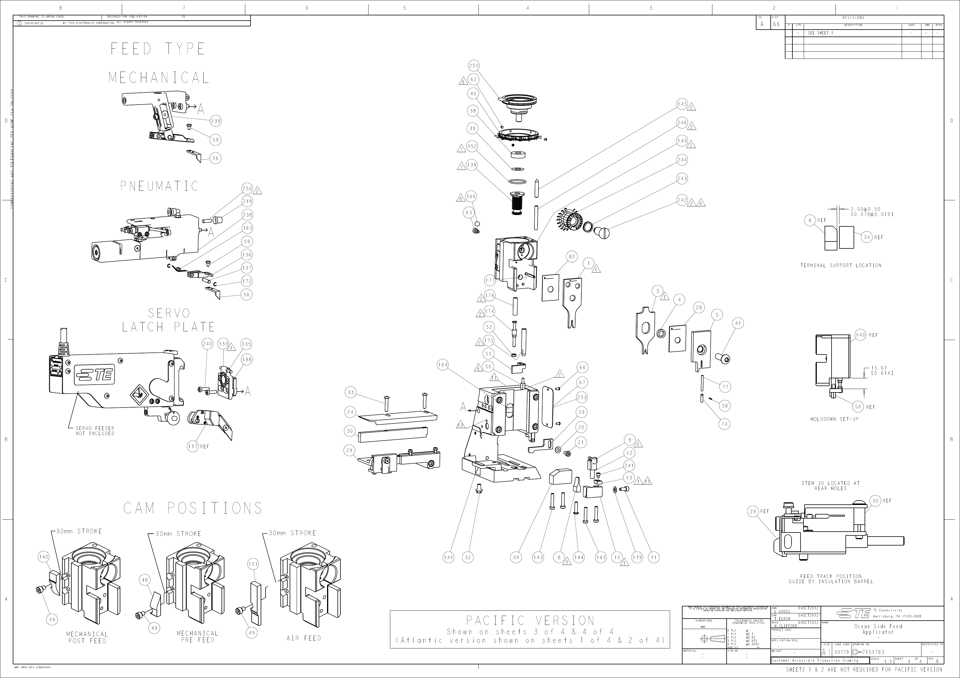

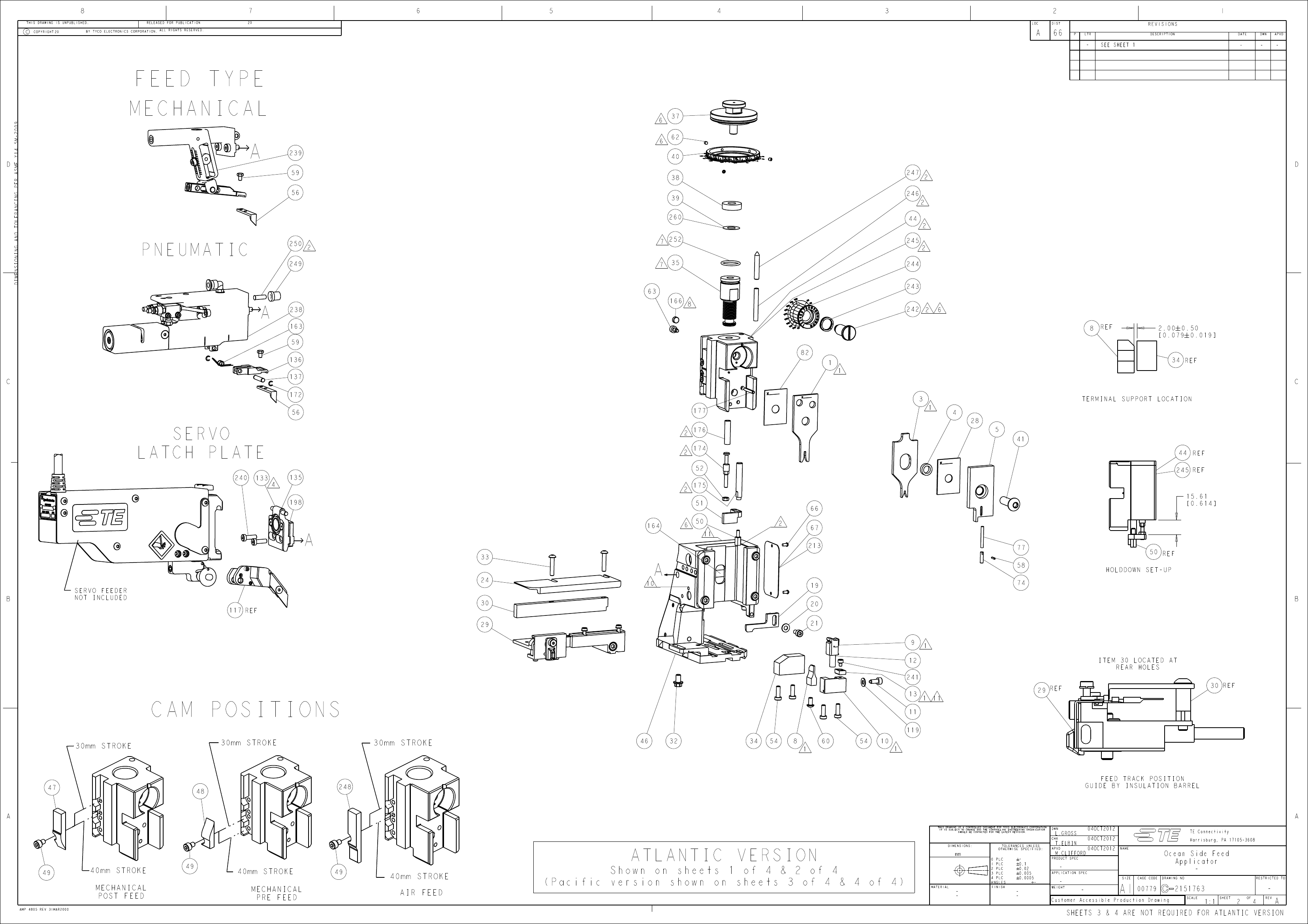

FEED TYPE
37
62
239
38
39
260
252
35
247
246
44
245
244
243
166
242
82
REF
2.00 0.50
[ 0.079
0.019 ]
34 REF
59
56
250
249
63
238
163
59
136
137
172
56
177
176
174
52
175
51
164
66
67
213
33
24
77
58
19
21
241
ITEM 30 LOCATED AT
REAR HOLES
29 REF
30 REF
74
50 REF
HOLDDOWN SET-UP
15.61
[ 0.614 ]
28
TERMINAL SUPPORT LOCATION
41
44
REF
240
133
135
198
245 REF
117 REF
29
CAM POSITIONS
46
32
34
54
54
119
47
48
248
FEED TRACK POSITION
GUIDE BY
INSULATION BARREL
DWN
CHK
49
49
49
& 2 of 4
ATLANTIC VERSION
DIMENSIONS:
TOLERANCES UNLESS
APVD
PRODUCT SPEC
NAME
& 4 of 4)
MATERIAL
0 PLC
1 PLC
2 PLC
3 PLC
4 PLC
ANGLES
FINISH
APPLICATION SPEC
WEIGHT
A1
SHEETS 3
SIZE
CAGE CODE
DRAWING NO
RESTRICTED TO
00779
SCALE
SHEET
OF
REV
SET UP GAUGE
2119599-1
LOC
DIST
LTR
REVISIONS
DESCRIPTION
DATE
DWN
APVD
COPYRIGHT
PACIFIC VERSION
TERMINATOR
INTERFACE ADAPTER
PART
NUMBER
REVISION
DESCRIPTION
FEED TYPE
CONVERT TO
SERVO LATCH PLATE
SMART APPLICATOR
MECHANICAL FEED
PNEUMATIC FEED
2119951-1
2119949-1
2119951-1
2161326-1
2119950-1
1338685-1
8- 2151763 -5
5-18022-5
5-18022-5
1901094-3
2119641-2
2119799-1
2168400-6
2063440-1
(QUANTITY 2)
2- 2151763 -1
MECHANICAL
2- 2151763 -2
2- 2151763 -5
CRIMP TOOLING KIT
PNEUMATIC
SERVO
LATCH PLATE
NONE
SERVO LATCH PLATE
SMART APPLICATOR
MECHANICAL FEED
PNEUMATIC FEED
1338685-1
8- 2151763 -4
8- 2151763 -5
5-18022-5
5-18022-5
REF
REF
2119653-2
1901094-3
2119653-2
2119641-2
2161326-1
2119949-1
2119950-1
1338685-1
1338685-1
8- 2151763 -4
2168400-6
(QUANTITY 2)
2- 2151763 -7
2119799-1
2063440-1
7- 2151763 -7
CRIMP
WIRE
INSUL
APPLICATOR DATA
1.57 mm [.062]
1.57 mm [.062]
REF REF REF
SIZE
TYPE
408-10389
O
TERMINAL DATA:
YAZAKI TERMINAL
TERMINAL NAME:
TERMINAL DATA:
TERMINAL NAME:
YAZAKI TERMINAL
WIRE STRIP LENGTH
WIRE STRIP LENGTH
TERMINAL
APPLICATION
SPECIFICATION
TERMINAL
APPLICATION
SPECIFICATION
(A)WA1675 Rev 01
(B)WA1742 Rev O7
REF
TERMINALS APPLIED
(A) 1949224-1
TE TERMINAL
C1__DWG_PN_1_0
C1__DWG_PN_1_1
TERMINALS APPLIED
C1__DWG_PN_2_0
(A) 7114-4721-02
YAZAKI TERMINAL
TE TERMINAL
C1__DWG_PN_3_0
YAZAKI TERMINAL
C1__DWG_PN_4_0
C1__DWG_PN_2_1
TE TERMINAL
(B) 1949220-1
C2__DWG_PN_1_0
C2__DWG_PN_1_1
YAZAKI TERMINAL
(B) 7116-4721-02
C2__DWG_PN_2_0
TE TERMINAL
C2__DWG_PN_3_0
YAZAKI TERMINAL
C2__DWG_PN_4_0
C2__DWG_PN_2_1
WIRE
SIZE
0.85mm2
0.50mm2
W1__DWG_WGAUGE_1
CRIMP HEIGHT
mm [INCH]
CRIMP HEIGHT
REFERENCE SETTING
W1__DWG_CRIMP_HT_1
7.9
9.5
WIRE
SIZE
W1__FA_SETTING_1
W1__FA_SETTING_2
0.85mm2
0.50mm2
CRIMP HEIGHT
mm [INCH]
W2__DWG_WGAUGE_1
W2__DWG_WGAUGE_2
CRIMP HEIGHT
REFERENCE SETTING
W2__DWG_CRIMP_HT_1
5.0
6.5
W2__FA_SETTING_1
W2__DWG_CRIMP_HT_2
W2__FA_SETTING_2
W1__DWG_WGAUGE_2
W1__DWG_CRIMP_HT_2
*WARNING
2119782-1
2119640-1
2079988-1
1-22279-3
2119082-8
2079764-1
2119083-1
FINE ADJUST HEAD ASM, PACIFIC STYLE
PUSH ROD, AIR FEED
SPRING, COMPRESSION
2119782
2119640-1
2079988_GATD
1-22279-3_SIMP
2119082-8
2079764
2119083
-77 -27 -25 -22 -21
PART NO
DESCRIPTION
251
250
249
246
244
243
242
ITEM
NO
7-18023-7
2168400-6
2119580-1
2063440-1
2119740-2
1901094-3
993111-1
8-22280-7
1752353-2
1901680-2
21045-3
994969-1
994970-2
240638-1
8-21084-1
2119641-2
2119798-2
2079383-8
2168400-5
2119653-2
1-2119656-0
2119650-1
2119092-2
3-23627-7
2119799-1
SEE NOTE 4
1633743-1
1-18028-2
2119944-1
455888-5
5-547505-2
854769-4
2119956-1
2119740-1
2168078-1
2119793-1
992763-5
5-18022-5
21028-2
1338685-1
1-5018030-0
1901681-1
1-1752354-8
18023-9
2119652-1
2079383-7
2119645-1
2119957-1
2119644-1
2-1752356-0
2079383-5
2161328-1
1320908-6
2119959-4
1-455888-0
240792-1
1320928-6
2168083-2
1-18028-2
2119533-1
2119806-1
3-22280-3
1-356885-4
2119805-1
462006-6
1-1633932-5
2119780-2
3-238011-1
1-1803019-3
5-456403-6
AIR FEED MODULE
TAG,IDENTIFICATION
SPACER, FEEDER
SPRING, COMPRESSION
GUIDE PIN,HOLDDOWN
GUIDE PIN,HOLDDOWN
COUNTER, MAGNETIC
SPRING, FEED FINGER
O-RING, .801 ID, .070 DIA. MAT.
FEED CAM, AIR FEED
DETENT PIN
SCR, BHSC, RoHS (M4 X 16)
SHCS, LOW HEAD, RoHS, M4 X 20
FEED CAM, POST FEED
RAM, ASIAN STYLE, SIDE FEED
BOLT, ADJUSTMENT
SPACER, CRIMPER
SPRING, COMPRESSION
HOLDER, INS
TAG,IDENTIFICATION
PAWL, FEED
HOLDDOWN, TERMINAL
STANDOFF,HOLD-DOWN
FEED CAM, PRE FEED
SUPPORT, TERMINAL
SPACER, STRIP GUIDE
SPACER, CRIMPER
DRAG, TERMINAL
STRIP GUIDE
STRIPPER, SIDE FEED
INSERT, SHEAR
SPRING, COMPRESSION
STOP, SHEAR
SHEAR HOLDER, FRONT
ANVIL, COMBINATION
DEPRESSOR, SHEAR
7-18023-7
2168400-6
2119580-1
2063440-1
2119740-2
1901094-3
993111-1
8-22280-7_SIMP
1752353-2
1901680-2
21045-3
994969-1_GATD
COUNTER_994970
240638
8-21084-1_GATD
2119641-2
2119798-2
2079383-8
2168400-5
2119653-2
1-2119656-0
2119650
2119092-2
3-23627-7
2119799
1633743-1
1-18028-2
2119944-1
455888-5
SIMP_5-547505-2
854769-4
2119956-1
2119740-1
2168078-1
2119793
992763-5
5-18022-5
21028-2
1338685-1
1-5018030-0
1901681-1
1-1752354-8
18023-9
2119652
2079383-7
2119645
2119957-1
2119644-1
2-1752356-0
2079383-5
2161328
1320908-6
2119959-4
1-455888-0
240792-1
1320928-6
2168083-2
1-18028-2
2119533
2119806
SIMP_3-22280-3
1-356885-4
2119805-1
462006-6
1-1633932-5
ITEM_7
ITEM_6
2119780-2
3-238011-1
1-1803019-3
ITEM_2
5-456403-6
-77 -27 -25 -22 -21
PART NO
DWN
CHK
DESCRIPTION
241
240
239
238
213
198
177
176
175
174
172
166
164
163
152
151
145
144
143
142
141
140
139
137
136
135
133
119
117
82
77
74
71
67
66
63
62
59
58
56
52
51
49
48
41
39
38
34
33
32
29
28
24
21
19
ITEM
NO
Shown on sheets 3 of 4
& 4 of 4
(Atlantic version shown on sheets 1 of 4
PACIFIC VERSION
DIMENSIONS:
TOLERANCES UNLESS
APVD
PRODUCT SPEC
NAME
& 2 of 4)
MATERIAL
0 PLC
1 PLC
2 PLC
3 PLC
4 PLC
ANGLES
FINISH
APPLICATION SPEC
WEIGHT
A1
SHEETS 1
SIZE
CAGE CODE
DRAWING NO
RESTRICTED TO
00779
SCALE
SHEET
OF
REV
& 2 ARE NOT REQUIRED FOR PACIFIC VERSION
LOC
DIST
LTR
REVISIONS
DESCRIPTION
DATE
DWN
APVD
COPYRIGHT
FEED TYPE
251
62
38
145
246
140
239
39
152
139
59
56
244
243
250
249
238
163
59
136
137
82
34
REF
166
63
REF
242
2.00 0.50
[ 0.079
0.019 ]
172
56
177
176
174
52
28
41
140
REF
240
133
135
198
175
51
164
66
67
33
213
19
21
29
241
ITEM 30 LOCATED AT
REAR HOLES
58
74
HOLDDOWN SET-UP
15.61
[ 0.614 ]
77
24
REF
117 REF
CAM POSITIONS
142
141
32
34
143
144
143
119
29
REF
REF
151
48
FEED TRACK POSITION
GUIDE BY
INSULATION BARREL
DWN
CHK
DIMENSIONS:
TOLERANCES UNLESS
APVD
PRODUCT SPEC
NAME
49
49
49
& 4 of 4
PACIFIC VERSION
& 2 of 4)
MATERIAL
0 PLC
1 PLC
2 PLC
3 PLC
4 PLC
ANGLES
FINISH
APPLICATION SPEC
WEIGHT
A1
SHEETS 1
SIZE
CAGE CODE
DRAWING NO
RESTRICTED TO
00779
SCALE
SHEET
OF
REV
