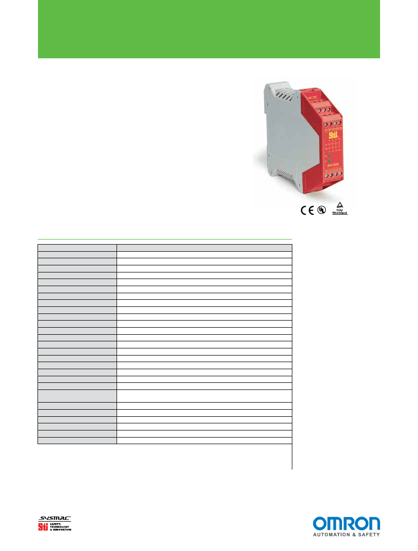

Safety Monitoring Relays
SR105E
Safety Expansion Unit
• Power requirements—the SR105E will accept 24 VAC/DC
• Outputs—the SR105E has 3 N/O outputs to route power to the coils of
power contactors plus 1 N/C auxiliary output for monitoring by the safety
monitoring relay
• Expander capability—the SR105E may be used with any other SR Series
relay to expand the total available number of N/O outputs to power
contactors
