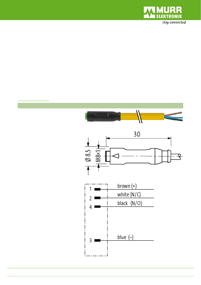

INT ERNET DAT A SHEET for Article Number 7000-08221-0510750
M8 f emale 0° snap-in wit h cable
PUR 4x0.25 ye UL/CSA+robot+drag chain 7,5m
Male straight
M8 (Snap In), 4-pole
with cable sleeves
Plastic housings with good resistance against chemicals and oils. The resistance to
aggressive media should be individually tested for your application. Further details on
request.
Link t o Product
Illustra tio n

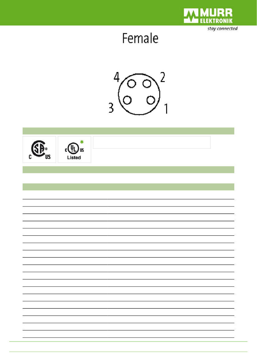

Appro va ls
* only for products with UL/CSA approved cable
