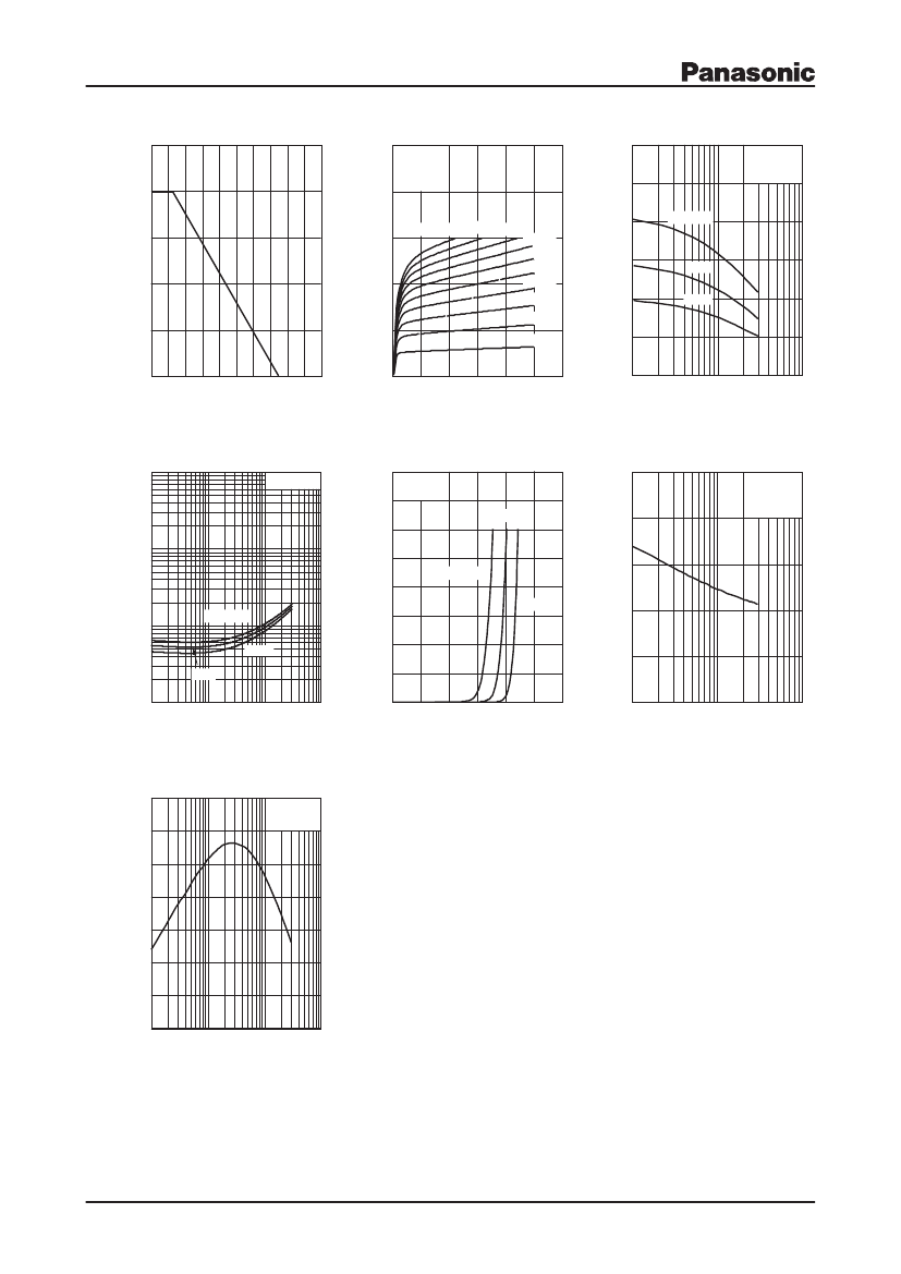

DSA2G01
Silicon PNP epitaxial planar type
For high-frequency amplification
High forward current transfer ratio h
FE
with excellent linearity
High transition frequency f
Contributes to miniaturization of sets, reduction of component count.
Eco-friendly Halogen-free package
Package
Code
Mini3-G3-B
Name
Pin
1. Base
2. Emitter
3. Collector
Packaging
Embossed type (Thermo-compression sealing): 3000 pcs / reel (standard)
Marking Symbol: A4
mW
Absolute Maximum Ratings
a
= 25°C
Collector-base voltage (Emitter open)
Collector-emitter voltage (Base open)
Emitter-base voltage (Collector open)
Collector current
Collector power dissipation
Junction temperature
Storage temperature
CBO
CEO
EBO
j
stg
Rating
–30
–20
–5
–30
–55 to +150
Electrical Characteristics
a
= 25°C±3°C
Base-emitter voltage
Collector-base cutoff current (Emitter open)
Collector-emitter cutoff current (Base open)
Emitter-base cutoff current (Collector open)
Forward current transfer ratio
Collector-emitter saturation voltage
Transition frequency
Reverse transfer capacitance
(Common emitter)
Noise figure
Reverse transfer impedance
BE
CBO
CEO
EBO
h
FE
CE(sat)
f
re
NF
Z
rb
Conditions
CE
= –10 V, I
= –1 mA
CB
= –10 V, I
= 0
CE
= –20 V, I
= 0
EB
= –5 V, I
= 0
CE
= –10 V, I
= –1 mA
= –10 mA, I
= –1 mA
CE
= –10 V, I
= –1 mA
CE
= –10 V, I
= –1 mA, f = 10.7 MHz
CE
= –10 V, I
= –1 mA, f = 5 MHz
CE
= –10 V, I
= –1 mA, f = 2 MHz
– 0.1
2.8
22
Min
Typ
– 0.7
– 0.1
–100
–10
220
Max
µA
µA
µA
MHz
pF
dB
Note) 1. Measuring methods are based on JAPANESE INDUSTRIAL STANDARD JIS C 7030 measuring methods for transistors.
2. *: Rank classification
Code
Rank
h
FE
Marking Symbol
70 to 140
A4B
110 to 220
A4C
No-rank
70 to 220
A4
Product of no-rank is not classified and have no marking symbol for rank.
Publication date: January 2011
Ver. BED
