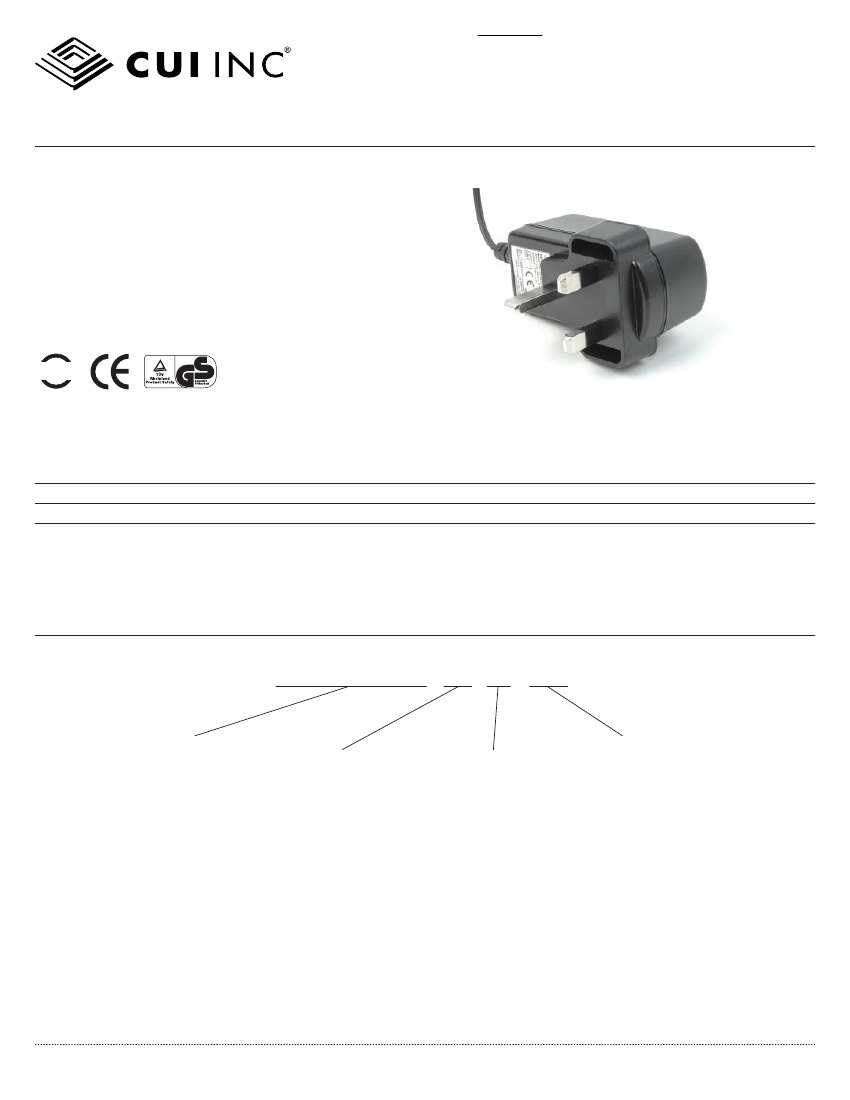

SERIES:
12 W WALL PLUG - UK BLADE
DESCRIPTION:
AC-DC POWER SUPPLY
• up to 12 W power
• universal input (90~264 Vac)
• single regulated output from 5~12 V
• over voltage, over current, and short circuit protections
• TUV safety approvals
• level V efficiency
• custom designs available
RoHS
output
voltage
(Vdc)
MODEL
EPSA050250UB
EPSA120100UB
Notes:
output
current
max
(A)
N
U
output
power
max
(W)
TI
2.5
Factory
Designation
cui.com
1. At full load, 100 ~ 240 Vac input, 20 MHz bandwidth oscilloscope, each output terminated with 10
μF
aluminum electrolytic and 0.1
μF
ceramic capacitors.
PART NUMBER KEY
IS
example of 5 Vdc, 2.5 A
Base Number
O
N
DC Plug Type
EPSA050250UB -
XX
- EJ -
CXX
Reserved for Custom
Configurations
ED
ripple
and noise
max
(mVp-p)
efficiency
level
120
