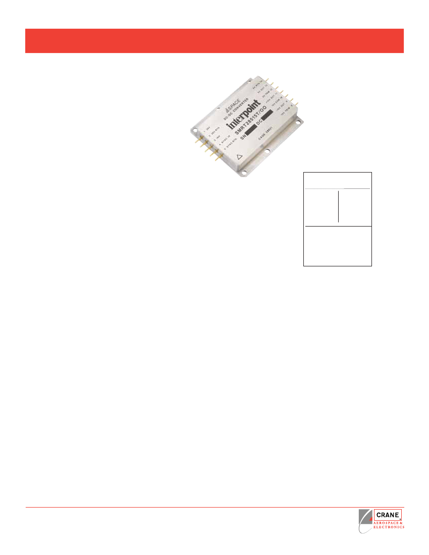

DESCRIPTION
The SMRT Series™ of DC/DC converters offers up to 35
watts of power in a radiation tolerant design. The low profile
SMRT converters are manufactured in Interpoint’s fully certified
and qualified MIL-STD-1772 production facility and packaged
in hermetically sealed steel cases. They are ideal for use in
programs requiring high reliability, small size, and high levels of
radiation hardening assurance.
The SMRT converters are switching regulators which use a two-
phase, phase shifted flyback design with a nominal switching
frequency of 300 kHz. Close regulation is maintained with
advanced constant frequency pulse width modulation design
techniques. The SMRT’s feed-forward compensation and
discontinuous topologies provide high levels (80 dB peak) of
input-to-output ripple rejection. A minimum load of 2% of full load
should be used on outputs at TID of 100k rads(Si) or greater to
ensure tight regulation over the full input range.
