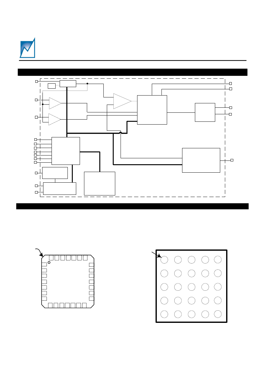

SIMPLIFIED APPLICATIONS DRAWING
12VIN (6V to 15V)
3.3/5Vin (2.7V to 5.5V)
12VIN
WP#
SDA
BUS
SCL
A2
A1
A0
VDD_CAP
VM
COMP1
OV
uP/
DSP/
FPGA/
ASIC
TRIM
VDD
TRIM_CAP
FILT_CAP
VIN
DC/DC
Converter
TRIM
ON/OFF
V+
V-
1.2 VIN
GND
SMM105
Internal or
External
Voltage
Reference
COMP2
VREF_CNTL
READY
START
GND
FAULT#
UV
FAULT#
READY
POWER GOOD
Figure 1 – Applications Schematic using the SMM105 Controller to actively control the DC output level
(ADOC) of a DC/DC Converter as well as margin control. The SMM105 can operate over a wide supply range
Note: This is an applications example only. Some pins, components and values are not shown.
