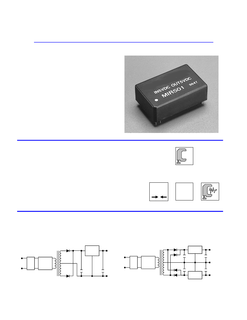

MIR500 Series
Single and Dual Outputs
Key Features
2 Watts High In/Out Isolation DIP DC/DC Converters
I/O Isolation 4000VAC
Low Isolation Capacitance
Low Leakage Current
Regulated Outputs
Short Circuit Protection
Low Cost
EMI Complies With EN55022 Class A
MTBF > 600,000 Hours
MIR500 2W DC/DC's are specially designed to
provide ultra-high levels of isolation 5600VDC in a
low-profile DIP package.
The series consists of 18 models with input voltages of
5V, 12V and 24V, and offers regulated output voltages of 5V,
12V, 15V in both single and dual output configurations.
The MIR500 series is an excellent selection for a wide
variety of applications including mixed analog/digital
subsystems, railroad/transportation equipments, medical
equipment subsystems, process/machine control equipments
and automatic test instrumentation.
Low Cost
4000
VAC
I/O Isolation
EMI
EN55022
Low Noise
Block Diagram
Single Output
Dual Output
+Vin
LC
Filter
-Vin
Bipolar
Push-Pull
Inverter
Low
Dropout
Regulator
+Vo
+Vin
LC
Filter
-Vin
-Vo
Bipolar
Push-Pull
Inverter
Positive
Regulator
+Vo
Com.
Negative
Regulator
-Vo
