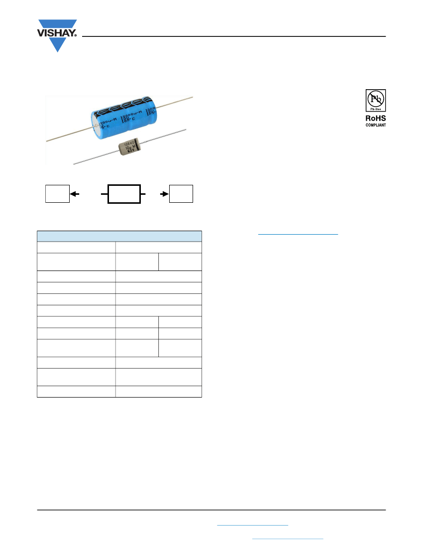

138 AML
www.vishay.com
Vishay BCcomponents
Aluminum Capacitors
Axial Miniature, Long-Life
• Polarized aluminum
non-solid electrolyte
electrolytic
capacitors,
• Axial leads, cylindrical aluminum case, insulated
with a blue sleeve
(case Ø 6.3 mm x 12.7 mm and 7.7 mm x 12.7 mm are
molded with flame retardant plastic material)
• Mounting ring version not available in insulated form
• Taped versions up to case Ø 15 mm x 30 mm available for
automatic insertion
• Charge and discharge proof
021 ASM
smaller
dimensions
138 AML
longer
life
118
AHT
120 AT
• Long useful life: 2000 h to 10 000 h at 105 °C, high
reliability
• High ripple current capability
• Miniaturized, high CV-product per unit volume
• Material categorization: For definitions of compliance
please see
www.vishay.com/doc?99912
Fig. 1
