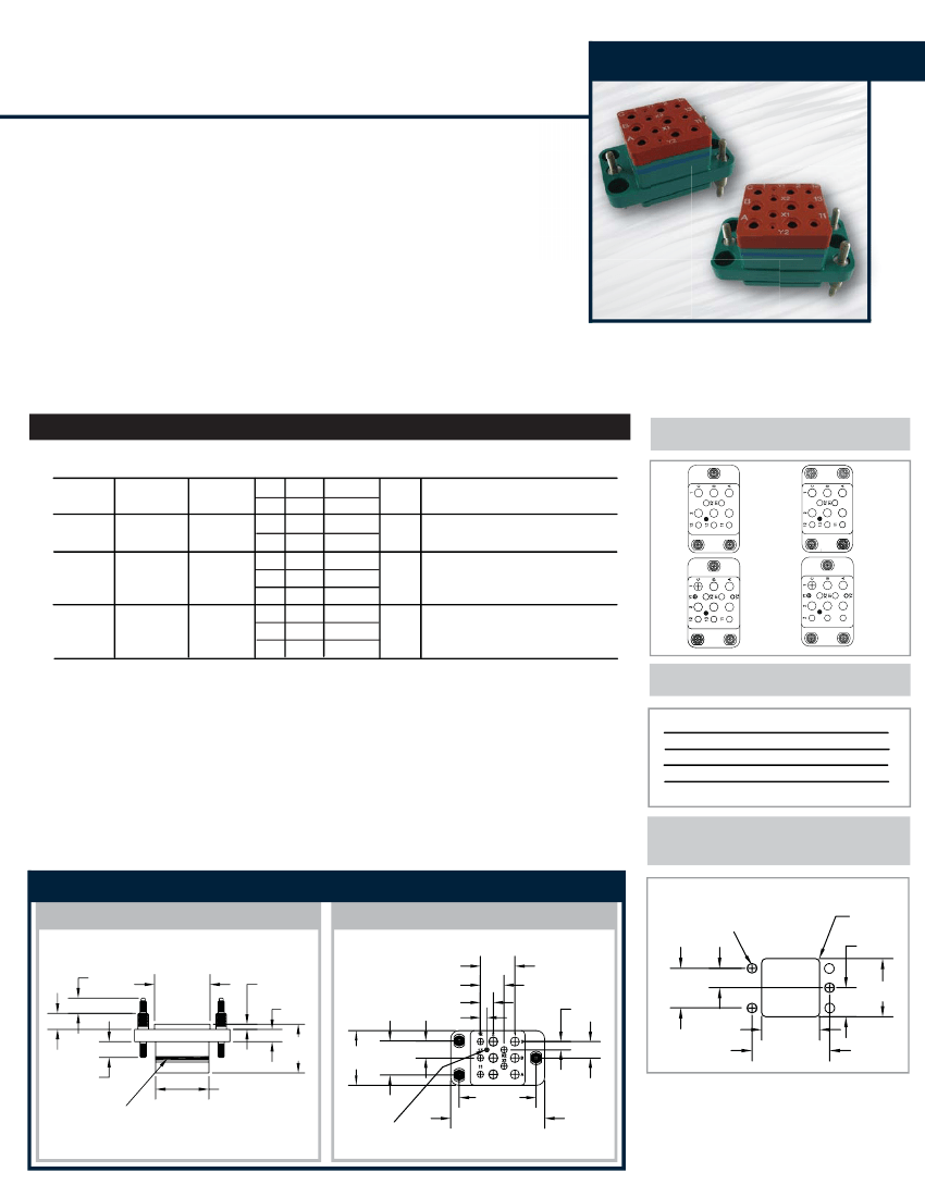

MIL-PRF-12883/54
RSE 3 Pole/25 Amp
Operating Range
Temperature:
-65ºC to 125ºC
Insulation Resistance:
1000 Megaohms Min.
Dielectric Withstanding Voltage:
1500 VRMS at Sea Level
500 VRMS at 80,000 ft.
Vibration:
MIL-STD-202, Method 204
Test Condition G
Shock:
MIL-STD-202, Method 213
Test Condition C
Relay Sockets
Materials
Socket Body:
Polyetherimide per ASTM-D5205
Grommet:
Silicone Rubber per A-A-59588
Hardware:
Stainless Steel or Steel w/
Cadmium Chromate Finish
Contact Retainers:
Stainless Steel
Socket Contacts:
Copper Alloy, Hard Gold Plated in
Accordance with SAE-AMS 2422
Mates with M6106/12, /13 & MS27742 Relays
Low Profile Relay Sockets
MIL P/N
M12883
/54-01
/54-02
APCD
P/N
RSE116627
RSE116631
Mounting QTY Size* Contact Config.
P/N
Stud
Fixed
Fixed
16/16
12/12
16/16
12/12
20/20
16/16
12/12
20/20
16/16
12/12
/92-533
/92-535
/92-533
/92-535
/92-532
/92-533
/92-535
/92-532
/92-535
/92-535
Mating Relay
Socket Configurations
M6106/13-002,-008,-011,-013,-015
M6106/13-004
/54-03
RSE116629
Fixed
M6106/12-002
MS27742-2
/54-04
RSE116635
Fixed
Mounting instructions can be found on page 26
Relay Socket Weight
Relay Socket
RSE116627
RSE116631
RSE116629
RSE116635
Pounds
.132
.132
.154
.154
Grams
Recommended Mounting
Panel Cutout
Relay Socket Dimensions
Side View
Top View
CONFIG. A
SHOWN
.630
.432
BOTTOM MOUNT CLEARANCE
HOLE FOR .190 SCREW
TOP MOUNT CLEARANCE
HOLE FOR .112 SCREW
.05 R
4 PL
.550
.290
.245
1.00
.093
.220
.312
.625
.150
1.100
.234
.117
.290
.890
MAX
.295
.265
1.00 MAX
BLUE STRIPE FOR
REAR RELEASE
1.015
MAX
.312
1.160
.625
.300
1.406
1.406
1.74 MAX
DIA .078 X .355/.380 DP
POLARIZING HOLE
Amphenol Pcd
