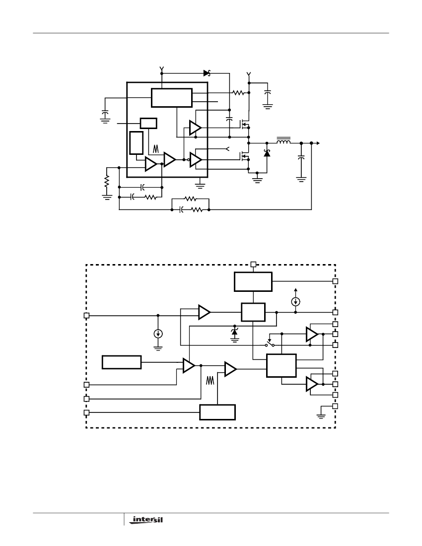

Typical Application
12V
VCC
OCSET
MONITOR AND
PROTECTION
EN
BOOT
RT
+5V OR +12V
SS
OSC
UGATE
PHASE
+V
O
PVCC
+12V
HIP6012
REF
LGATE
PGND
GND
FB
COMP
Block Diagram
VCC
POWER-ON
RESET (POR)
10µA
OCSET
EN
OVER-
CURRENT
4V
SOFT-
START
SS
BOOT
UGATE
PHASE
200µA
1.27 VREF
REFERENCE
PWM
COMPARATOR
INHIBIT
PWM
FB
COMP
ERROR
AMP
GATE
CONTROL
LOGIC
PVCC
LGATE
PGND
GND
RT
OSCILLATOR

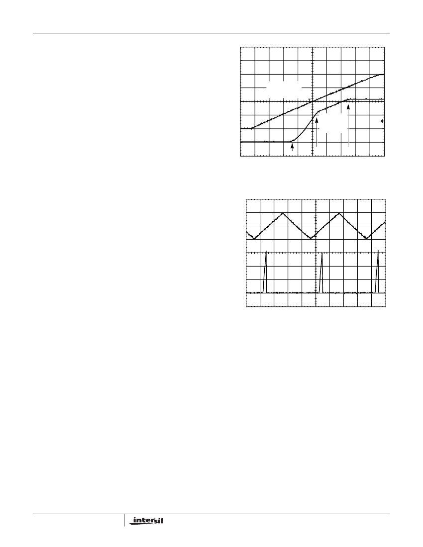

SOFT-START
(1V/DIV.)
PVCC (Pin 13)
Provide a bias supply for the lower gate drive to this pin.
VCC (Pin 14)
Provide a 12V bias supply for the chip to this pin.
0V
0V
t1
t2
OUTPUT
VOLTAGE
(1V/DIV.)

t3
TIME (5ms/DIV.)
FIGURE 3. SOFT-START INTERVAL
SOFT-START
OUTPUT INDUCTOR
4V
2V
0V
15A
10A
5A
0A
TIME (20ms/DIV.)
Soft Start
The POR function initiates the soft start sequence. An
internal 10µA current source charges an external capacitor
(C
SS
) on the SS pin to 4V. Soft start clamps the error
amplifier output (COMP pin) and reference input (+ terminal
of error amp) to the SS pin voltage. Figure 3 shows the soft
start interval with C
SS
= 0.1µF. Initially the clamp on the
error amplifier (COMP pin) controls the converter’s output
voltage. At t1 in Figure 3, the SS voltage reaches the valley
of the oscillator’s triangle wave. The oscillator’s triangular
waveform is compared to the ramping error amplifier
voltage. This generates PHASE pulses of increasing width
that charge the output capacitor(s). This interval of
increasing pulse width continues to t2. With sufficient
output voltage, the clamp on the reference input controls
the output voltage. This is the interval between t2 and t3 in
Figure 3. At t3 the SS voltage exceeds the reference
voltage and the output voltage is in regulation. This method
provides a rapid and controlled output voltage rise.
FIGURE 4. OVERCURRENT OPERATION
Overcurrent Protection
The overcurrent function protects the converter from a
shorted output by using the upper MOSFETs on-resistance,
r
DS(ON)
to monitor the current. This method enhances the
converter’s efficiency and reduces cost by eliminating a
current sensing resistor.
The overcurrent function cycles the soft-start function in a
hiccup mode to provide fault protection. A resistor (R
OCSET
programs the overcurrent trip level. An internal 200µA
(typical) current sink develops a voltage across R
OCSET
that
is reference to V
IN
. When the voltage across the upper
MOSFET (also referenced to V
IN
) exceeds the voltage
across R
OCSET
, the overcurrent function initiates a soft-start
sequence. The soft-start function discharges C
SS
with a
10µA current sink and inhibits PWM operation. The soft-start
function recharges C
SS
, and PWM operation resumes with
the error amplifier clamped to the SS voltage. Should an
overload occur while recharging C
SS
, the soft start function
inhibits PWM operation while fully charging C
SS
to 4V to
