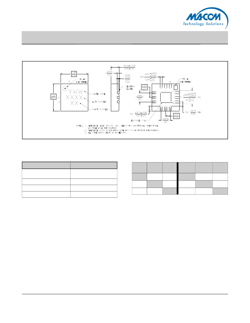

MASWSS0199
GaAs SP3T 2.6 V CDMA-GPS Switch
DC - 2.5 GHz
Lead-Free
3 mm 12-Lead PQFN
Rev. V1
Reference Application Note M538 for lead-free solder reflow recommendations.
Absolute Maximum Ratings
4,5
Input Power
(0.5 - 2.5 GHz, 2.6 V Control)
Operating Voltage
Operating Temperature
Storage Temperature
Truth Table
6,7,8
V1
Absolute Maximum
+35 dBm
+8.5 volts
-40°C to +85°C
-65°C to +150°C
V2
V3
ANT–
GPS
On
Off
Off
ANT -
PCS
Off
On
Off
ANT -
CELL
Off
Off
On
4. Exceeding any one or combination of these limits may cause
permanent damage to this device.
5. M/A-COM does not recommend sustained operation near
these survivability limits.
6. For positive voltage control, external DC blocking capacitors
are required on all RF ports.
7. Differential voltage, V(state 1) - V(state 0), must be +2.6 V
minimum, but must not exceed +8.5 V.
8. 0 = -5 V to +2.4 V, 1 = -2.4 V to +5 V.
Handling Procedures
Please observe the following precautions to avoid
damage:
Static Sensitivity
Gallium Arsenide Integrated Circuits are sensitive
to electrostatic discharge (ESD) and can be
damaged by static electricity. Proper ESD control
techniques should be used when handling these
devices.

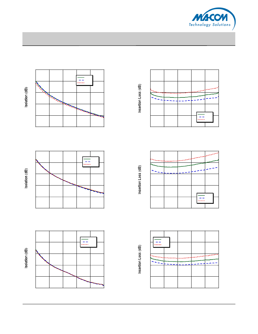

Typical Performance Curves
Cell Path Isolation
+25°C
-40°C
+85°C
Rev. V1
Cell Path Insertion Loss
35
0.8
0.6
0.4
0.2
+25°C
-40°C
+85°C
2.0
2.5
3.0
0.0
2.0
2.5
3.0
Frequency (GHz)
Frequency (GHz)
GPS Path Isolation
+25°C
-40°C
+85°C
GPS Path Insertion Loss
35
0.8
0.6
0.4
0.2
+25°C
-40°C
+85°C
2.0
2.5
3.0
0.0
2.0
2.5
3.0
Frequency (GHz)
Frequency (GHz)
PCS Path Isolation
+25°C
-40°C
+85°C
PCS Path Insertion Loss
35
0.8
+25°C
-40°C
+85°C
0.6
0.4
0.2
2.0
2.5
3.0
0.0
2.0
2.5
3.0
Frequency (GHz)
Frequency (GHz)
