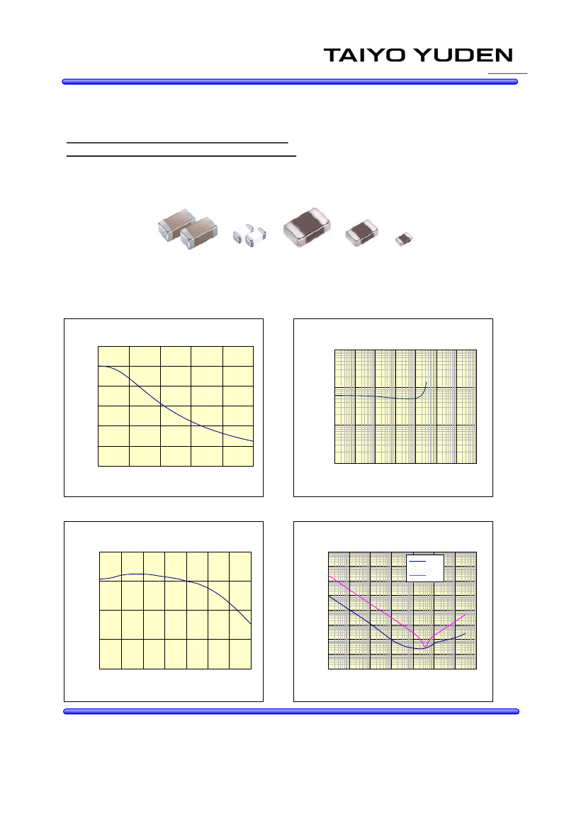

-Electrical Characteristics Data-
16R3A02
RoHS compliance product
-20
LMK063BJ683MP
DC Bias Char.
LMK063BJ683MP
Capacitance Freq.
Capacitance[uF]
0.1
dC/C[%]
-40
-60
-80
0.01
-100
DC Bias Voltage[V]
0.001
0.001 0.01 0.1
100 100010000
Frequency[MHz]
LMK063BJ683MP
Capacitance Temp.
100000
10000
1000
LMK063BJ683MP
Impedance,ESR Freq.
ESR
Z
-10
Z,ESR[OHM]
-55
-35
-15
45
Temperature[degreeC]
65
85
dC/C[%]
0.1
-20
0.01
-30
0.001
0.001 0.01
0.1
10 100 1000 10000
Frequency[MHz]
