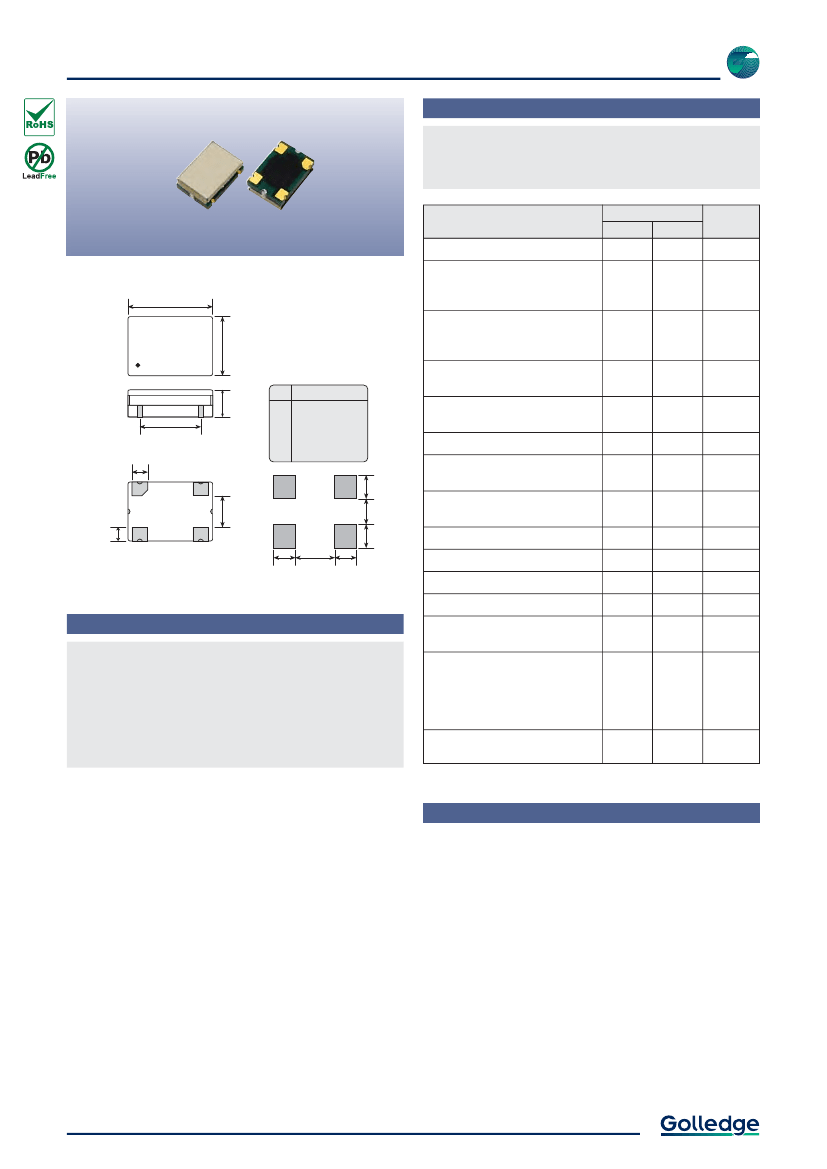

SM (VC)TCXO Low Phase Noise
Specifications
2011/65/EU
GTXO-C74
GTXO-C74T: TCXO, no frequency adjustment
GTXO-C74V: TCXO with VC frequency adjustment
Variant
N
Option
Codes
Parameters
Frequency range:
30.0 ~ 61.44MHz
Frequency stability:
7.00
±0.03
±2.5ppm
±2.0ppm
±1.5ppm
-20 to +70°C
-30 to +75°C
-40 to +85°C
Temperature range:
5.00
±0.03
2.30
±0.20
5.08
1.40
PAD
CONNECTION
Not connected or
Freq adjustment
Storage temperature range:
-40 to +85°C
Supply voltage stability:
±1.0ppm, V
DD
±5%
Driving ability:
15pF CMOS
Ground
Output
Supply
2.60
2.00
2.20
Logic levels:
‘0’ level = 10%V
DD
max
‘1’ level = 90%V
DD
min
Waveform symmetry:
45:55 @ 50%V
DD
Ageing:
±1.0ppm max first year
+3.3V ±5%
20.0mA max
3ms max
1.20
2.00
1.80
3.28
TOP VIEW
1.80
Supply voltage (V
DD
Supply current:
Start up time:
Frequency adjustment:
None
±8 ~ ±14ppm, +1.5V ±1.0V
Phase noise (typ @ 61.44MHz):
-84dBc/Hz @ 10Hz
-115dBc/Hz @ 100Hz
-141dBc/Hz @ 1kHz
-154dBc/Hz @ 10kHz
Preset frequency @ 25°C:
±2.0ppm max
Low phase noise
CMOS output
Miniature SM package
Sealed crystal design
Standard.
Optional - Please specify required code(s) when ordering
Ordering Information
Product name + variant + option codes + frequency
Option codes must be included to properly specify a model.
eg:
GTXO-C74V/JS 38.40MHz
±2.5ppm -30+85°C, TCXO with VC
GTXO-C74T/GN 50.0MHz
±1.5ppm -20+75°C, TCXO no VC
Option code X (eg GTXO-C74V/X) denotes a custom spec.
