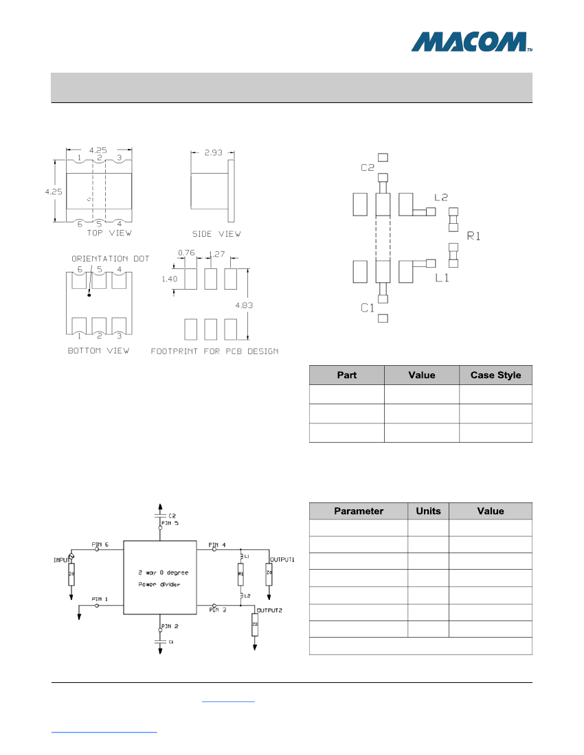

MAPD-011007
2 Way 0° Power Divider
5 - 2150 MHz
Outline Drawing
Recommended Layout
Rev. V4
Component List
Dimensions in mm.
Tolerance: ±0.2mm unless otherwise noted.
Model number and lot code are printed on the reel.
Plating finish: ENIG on both sides, 0.05 to 0.1 µm gold over 3 to
6 µm nickel
C1, C2
L1, L2
R1
0.5 pF
8.2 nH
240
Ω
0402
0402
0402
Application Circuit
Tape & Reel Information
Reel size
Tape width (W)
Pitch (P
K
Orientation
mm
mm
mm
mm
mm
mm
330
12.00
8.00
4.5
4.5
3.2
F18
Reference Application note ANI-019 for orientation

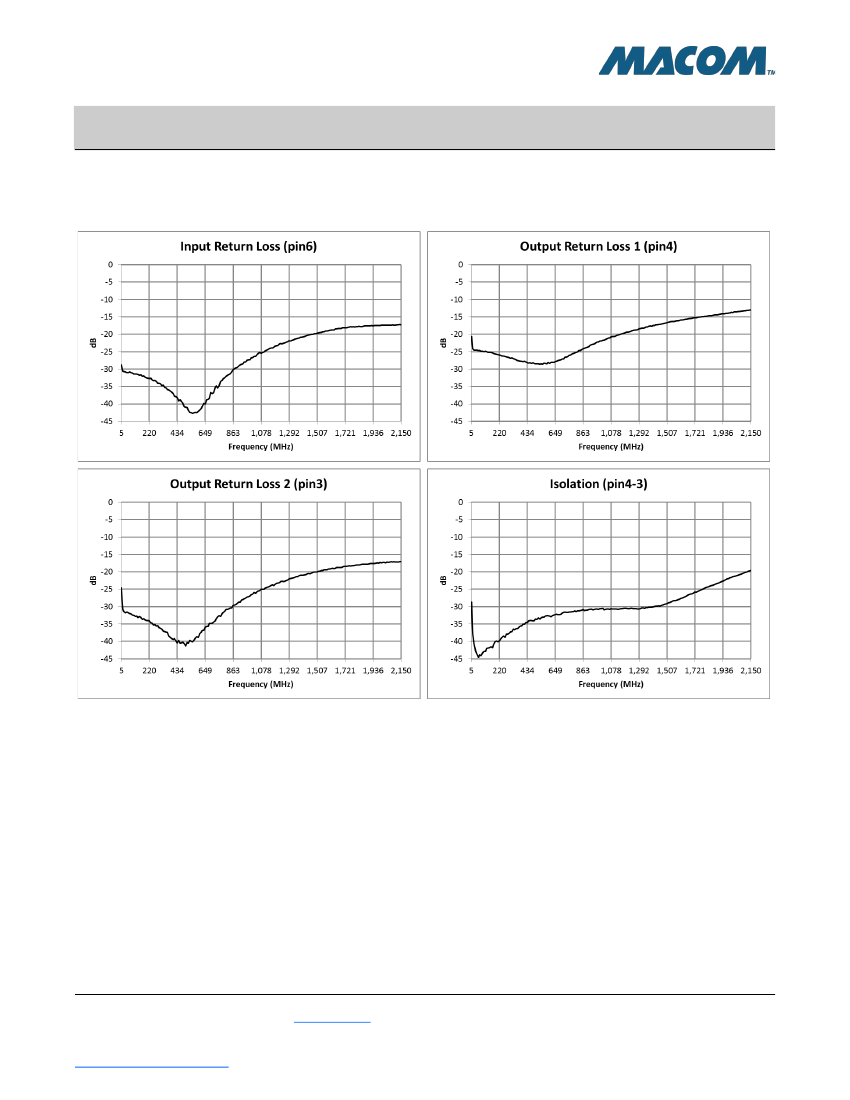

Typical Performance Curves: Z
= 75
Ω,
= 25°C, P
IN
= 0 dBm
Rev. V4
Full temperature plots available on request

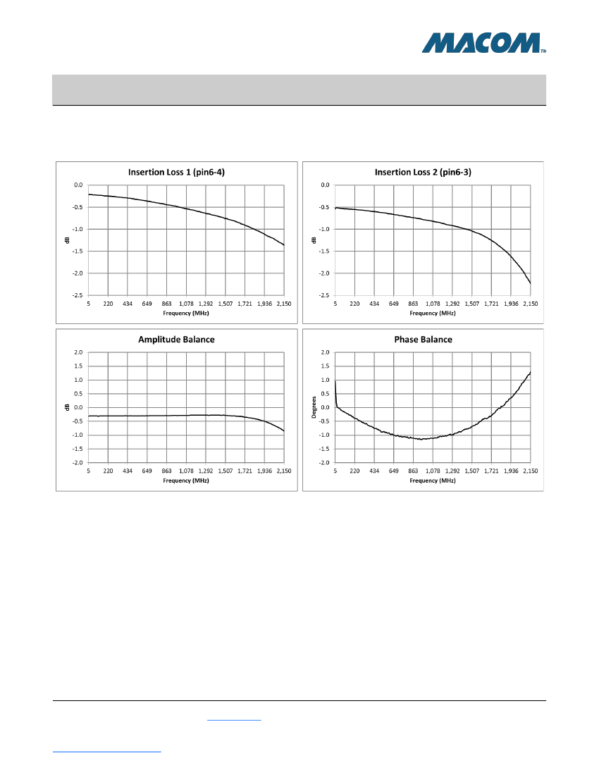

= 75
Ω,
= 25°C, P
IN
= 0 dBm
Rev. V4
