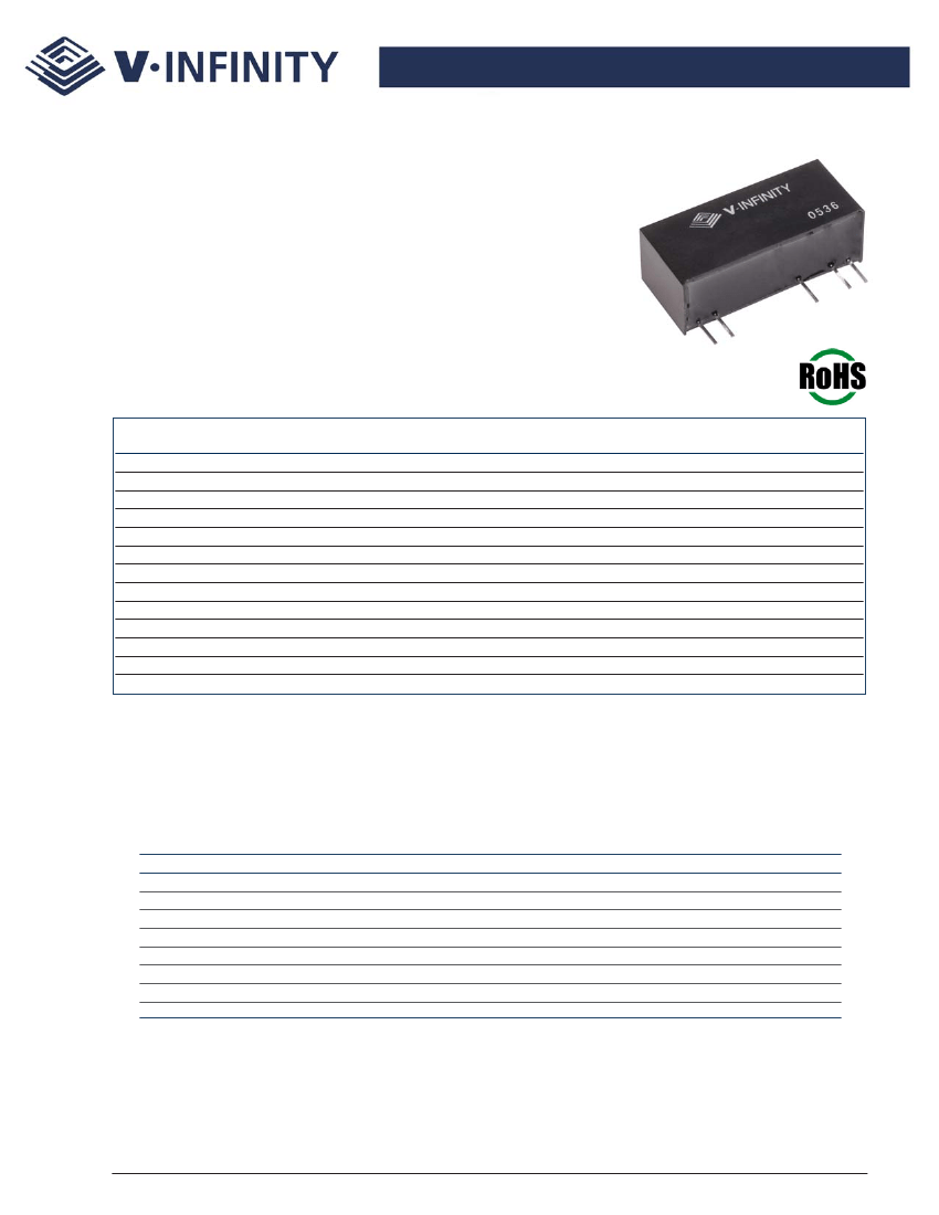

VIAS2-SIP Series DC-DC Converter
Rev. 06-2006
Designed to convert fixed volt-
ages into an isolated regulated
voltage, the VIAS2-SIP series is
well suited for providing board-
mount local supplies in a wide
range of applications, including
mixed analog/digital circuits, test
& measurement equip.,
process/machine controls, data-
com/telecom fields, etc...
·Isolated 2 W output
·Regulated
·High efficiency to 74%
·Dual voltage output
·Small footprint
·SIP package style
·Industry standard pinout
·UL94-V0 package
·No heatsink required
·1K VDC isolation
·Temperature range: -40°C~+85°C
·No external component required
·Low cost
Model
Number
VIAS2-S5-D5-SIP
VIAS2-S5-D9-SIP
VIAS2-S5-D12-SIP
VIAS2-S5-D15-SIP
VIAS2-S12-D5-SIP
VIAS2-S12-D9-SIP
VIAS2-S12-D12-SIP
VIAS2-S12-D15-SIP
VIAS2-S24-D5-SIP
VIAS2-S24-D9-SIP
VIAS2-S24-D12-SIP
VIAS2-S24-D15-SIP
Input Voltage
Nominal
Range
5 Vdc
4.75~5.25 Vdc
5 Vdc
4.75~5.25 Vdc
5 Vdc
5 Vdc
12 Vdc
12 Vdc
12 Vdc
12 Vdc
24 Vdc
24 Vdc
24 Vdc
24 Vdc
4.75~5.25 Vdc
4.75~5.25 Vdc
11.4~12.4 Vdc
11.4~12.4 Vdc
11.4~12.4 Vdc
11.4~12.4 Vdc
22.8~25.2 Vdc
22.8~25.2 Vdc
22.8~25.2 Vdc
22.8~25.2 Vdc
Output
Voltage
±5 Vdc
±9 Vdc
±12 Vdc
±15 Vdc
±5 Vdc
±9 Vdc
±12 Vdc
±15 Vdc
±5 Vdc
±9 Vdc
±12 Vdc
±15 Vdc
Output Current
Max.
Min.
±150 mA
±15 mA
±100 mA
±10 mA
±83 mA
±67 mA
±150 mA
±100 mA
±83 mA
±67 mA
±150 mA
±100 mA
±83 mA
±67 mA
±9 mA
±7 mA
±15 mA
±10 mA
±9 mA
±7 mA
±15 mA
±10 mA
±9 mA
±7 mA
Efficiency
70%
72%
72%
73%
70%
71%
72%
74%
71%
72%
73%
73%
Package
Style
SIP
SIP
SIP
SIP
SIP
SIP
SIP
SIP
SIP
SIP
SIP
SIP
Note:
1. All specifications measured at TA=25°C, humidity <75%, nominal input voltage and rated output load unless
otherwise specified.

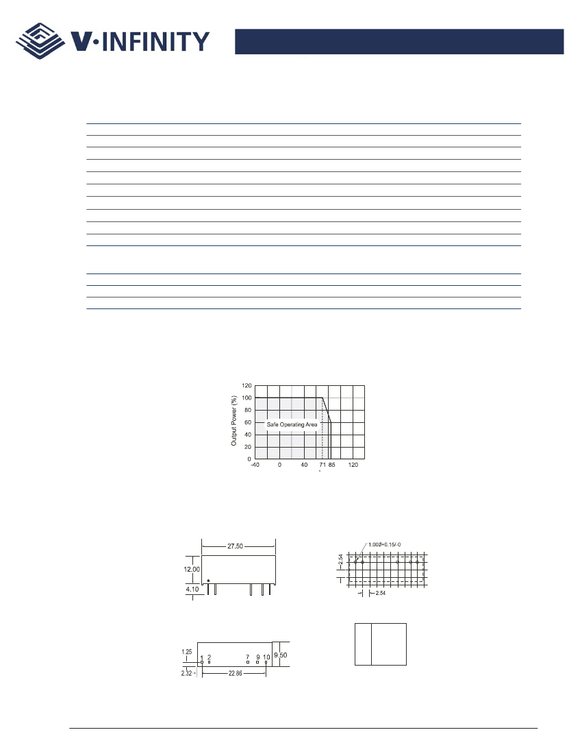

Output Specifications
Item
Output power
Line Regulation
Load Regulation
Output voltage accuracy
Temperature drift
Output ripple
Output noise
Switching frequency
Test conditions
For Vin change of 1%
10% to 100% full load
100% full load
100% full load
20 MHz Bandwidth
20 MHz Bandwidth
Full load, nominal input
75
75
Min.
0.2
Typ.
Max.
0.25
±3
0.03
Units
%/°C
mVp-p
mVp-p
KHz
