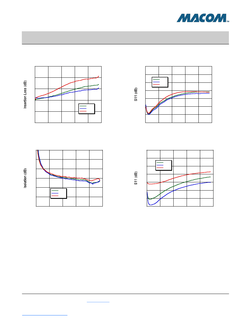

Typical Performance Curves
Insertion Loss vs. Frequency over Temperature
Rev. V1
S11 (Switch On) vs. Frequency over Temperature
-5
0.8
-10
0.6
+25°C
-40°C
+85°C
-15
-20
+25C
-40°C
+85°C
0.4
-25
-30
0.2
0.0
250
750
1000
1250
-35
250
750
1000
1250
Frequency (MHz)
Frequency (MHz)
Isolation vs. Frequency over Temperature
S11 (Switch Off) vs. Frequency over Temperature
-5
-10
-15
+25°C
-40°C
+85°C
65
55
-20
+25°C
-40°C
+85°C
-25
-30
-35
45
250
750
1000
1250
250
750
1000
1250
Frequency (MHz)
Frequency (MHz)

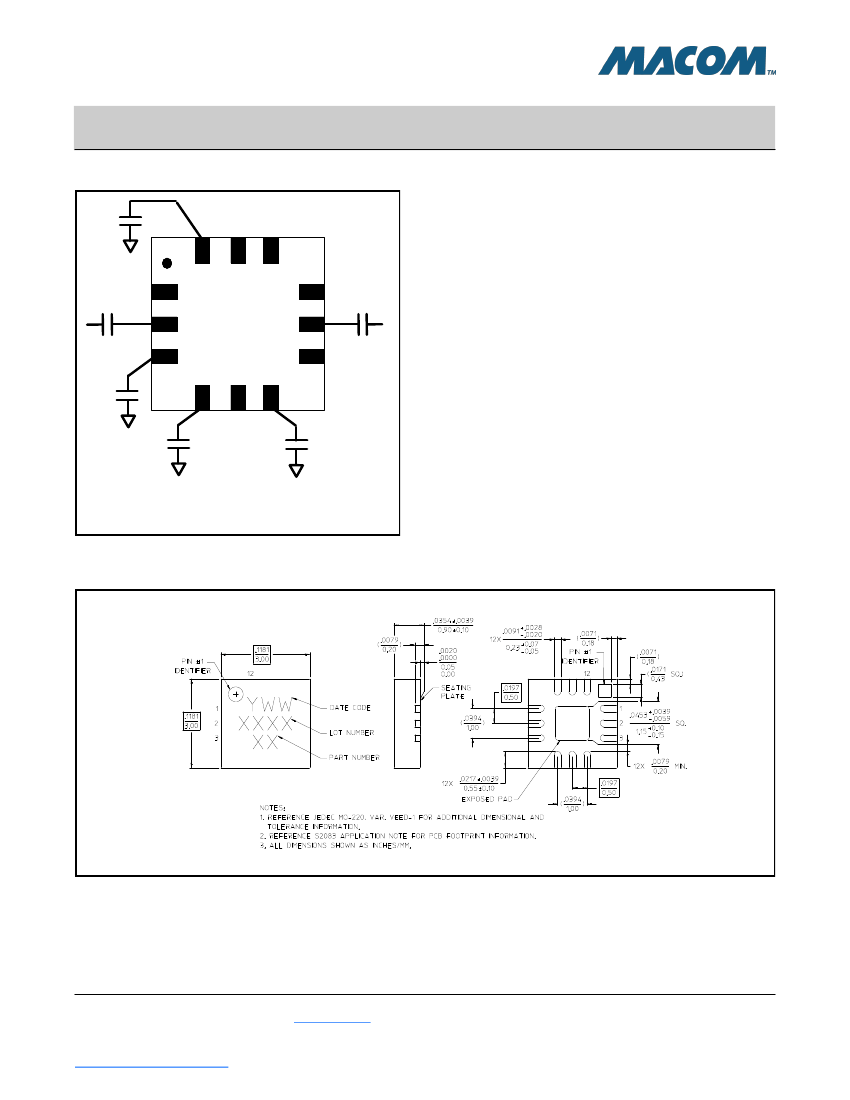

Application Schematic
Qualification
GND
GND
GT1
Rev. V1
C3
Qualified to M/A-COM Specification Rel 201,
Process Flow –2.
Handling Procedures
C1
GND
RF1
G1
GND
RF2
GND
C2
Please observe the following precautions to avoid
damage:
Static Sensitivity
Gallium arsenide integrated circuits are sensitive to
electrostatic discharge (ESD) and can be damaged
by static electricity. Use proper ESD control
precautions when handling these devices.
GND
C4
C5
V1
C6
C1 – C4 = 0.01 uF, DC Blocking Capacitors
C5, C6 = 0.01 uF, Logic Control Decoupling Capacitors
Lead-Free
3 mm 12-Lead PQFN
Reference Application Note M538 for lead-free solder reflow recommendations.
