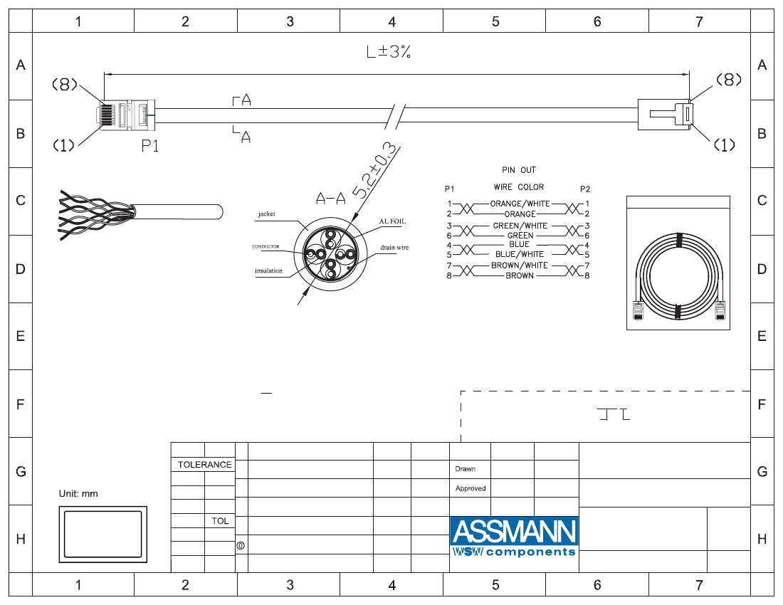

A-MCSP-80020-B-AP-R概述
Cat5e FTP Patch cable
文档预览
下载PDF文档
Material:
• Conductor: 26AWG 7*0.16±0.015mm
• Conductor Insulation color coding: (1)White/Orange, (1)Orange, (1)White/Green,
(1)Green, (1)Blue, (1)White/Blue, (1)White/Brown, (1)Brown
• Cable Jacket printing:
CM (UL) C(UL) 4P 26AWG FTP CAT.5E PATCH CABLE
ISO/IEC & EN & ANSI/TIA-568-C.2
• Cable Assembly: White cable tie, Wiring T568B color, Plug RJ45 8P8C 50 ” pc UL 94V-2
• Cable Jacket color: Red, Yellow, Green or Blue
Order Code:
A-MCSP-80xxx/x-AP-R
• Length: L±3%m
• Dielectric strength: 2.5KV dc-2seconds
Order lengths in meter: 0.5,1,
Order color: Red, Yellow,
• Working temperatures: -20°C~60°C
2,3,5
Green, Blue
Scale
X.
X.X
±X
±X
±X
±X°
±X°
TOL
Id.
Drawn
Modification
18.02.13
Date
Wilson
Replace
Name
1840 W. Drake Drive, Suite 101 • Tempe, AZ 85283
Toll Free: 1-877-277-6266 • Email: info@assmann.us
Date
18.02.13
18.02.13
Name
Wilson
Groll
Title
Assembly type, 26AWG, colored
ASSMANN WSW-No.
RoHS
Compliant
X.XX
DIM
X.°
X.X°
Angle
A-MCSP-80xxx/x-AP-R
Drawing-No.
rev00
Sheet
1/1
