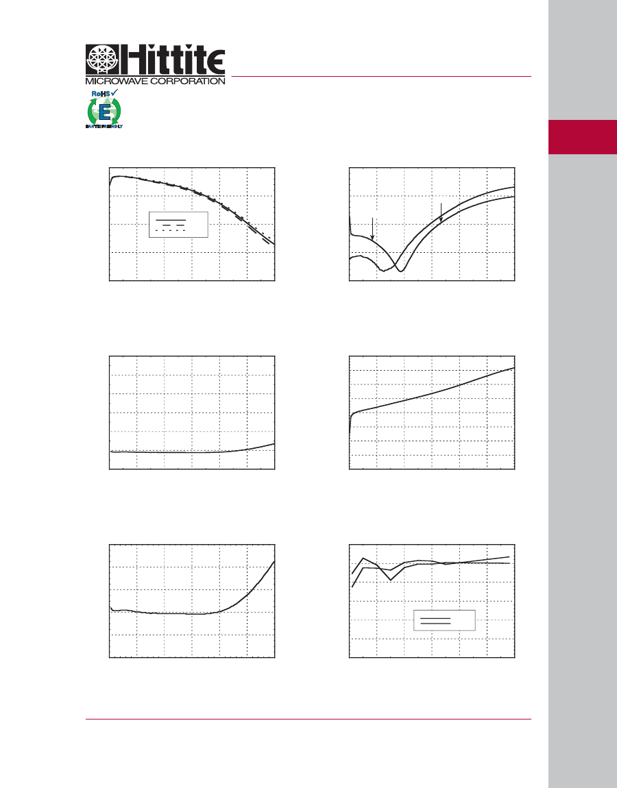

Insertion Loss
Return Loss RF1, RF2
I.L.dB
RETURN LOSS (dB)
-1
-10
10 dB
-2
+25 C
+85 C
-40 C
-20
-3
-30
-4
FREQUENCY (GHz)
-40
FREQUENCY (GHz)
Normalized Attenuation
NORMALIZED ATTENUATION (dB)
-2
Relative Phase vs. Frequency
RELATIVE PHASE (deg)
-10
-20
-30
-40
-4
-6
-8
-10
-12
FREQUENCY (GHz)
FREQUENCY (GHz)
Bit Error vs. Frequency
Input IP3 vs. Frequency
0.6
BIT ERROR (dB)
0.2
IP3 (dBm)
I.L. dB
10 dB
-0.2
-0.6
FREQUENCY (GHz)
FREQUENCY (GHz)

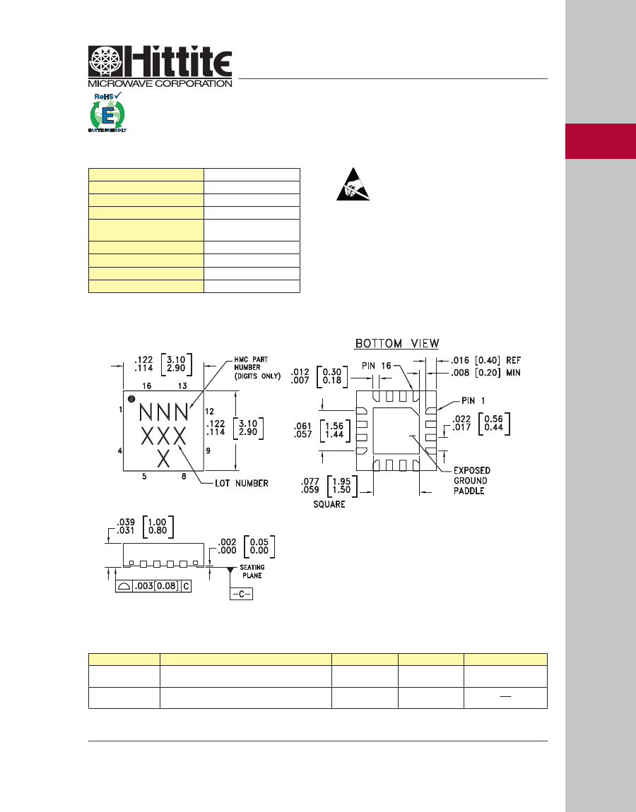

Outline Drawing
NOTES:
1. LEADFRAME MATERIAL: COPPER ALLOY
2. DIMENSIONS ARE IN INCHES [MILLIMETERS]
3. LEAD SPACING TOLERANCE IS NON-CUMULATIVE
4. PAD BURR LENGTH SHALL BE 0.15mm MAXIMUM.
PAD BURR HEIGHT SHALL BE 0.05mm MAXIMUM.
5. PACKAGE WARP SHALL NOT EXCEED 0.05mm.
6. ALL GROUND LEADS AND GROUND PADDLE MUST BE
SOLDERED TO PCB RF GROUND.
7. REFER TO HITTITE APPLICATION NOTE FOR SUGGESTED
LAND PATTERN.
Package Information
HMC541LP3
HMC541LP3E
Package Body Material
Low Stress Injection Molded Plastic
RoHS-compliant Low Stress Injection Molded Plastic
Lead Finish
Sn/Pb Solder
100% matte Sn
MSL Rating
MSL1
MSL1
[1]
Package Marking
[3]
541
XXXX
541
XXXX
[2]
[1] Max peak reflow temperature of 235 °C
[2] Max peak reflow temperature of 260 °C
[3] 4-Digit lot number XXXX

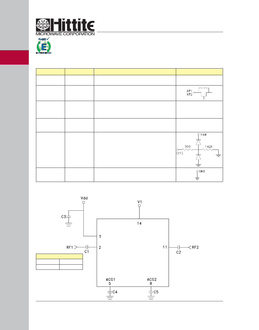

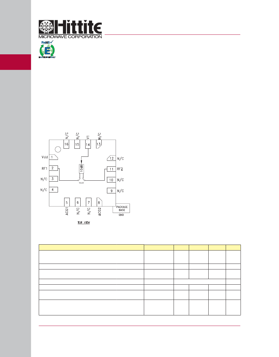

Pin Descriptions
Pin Number
Function
Vdd
Supply Voltage.
This pin is DC coupled and matched to 50 Ohm.
Blocking capacitors are required.
Select value based on lowest frequency of operation.
Interface Schematic
2, 11
RF1, RF2
3, 4, 6, 7,
9, 10, 12,
13, 15, 16
N/C
These pins should be connected to PCB RF ground to
maximize performance.
5, 8
ACG1, ACG2
External capacitor to ground is required. Select value for
lowest frequency of operation. Place capacitor as close
to pins as possible.
V1
See truth table and control voltage table.
GND
Package bottom has an exposed metal paddle that must be
connected to RF Ground.
Application Circuit
Recommended Component Values
C1 - C3
C4, C5
1,000 pF ± 10%
330 pF ± 10%
