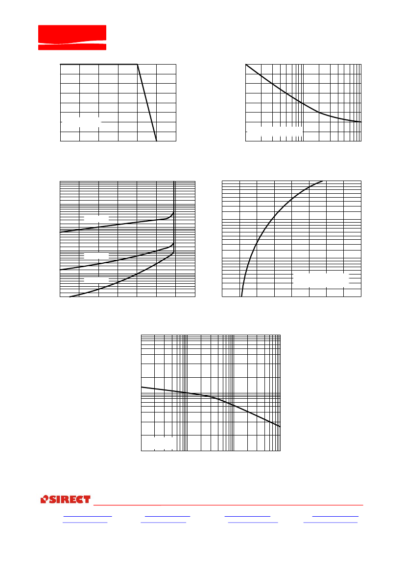

SBL4030PT
Power Schottky Rectifier - 40Amp 30Volt
-Plastic package has Underwriters Laboratory Flammability Classifications 94V-0
-High Junction Temperature Capability
-Low forward voltage, high current capability
-High surge capacity
-Low power loss, high efficiency
TO-247AD
Application
-Switching-Mode Power Supply
-Solar-System Control Box
Absolute maximum ratings
Ratings
0.35
-50 to +150
-50 to +125
ºC
ºC
Conditions
F(AV)
RRM
FSM
F(max)
j
stg
M
K
A1
K
A2
Average Forward Current
O
Repetitive Peak Reverse
Voltage
Peak Forward Surge Current
Forward Voltage Drop
Operating Temperature
Storage Temperature
K
N
Electrical characteristics
Parameters
Maximum Instantaneous
Forward Voltage
Maximum Reverse Leakage
Current
Maximum Voltage Rate of
Change
Typical Thermal Resistance,
Junction to Case
Ratings
0.48V
0.35V
1.0mA
Conditions
Tc = 25ºC
Tc = 125ºC
Tc = 25ºC
DIM
K
M
N
O
dv/dt
10,000 V/μs
Rated V
θ
(j-c)
1.25
ºC/W
Per diode
DIMENSIONS
INCHES
MM
MIN
MAX
MIN
MAX
.748
.826
19.00 21.00
.787
.866
20.00 22.00
.598
.638
15.20 16.20
.132
.150
3.35
3.80
.217
.242
5.50
6.15
.209
.232
5.30
5.90
.077
.087
1.95
2.20
.161
.177
4.10
4.50
.551
.610
14.00 15.50
.045
.055
1.15
1.40
.197
.219
5.00
5.55
.189
.205
4.80
5.20
.024
.031
0.60
0.80
.086
.095
2.20
2.40
.116
.128
2.95
3.25
NOTE
Note: Pulse Test : 380μs pulse width, 2% duty cycle
