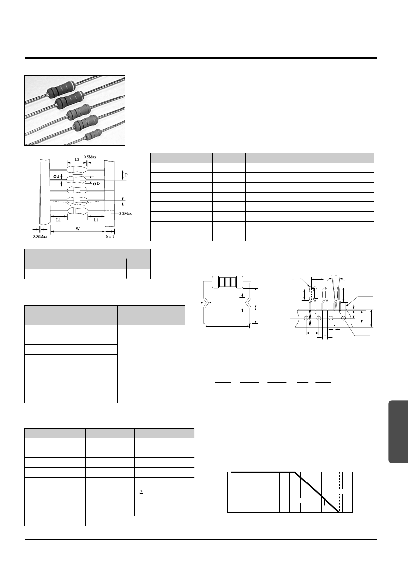

FR
SERIES
FIXED FUSIBLE RESISTORS
Provide an excellent fusing characteristic for CIRCUIT protection in
case of overload or component failure.
Opening th circuit safety without burning and flaming at
a emergency overload due to make use of flame proof coating.
Coating Color: Gray(FR 1/4W, 1/2W, 1W, 2W)
Marking: Color Code
TAPING DIMENSIONS
L2 0.5Max
d
Unit: mm
L1
d
0.58
0.58
0.70
0.70
0.80
0.80
0.80
0.80
L2
6.4
0.2
6.4
0.2
9.0
0.4
9.0
0.4
12.0
16.0
12.0
16.0
5.0
5.0
5.0
5.0
5.0
10.0
5.0
10.0
2.4
0.2
2.4
0.2
3.3
0.2
3.3
0.2
3.8
0.3
5.6
4.3
0.3
5.6
52
52
52
52
64
64
64
64
FR 1/4W
FRS 1/2W
FR 1/2W
FRS 1W
23
23
21.5
21.5
26
24
26
24
L1
0.08Max
FRS 2W R-J
L1
3.2Max
FR 1W
FR 2W
FRS 2W
FRS 3W
DIMENSIONS(mm)
H1
16.5
16.0
SELF-STANDING LEAD TYPE
M-FORMING TYPE
R-FORMING TYPE
Coating
16.5
12.7
2.5˚
12.7
FR 1/4W
FRS 1/2W
FR 1/2W
FRS 1W
FR 1W
FR 2W
FRS 2W
FRS 3W
0.25
2.0
2.0
3.0
250
250
250
0.22-1K
-25 ~ +155˚C
12.7
0.8
ø
0.7
0.05
ø
0.3
HOW TO ORDER
FR
1/2W
2E2
TB
FIXED RESISTORS
155
(1W, 2W, 3W)
(1/4W, 1/2W)
125
-25
120
140
160
235
CHARACTERISTICS
Characteristics
Short Time Over Load
Performance
Remark
Voltage Rating
2.5
5 Sec
350˚C / 3Sec
1000Hrs
1. ABCO Code
2. Power Rating
3. Resistance
4. Tolerance(
5% is standard)
5. Packing: TB is Tape & Ammo Box
(1%+0.05Ω)
(1%+0.05Ω)
(5%+0.05Ω)
30 Sec max.
Resistance To Soldering
Load Life
DERATING CURVE
Rated Load(%)
Ambient Temperature(˚C)
1Ω: P/PR = 25 Times
Fusing Characteristic
1Ω: P/PR = 16 Times
* P: Applied Power
PR: Power Rating
Residual Resistance
Over than 100 times of the nominal resistance
1Ω 60Sec max.
Specifications given herein may be changed at any time without prior notice. Please confirm technical specifications before your order and/or use.
83
Power
Max. Open circuit Resistance
Operating
Rating(W)
Voltage(V)
Range
Temp. Range
E-24-J(
5%)
9.0
1.0max.
SPECIFICATIONS
11Max
6.0min.
14max.
