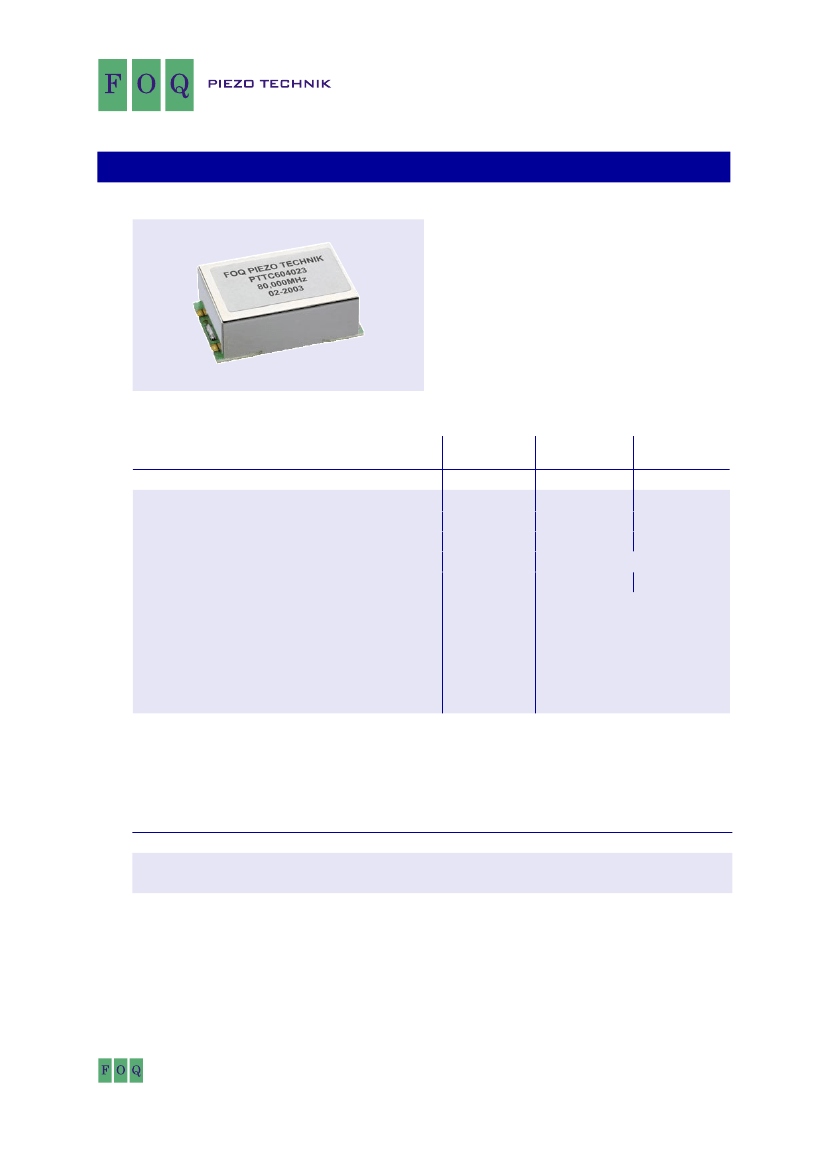

PTTC6 series - SMD TCXO, frequencies up to 120 MHz
Highlights PTTC6 series:
Low phase noise optimised design
High stability
Low aging
Different designs depending on customers requirements
Tuning range also available
General electrical parameter PTTC6 series
Supply voltage
Frequency range *
1)
Frequency overall tolerances (including all effects) *
2)
Ageing first year (15 years)
Operating temperature ranges
Storage temperature range
Output voltage
Typical phase noise @ 80,000 MHz
@ 100 Hz
@ 1 kHz
@ 10 kHz
@ 100 kHz
symbol
Vs
f0
∑∆f/f0
∆f/f (t)
TC 1
RF
from
3,3 V
2 MHz
10 ppm
o
C to + 70
o
to
5,0 V
120 MHz
4,6 ppm
- 40
o
C to + 85
o
typical 0,8 ppm (typical 2,6 ppm)
- 55
o
C to + 105
o
HCMOS or Sinewave
- 110 dBc/Hz
- 130 dBc/Hz
- 140 dBc/Hz
- 145 dBc/Hz
Notes:
1)
Further frequencies, tolerances and specifications upon request possible
2)
Including adjustment tolerance, tolerance vs temperature range, vs supply change, vs load change and 15 years ageing
Standard frequency examples (all in MHz)
9,600
30,000
10,000
41,250
12,000
55,000
— other frequencies are feasible —
16,384
80,000
20,000
103,703
26,500
115,000
