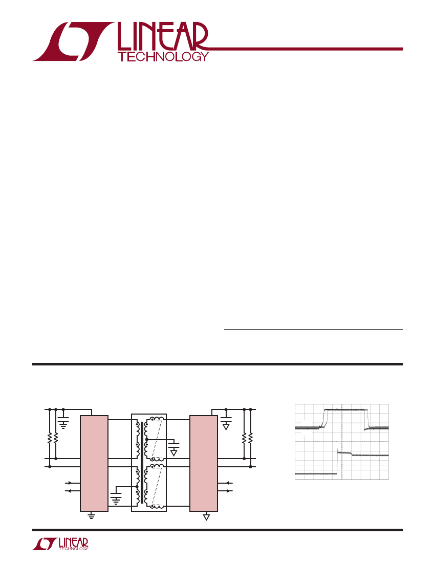

Typical applicaTion
1500V Isolated I
C System
3.3V
0.01µF
10/100Base-TX
ETHERNET TRANSFORMER
VCC TXP
RXP
VCC
0.01µF
ISOLATED
5V
0V
3.3k
3.3k
LTC4310-1
SDA
SCL
EN
READY
GND RXN
EPF8119S
0.01µF
TXN
RXP
0.01µF
LTC4310-1
RXN
TXP
SDA
SCL
EN
READY
TXN GND
431012 TA01a
LTC4310 Operating Through
20kV/µs Common Mode Transient
SCL
SDA
2V/DIV
3.3k
3.3k
SDA1
SCL1
SDA2
SCL2
20kV/µs
0V
2µs/DIV
431012 TA01b
500V/
DIV
431012f
