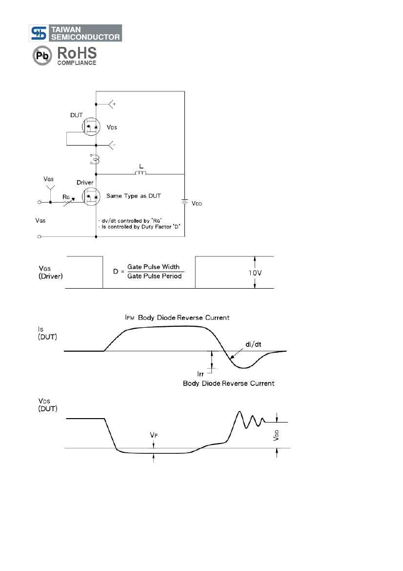

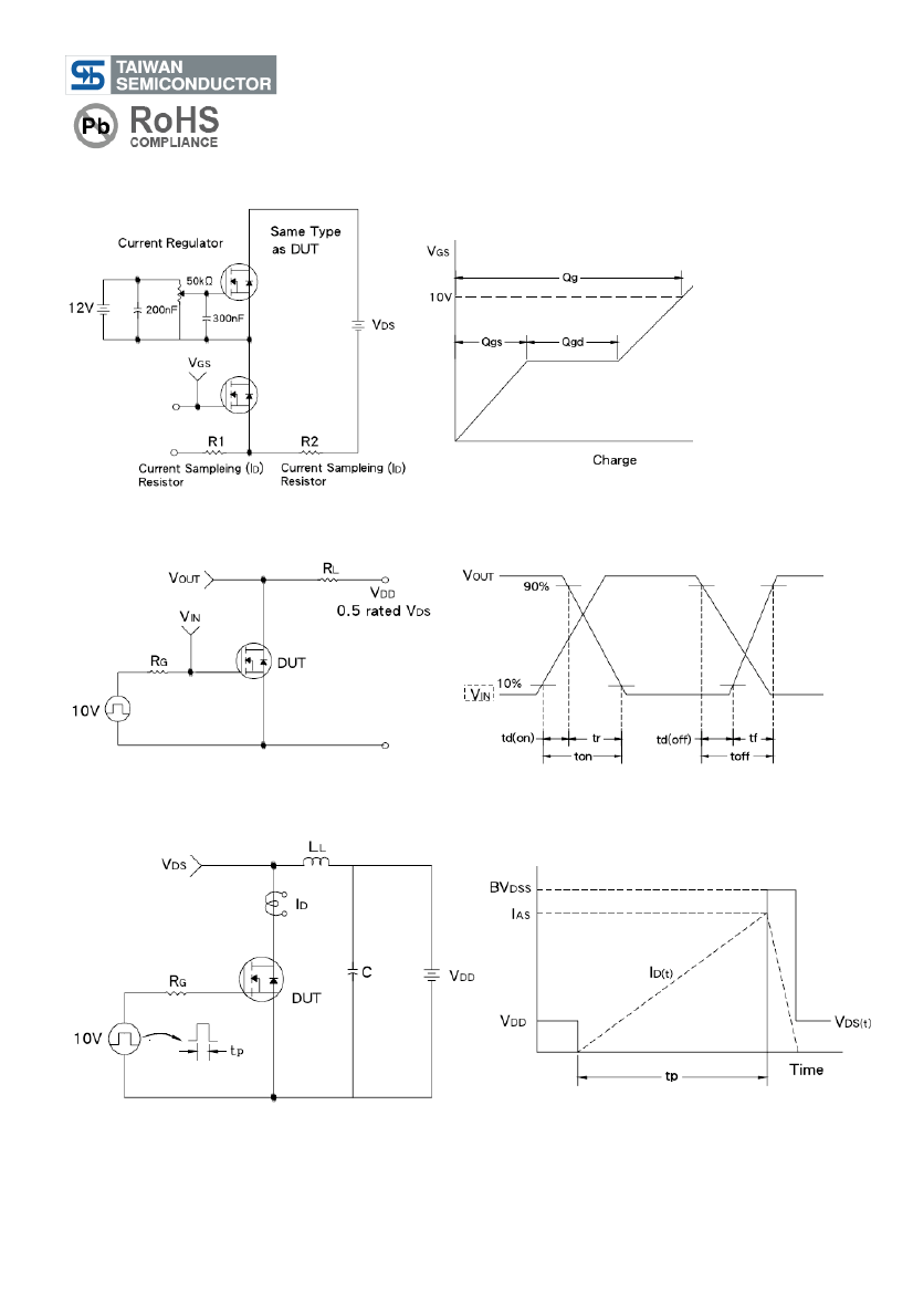

Gate Charge Test Circuit & Waveform
Resistive Switching Test Circuit & Waveform
AS
3/8
Version: A10
TSM8N70
700V N-Channel Power MOSFET
Diode Reverse Recovery Time Test Circuit & Waveform
4/8

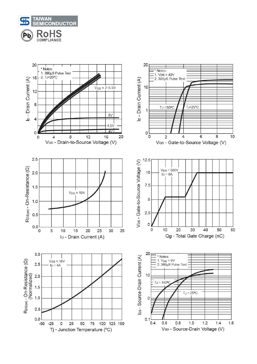

Electrical Characteristics Curve
(Ta = 25
o
C, unless otherwise noted)
Output Characteristics
Transfer Characteristics
On-Resistance vs. Drain Current
Gate Charge
On-Resistance vs. Junction Temperature
Source-Drain Diode Forward Voltage
5/8
