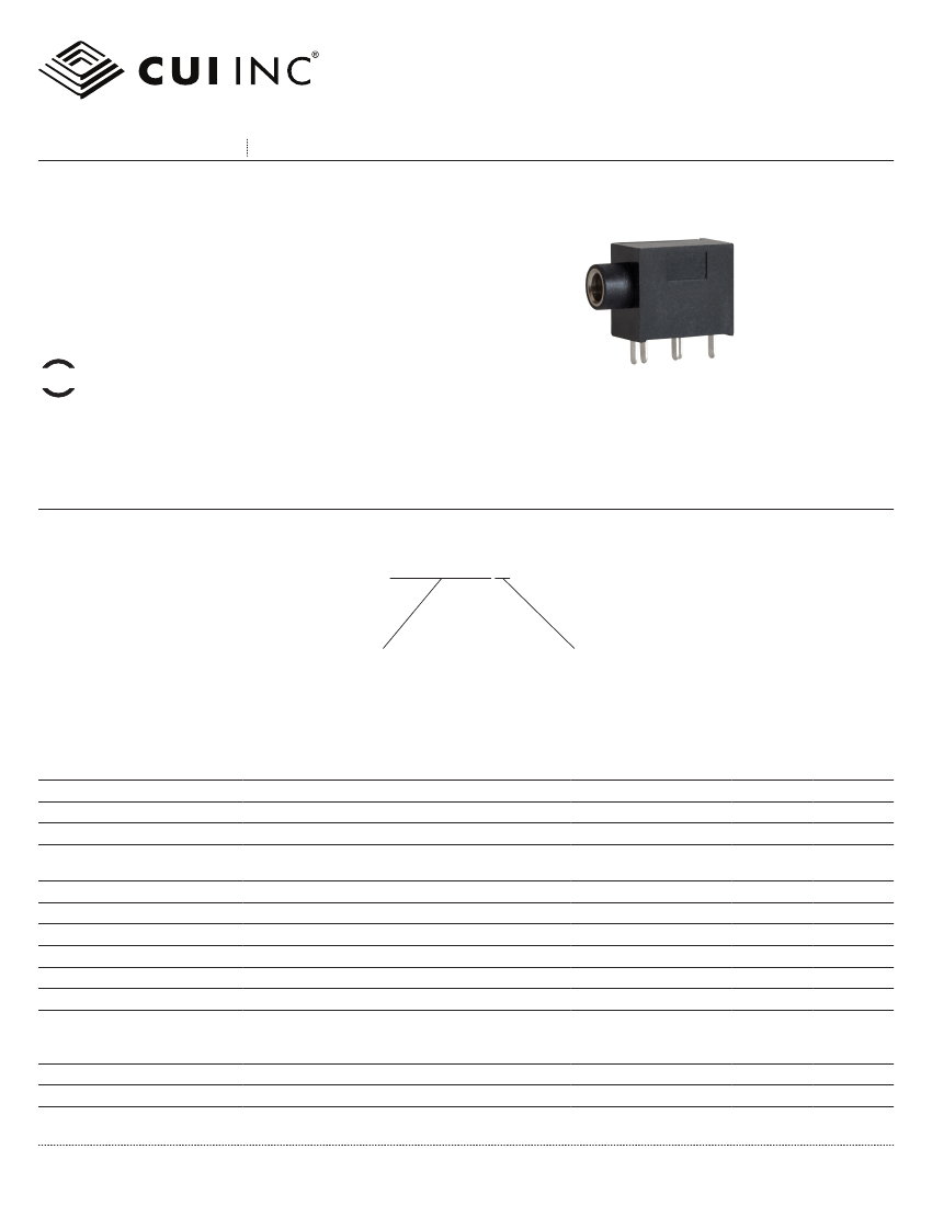

SERIES:
SJ1-353XNG
• low profile design
• switch options include:
– no switch
– tip switch
– tip and ring switch
DESCRIPTION:
3.5 MM AUDIO JACKS
RoHS
PART NUMBER KEY
SJ1 - 353
X
NG
Base Number
Switch Options
3 = no switch
4 = tip switch
5 = tip and ring switch
