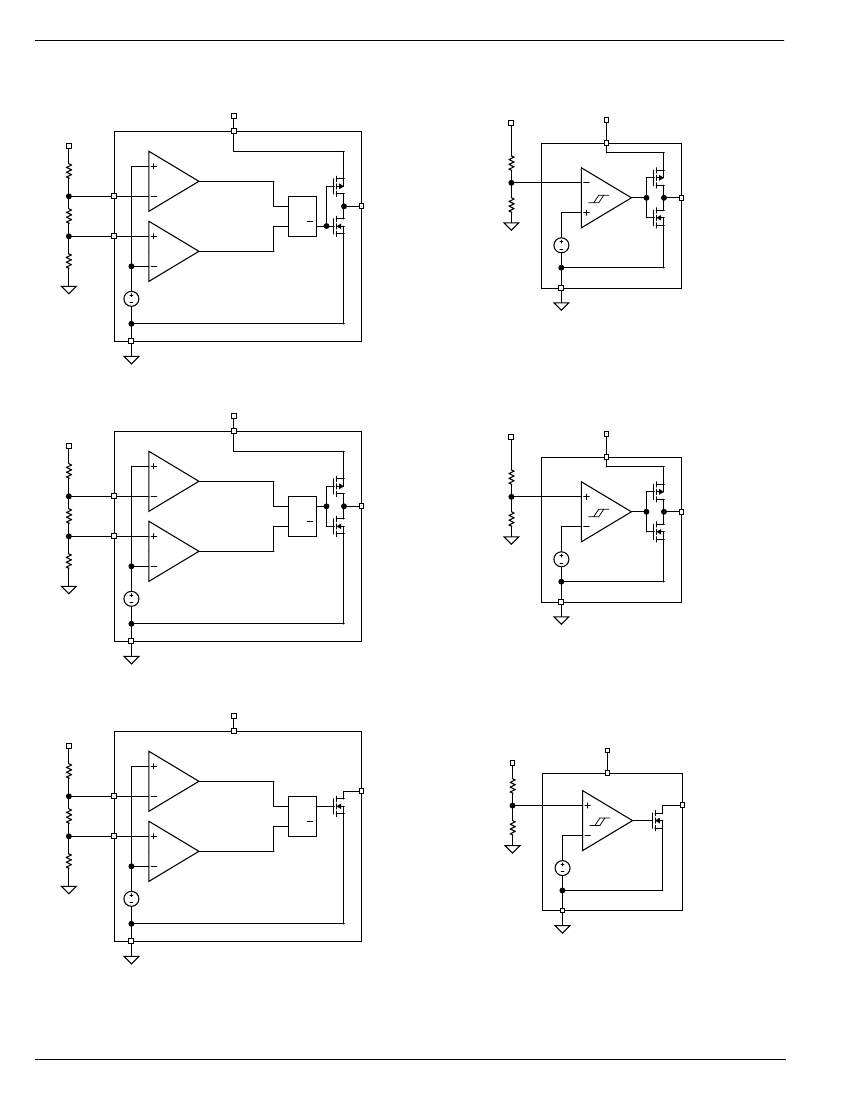

Block Diagrams
DD
IN
DD
VDD
VDD
IN
Low-Voltage
Detect
INP
High-Voltage
Detect
OUT
LTH
LTH
TH
R Q
High-Voltage
Detect
OUT
HTH
HTH
S Q
1.24V
Bandgap
Reference
MIC842H
1.24V
Bandgap
Reference
MIC841H
GND
GND
DD
VDD
IN
DD
IN
Low-Voltage
Detect
LTH
LTH
VDD
INP
High-Voltage
Detect
OUT
R Q
High-Voltage
Detect
OUT
TH
HTH
HTH
S Q
1.24V
Bandgap
Reference
1.24V
Bandgap
Reference
MIC841L
MIC842L
GND
GND
DD
VDD
IN
DD
IN
Low-Voltage
Detect
LTH
LTH
VDD
OUT
R Q
High-Voltage
Detect
S Q
INP
TH
High-Voltage
Detect
OUT
HTH
HTH
1.24V
Bandgap
Reference
1.24V
Bandgap
Reference
MIC841N
MIC842N
GND
GND

Programming the MIC842 Thresholds
The voltage threshold is calculated using:
R1
R2
IN(lo)
REF
R2
where:
REF
1.240V
IN
In order to provide the additional criteria needed to solve for
the resistor values, the resistors can be selected such that
they have a given total value, that is, R1 + R2 + R3 = R
TOTAL
A value such as 1MΩ for R
TOTAL
is a reasonable value
because it draws minimum current but has no significant
effect on accuracy.
IN
DD
MIC842
R1
470k
VDD
INP
OUT
GND
OUT
R2
R1
604k
1%
56k
1%
340k
1%
MIC841
VDD
LTH
HTH
OUT
GND
470k
OUT
Figure 2. Example Circuit
they have a given total value, that is, R1 + R2 = R
TOTAL
. A
TOTAL
is a reasonable value because
it draws minimum current but has no significant effect on
accuracy.
Input Transients
The MIC841/2 is inherently immune to very short negative-
going “glitches.” Very brief transients may exceed the V
IN(lo)
threshold without tripping the output.
R2
R3
Figure 1. Example Circuit
Once the desired trip points are determined, set the V
IN(hi)
threshold first.
For example, use a total of 1MΩ = R1 + R2 + R3. For a typical
single-cell lithium ion battery, 3.6V is a good “high threshold”
because at 3.6V the battery is moderately charged. Solving
for R3:
