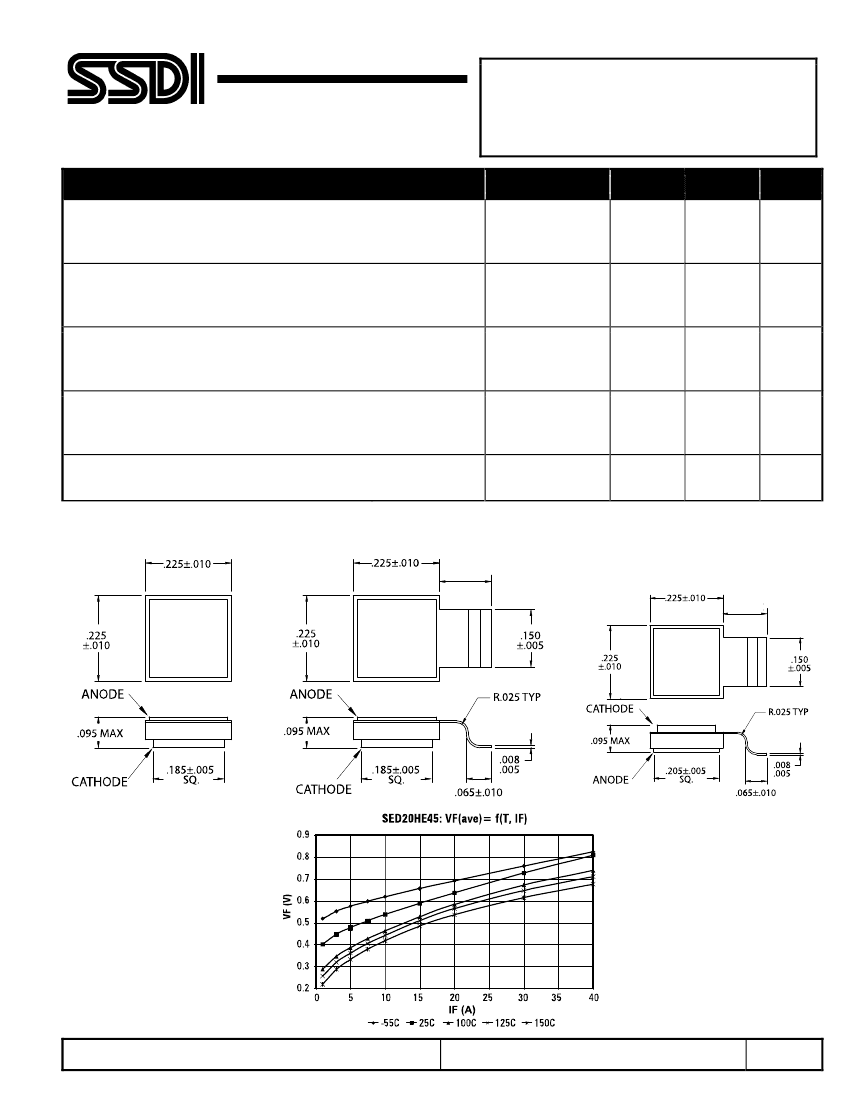

Solid State Devices, Inc.
14701 Firestone Blvd. * La Mirada, Ca 90638
Phone: (562) 404-4474 * Fax: (562) 404-1773
ssdi@ssdi-power.com * www.ssdi-power.com
SED20HB45, SED20HE45
and SED20HF45
20 AMP
45 VOLTS
SCHOTTKY RECTIFIER
FEATURES:
Low Reverse Leakage
Low Forward Voltage Drop
Hermetically Sealed Power Surface
Mount Package
Guard Ring for Overvoltage Protection
Eutectic Die Attach
175
o
C Operating Temperature
TX, TXV, and Space Level Screening
Available
2/
RRM
RWM
O
FSM
OP
& T
stg
SED20HB45
SED20HE45
SED20HF45
JC
Designer’s Data Sheet
Part Number / Ordering Information
1/
SED20 __ 45 __
½
½
½
½
Screening
2/
= None
TX = TX Level
TXV = TXV Level
S = S Level
Configuration
HB = without lead
HE = with lead
HF = with lead, reverse polarity
MAXIMUM RATINGS
Peak Repetitive Reverse Voltage
and DC Blocking Voltage
Average Rectified Forward Current
(Resistive Load, 60 Hz, Sine Wave, T
= 100
o
C)
Peak Surge Current
(8.3 ms Pulse, Half Sine Wave, 1 pulse, T
= 25
o
C)
Operating and Storage Temperature
Maximum Thermal Resistance
Junction to Case
Value
45
250
-55 to +175
1.25
1.25
3.00
Units
Volts
Amps
Amps
o
o
C/W
Notes:
1/ For Ordering Information, Price, Operating Curves, and Availability –
Contact Factory.
2/ Screening based on MIL-PRF-19500. Screening flows available on request.
SEDPACK 1
HB Series
HE / HF Series
NOTE:
All specifications are subject to change without notification.
SCD's for these devices should be reviewed by SSDI prior to release.
DATA SHEET #: RSED49C
DOC
