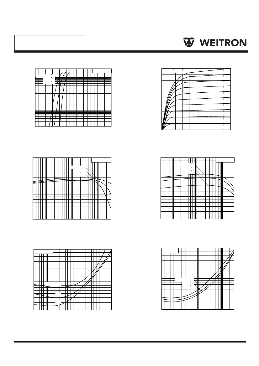

ELECTRICAL CHARACTERISTIC CURVES
C E
=-3V
-0.5
T a=25 C
-2 .5 mA
C OLLE C TOR C UR R E NT : I
(mA)
-1000
-500
-200
-100
-50
-20
-10
-5
-2
-1
T a=100 C
25 C
40 C
C OLLE C T OR
C UR R E NT : I
(A)
-2 .2 5mA
-2 mA
-1 .75 mA
-0.4
-0.3
-1 .5mA
-1 .25 mA
-1mA
-0.2
-75 0 A
-500 A
-0.1
-250 A
-0.2 -0.4 -0.6 -0.8 -1.0 -1.2 -1.4 -1.6 -1.8 -2.0 -2.2
B AS E T O E MIT T E R V O L T AG E : V
B E
(V )
-0.4
-0.8
-1.2
=0A
-1.6
-2
C O LLE C T O R T O E MIT T E R V O LT AG E : V
C E
(V )
F IG .1 G rounded emitter propagation
characteris tics
T a =25 C
C E
=6V
3V
1V
F IG .2 G rounded emitter output
characteris tics
C E
=-3V
T a =100 C
25 C
25 C
DC C UR R E NT G AIN : h
FE
F E
-5
-10
-20
-50
-100
-200
-500 -1000 -2000
-5
-10
-20
-50
-100 -200
-500 -1000 -2000
C O L L E C T O R C UR R E NT : I
(mA)
(mA)
F IG .3 DC current gain vs .
collector current
C OLLE C TOR S ATUR ATION VOLTAG E : V
C E (sat)
(mV)
F IG .4 DC current gain vs .
collector current
-500
l
/l
=10
C OLLE C TOR S ATUR ATION VOLTAGE : V
C E (sat)
(mV)
-500 T a =25 C
-200
-200
-100
-100
/I
=50
-50
T a =100 C
25 C
40 C
-50
-5
-10
-20
-50
-100 -200
-500 -1000 -2000
-20
-5
-10
-20
-50 -100 -200
-500 -1000 -2000
(mA)
C O LLE C T O R C UR R E NT : I
(mA)
F IG .5 C ollector-emitter s aturation
voltage vs . collector current
F IG .6 C ollector-emitter s aturation
