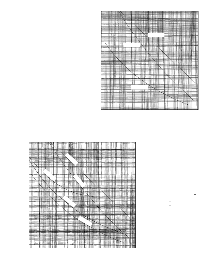

• ZENER DIODE CHIPS
• ALL JUNCTIONS COMPLETELY PROTECTED WITH SILICON DIOXIDE
• ELECTRICALLY EQUIVALENT TO 1N5221B THRU 1N5272B
• 0.5 WATT CAPABILITY WITH PROPER HEAT SINKING
• COMPATIBLE WITH ALL WIRE BONDING AND DIE ATTACH TECHNIQUES,
WITH THE EXCEPTION OF SOLDER REFLOW

BACKSIDE IS CATHODE
FIGURE 1
DESIGN DATA
METALLIZATION:
Top: (Anode)......................Al
Back: (Cathode)................Au
AL THICKNESS..............25,000
Å
Min
GOLD THICKNESS...
.......4,000
Å
Min
CHIP THICKNESS.............
.......10 Mils
CIRCUIT LAYOUT DATA:
For Zener operation, cathode
must be operated positive with
respect to anode.
TOLERANCES:
ALL
Dimensions + 2 mils
22 COREY STREET, MELROSE, MASSACHUSETTS 02176
PHONE (781) 665-1071
FAX (781) 665-7379
WEBSITE: http://www.cdi-diodes.com
E-mail: mail@cdi-diodes.com
