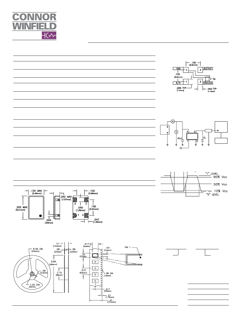

5.0V HCMOS Surface Mount
Crystal Clock Oscillator
7215, 7225, 7235
XO
2111 Comprehensive Drive
Aurora, Illinois 60505
Phone: 630- 851- 4722
Fax: 630- 851- 5040
Fax: 630- 851- 5040
www.conwin.com
www.conwin.com
Features:
The Connor-Winfield models 7215,
7225, and 7235 are a 5 x 3.2mm, 5.0V HCMOS,
Surface Mount, Fixed Frequency Crystal
Oscillators (XO) designed for use in all
applictions requiring precision clocks. The RoHS
compliant, surface mount package is designed
for high-density mounting and is optimum for
mass production.
1.8 to 50 MHz
5.0V Operation
RoHS Compliant
Tri-State Enable / Disable Function
Overall Frequency Tolerance:
7215 ± 25 ppm
7225 ± 50 ppm
7235 ± 100 ppm
Temperature Range: -40 to 85°C
Ceramic Surface Mount Package
Tape and Reel Packaging
US Headquarters:
630-851-4722
European Headquarters:
+353-61-472221
Absolute Maximum Ratings
Storage Temperature
Supply Voltage (Vcc)
Minimum
-55
-0.5
Nominal
Maximum
125
7.0
Units
Vdc
Notes
Operating Specifications
Frequency Range (Fo)
Frequency Tolerance
7215
7225
7235
Operating Temp Range
Supply Voltage (Vdd)
Supply Current (Icc)
Minimum
1.8
-25
-50
-100
-40
4.5
Nominal
5.0
Maximum
85
5.5
45
Units
MHz
ppm
Notes
Vdc
Input Characteristics
Enable Voltage - (Vih)
Disable Voltage - (Vil)
Enable Time
Disable Time
Minimum
2.2
Nominal
Maximum
0.8
Units
Vdc
Vdc
nS
nS
Notes
HCMOS Output Characteristics
Load
(Voh)
Voltage High (Vol)
Low
(loh)
Current High (lol)
Low
Duty Cycle at 50% of Vcc
Rise / Fall Time 10% to 90%
Start-Up Time
Jitter
Bulletin
Page
Revision
Date
Minimum
4.50
-16
Nominal
Maximum
0.55
Units
pF
Vdc
nS
mS
pS RMS
Notes
Sm089
1 of 2
01
20 June 2002
Notes:
1. Inclusive of calibration @ 25°C , frequency vs temperature stability, supply voltage change, load change, shock and vibration, 10 years aging.
2. Oscillator output is enabled with no connection on pad 1
Specifications subject to change without notice. All dimensions in inches. © Copyright 1998 The Connor-Winfield Corporation
