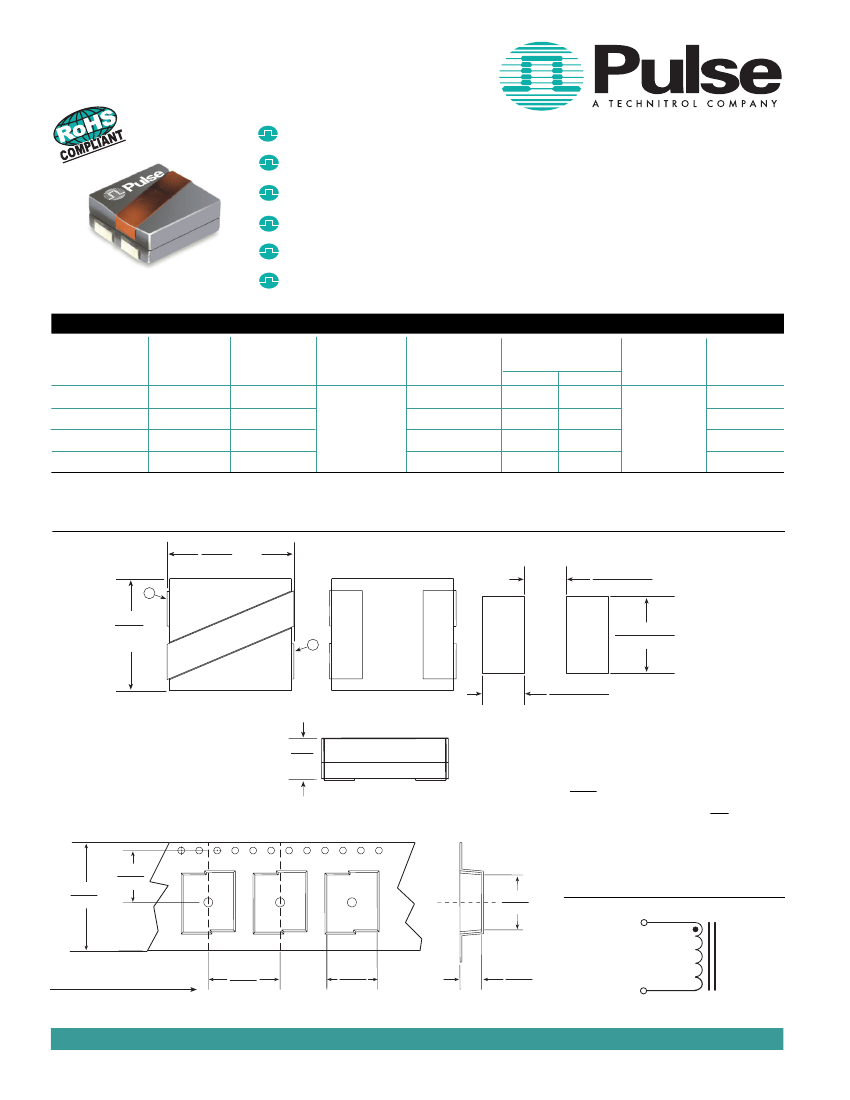

SMT POWER INDUCTORS
Flat Coils - PG0437NL Series
Height:
4.5mm Max
Footprint:
12.5mm x 11.0mm Max
Peak Current Rating:
up to 39A
Frequency Range:
100kHz to 1MHz
Ferrite Core:
No thermal ageing, very low core losses
Patent Pending
Electrical Specifications @ 25°C — Operating Temperature -40°C to +130°C
Part
Number
PG0437.321NL
PG0437.401NL
PG0437.451NL
PG0437.601NL
Inductance
@Irated
(nH TYP)
362
390
530
Irated
(A)
33
28
26
DCR
(mΩ ±10%)
Inductance
@0A
DC
(nH ±20%)
320
Saturation
Current Isat
(A TYP)
25°
100°
39
31
28
21
33
28
26
Heating
Current I
DC
(A TYP)
Core Loss
Factor
K2
43.5
0.85
450
600
38
54.3
61.2
81.5
Mechanical
.492
MAX
12,50
a
XXXNL
.177 ± .005
4,50 ± 0,12
.327 ± .005
8,30 ± 0,12
.177 ± .005
4,50 ± 0,12
SUGGESTED PAD LAYOUT
.177
4,50
MAX
Weight......................2.3
grams
Tape & Reel
................750/reel
Dimensions:
Inches
mm
Unless otherwise specified, all tolerances are ± .010
0,25
.433
11,00
MAX
Date Code
b
PATENT
PENDING
TAPE & REEL LAYOUT
.453
11,50
.945
24,00
Schematic
.480
12,20
USER DIRECTION OF FEED
.630
16,00
.441
11,20
.189
4,80
USA 858 674 8100
Germany 49 7032 7806 0
Singapore 65 6287 8998
Shanghai
86 21 54643211 / 2
China 86 755 33966678
Taiwan 886 3 4641811
www.pulseeng.com
58
SPM2007 (11/07)
