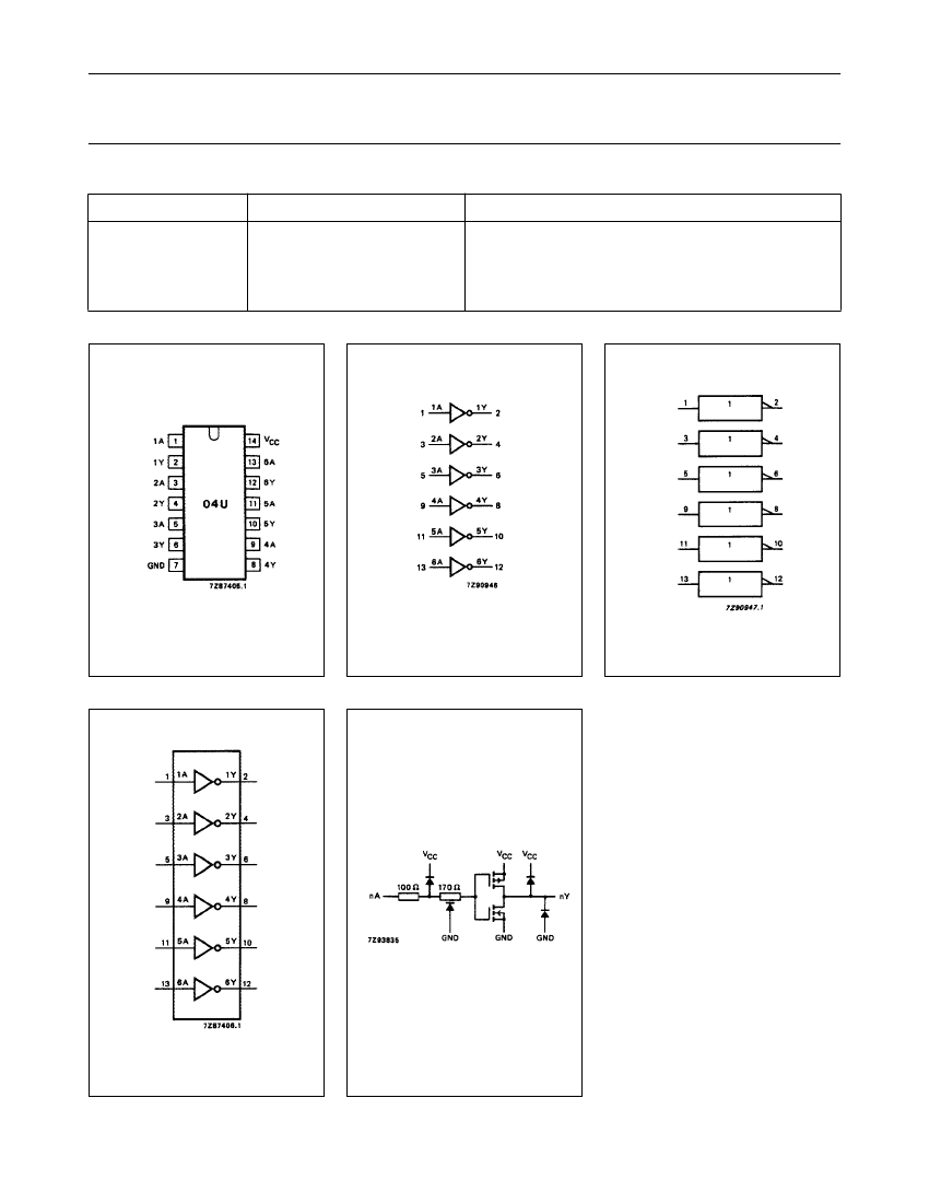

PIN DESCRIPTION
PIN NO.
1, 3, 5, 9, 11, 13
2, 4, 6, 8, 10, 12
1A to 6A
1Y to 6Y
GND
CC
SYMBOL
data inputs
data outputs
ground (0 V)
positive supply voltage
74HCU04
NAME AND FUNCTION
Fig.1 Pin configuration.
Fig.2 Logic symbol.
Fig.3 IEC logic symbol.
Fig.4 Functional diagram.
Fig.5
Schematic diagram
(one inverter).

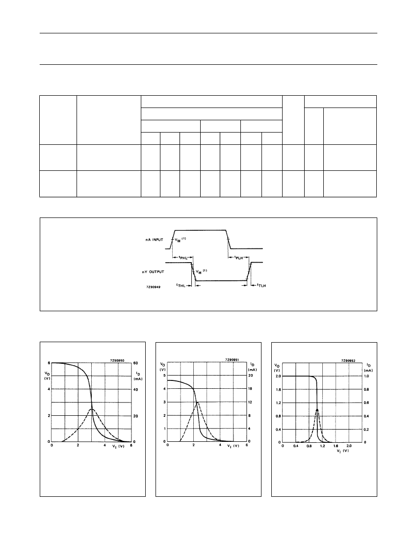

AC CHARACTERISTICS FOR 74HCU
GND = 0 V; t
r
= t
f
= 6 ns; C
= 50 pF
amb
(°C)
74HCU
SYMBOL
PARAMETER
+25
min.
PHL
/ t
PLH
propagation delay
nA to nY
output transition time
typ.
19
19
-40 to +85
max. min. max.
75
90
95
19
−40
to +125
min.
max.
105
21
110
22
19
ns
2.0
4.5
6.0
2.0
4.5
6.0
UNIT
CC
(V)
74HCU04
TEST CONDITIONS
WAVEFORMS
Fig.6
THL
/ t
TLH
ns
Fig.6
AC WAVEFORMS
(1) V
M
= 50%; V
= GND to V
CC
Fig.6 Waveforms showing the data input (nA) to data output (nY) propagation delays and the output transition times.
TYPICAL TRANSFER
CHARACTERISTICS
Fig.7
_____ V
O;
_ _ _ _ I
(drain current);
O
= 0; V
CC
= 6.0 V.
Fig.8
______ V
O
_ _ _ _ I
(drain current);
O
= 0; V
CC
= 4.5 V.
Fig.9
_____ V
O
_ _ _ _ I
(drain current);
O
= 0; V
CC
= 2.0 V.
September 1993
