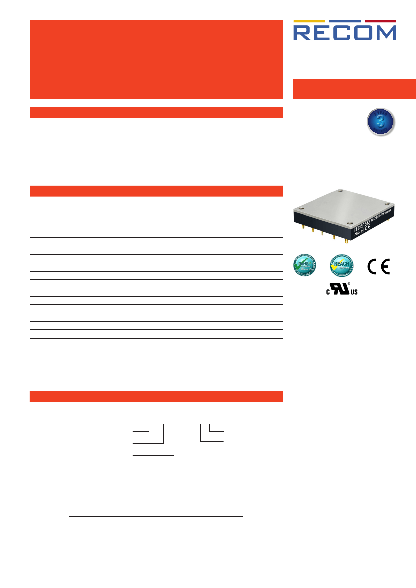

DC/DC Converter
RP240H-RW
The half-brick RP240H series DC/DC converters are designed for railway rolling stock and high voltage battery ap-
plications. Each series has three 4:1 input voltage range options to cover all input voltages from 9VDC up to 160VDC
with isolated and regulated 5V to 48VDC outputs. The converters have high efficiencies and metal baseplates to
permit a wide operating temperature range from -40°C to +85°C (when mounted on a suitable heatsink). The case
is fitted with threaded inserts to allow secure mounting to the PCB or bulkhead for use in high shock and vibration
environments. The converters are EN50155, UL60950 and IEC/EN60950 certified. The RP240H-RW series have a
three year warranty.
240 Watt
Half Brick
Single Output
3Y
wa
EAR
rranty

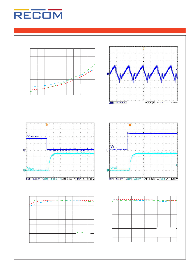

RP240H-2405SRW
Power Dissipation vs. Output Current
36
24
9Vin
24Vin
36Vin
90
Typical Output Ripple and Noise/full load
Specifications
measured @ta = 25°C, resistive load, nominal Vin and rated Iout unless otherwise noted
Power Dissipation [W]
Output Current [%]
ON/OFF Control Start up Rise Characteristic
Power up Start-up Rise Characteristic

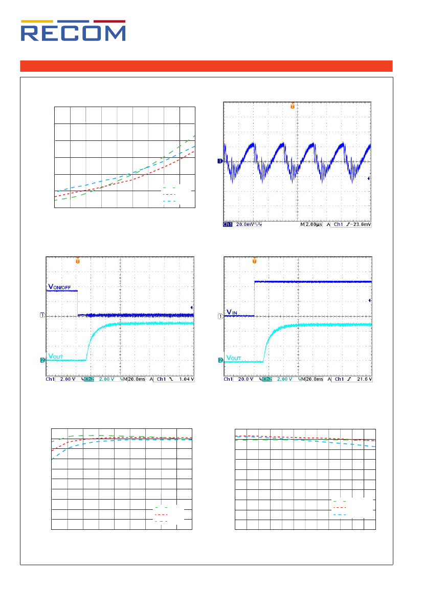

RP240H-4805SRW
36
Specifications
24
16.5Vin
48Vin
75Vin
90
Output Current [%]

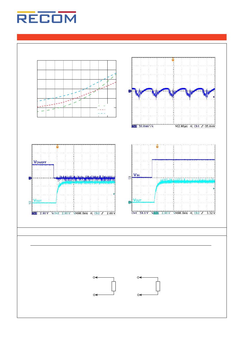

RP240H-11005SRW
36
Specifications
24
43Vin
110Vin
160Vin
90
Output Current [%]
OUTPUT TRIM
Output Voltage Trimming
RP240H-RW converters offer the feature of trimming the output voltage over a certain range around the nominal value by using external trim
resistors. The values for trim resistors shown in trim tables below are according to standard E96 values; therefore, the specified voltage may
slightly vary; they also can be calculated with below shown equation.
TRIM UP
TRIM
+Sense
TRIM
-Sense
TRIM DOWN
