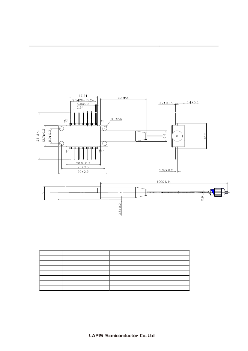

1. DESCRIPTION
OLx109L-10 Series are Laser Diode in Butterfly package with SMF.
Rev. 5 [12. 2011]
Preliminary
10mW Laser Diode Butterfly Modules with Single Mode Fiber, Built in Cooler, Isolator.

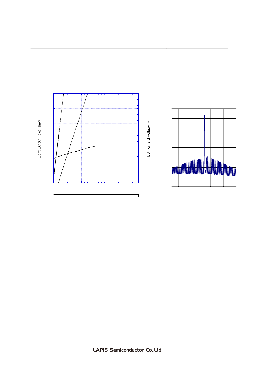

4.OPTICAL AND ELECTRICAL CHARACTERISTICS
(T
LD
= 25°C, unless otherwise specified)
Threshold Current
Operation Current
LD Forward Voltage
Peak Wavelength
Spectral Width
Side Mode Suppression Ratio
Isolation
Rise Time
Fall Time
Photo Dark Current
Monitor Current
PD Capacitance
Cooler Capacity
Cooler Current
Cooler Voltage
Thermistor Resistance
Ith
Iop
Vfl
λp
∆λ
SMSR
τr
τf
Im
Ct
∆T
Ic
Vc
Rth
Test Conditions
CW
Pf=10mW,CW
OL5109L-10A
Pf=10mW
OL6109L-10A
,CW
OL6109L-10B
Pf=10mW, CW, -20dB
Pf=10mW, CW
Tc=-5 to 70°C
Ibias=Ith,
Pf=10mW, 10-90%
Vrd=5V
Pf=10mW, CW, Vrd=5V
Vrd=5V, f=1MHz
Pf=10mW
∆T=45°C,
Pf=10mW
Tthm=25°C
Min.
1505
1620
1645
45
9.5
Typ.
1510
1625
1650
Max.
1515
1630
1655
1.2
2.4
10.5
nm
nm
nm
nm
dB
dB
ns
ns
µA
µA
pF
kΩ
