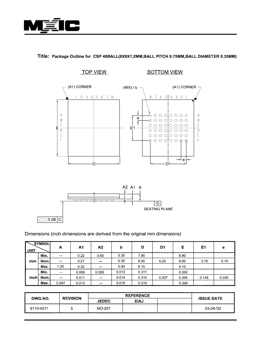

- 48 ball mini BGA (8.0mm X 9.0mm, ball pitch
0.75mm)

PACKAGE INFORMATION
P/N:PM0772
REV. 1.6, MAR. 28, 2003
