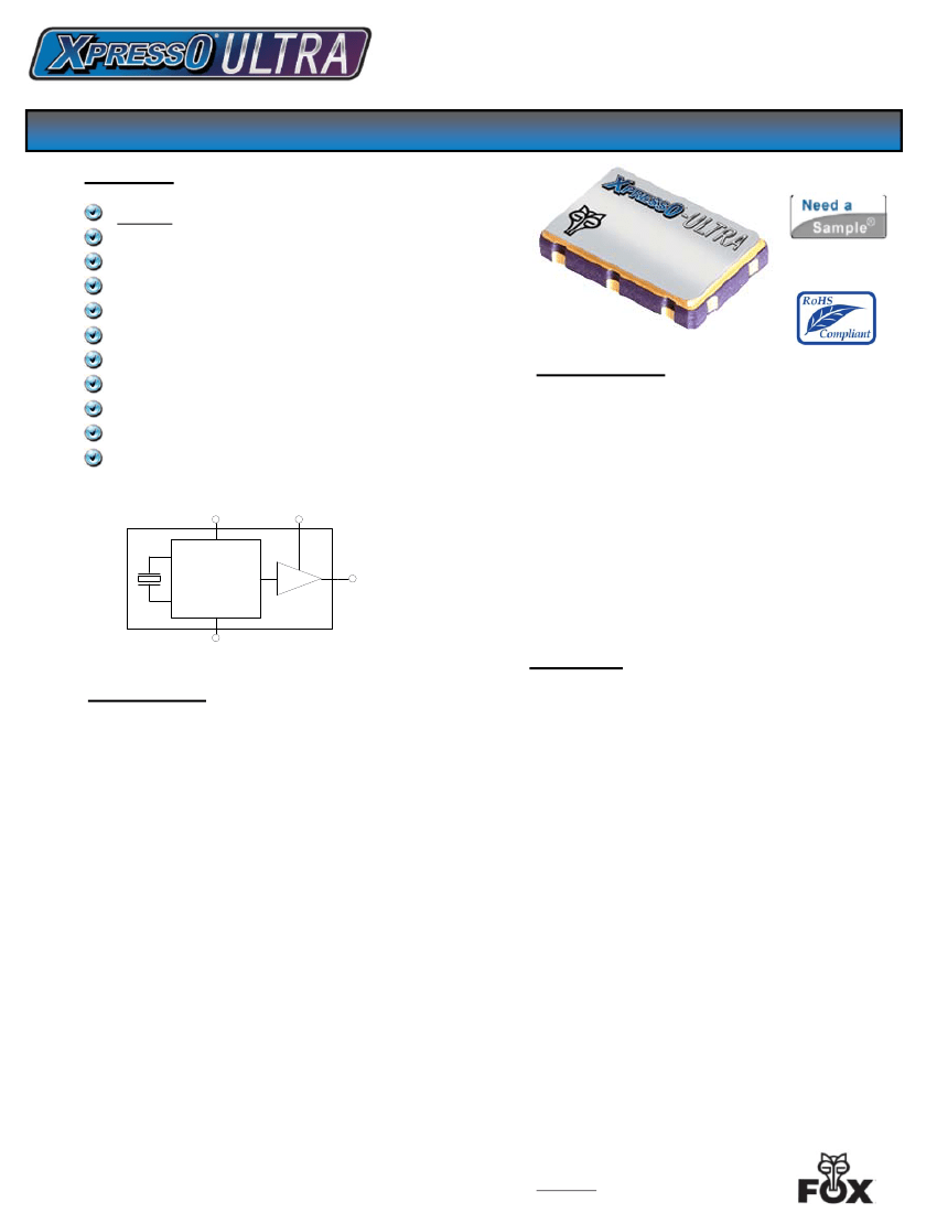

Model: FXU-PC51 SERIES
LVPECL
5 x 3.2mm 1.8V Oscillator
ULTRA Low Jitter
Low Cost
X
PRESS
Delivery
Frequency Resolution to six decimal places
Stabilities to ± 20 PPM
-20 to +70°C or -40 to +85°C operating temperatures
Tri-State Enable / Disable Feature
Industry Standard Package, Footprint & Pin-Out
Fully RoHS compliant
Gold over Nickel Termination Finish
Serial ID with Comprehensive Traceability

The Fox X
PRESS
O-ULTRA Crystal Oscillator is a
breakthrough in configurable Frequency Control
Solutions. X
PRESS
O-ULTRA utilizes a family of
proprietary ASICs, designed and developed by Fox,
with a key focus on noise reduction technologies.
The 4
th
order Delta Sigma Modulator reduces noise to
the levels that are comparable to traditional Bulk
Quartz and SAW oscillators. The ASICs family has
the ability to select the output type and supply
voltage.
With the X
PRESS
O-ULTRA lead-time, low cost, low
noise, wide frequency range, excellent ambient
performance, X
PRESS
O-ULTRA is an excellent choice
over the conventional technologies.
Finished X
PRESS
O-ULTRA parts are 100% final
tested.

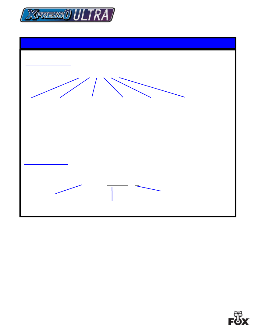

Model Selection Guide & Fox Part Number
STEP #1:
Customer selects the Model Description and provides to Fox Customer Service
Model Description
FXU – P C 5 1 5 R – 156.25
Frequency (in MHz)
Resolutions to 6 places
past the decimal point
LVPECL
= Ceramic
Q
LVPECL
(pin 2 E/D)
= 5 x 3.2mm
= 7 x 5mm
= 1.8V
= 2.5 V
= 3.3 V
= ± 100 PPM
blank
= -20°C to +70°C
= ± 50 PPM
= -40°C to +85°C
= ±25 PPM
= ±20 PPM
(-20°C to +70°C)
STEP #2:
The Fox Customer Service team provides a customer specific Part Number
for use on their Bill Of Materials (BOM).
Fox Part Number
(The assigned Fox Part Number must be on the BOM – not the above Model Description)
(This will ensure receipt of the proper part)
852B – 156.25 – 3
The 1
st
Field
Product Code #
852B = FXU–PC51
852E = FXU-QC51
The 3
rd
Field
Fox Internally Generated Number
The 2
nd
Field
The Customer’s Frequency
(If any specification changes,
the last digits change)
(The same specs for a different customer
also changes the last digits)
This example,
FXU-PC515R-156.25
= LVPECL Output, Ceramic, 5 x 3.2mm Package, 1.8V,
±50 PPM Stability, -40 to +85°C Temperature Range, at 156.25 MHz

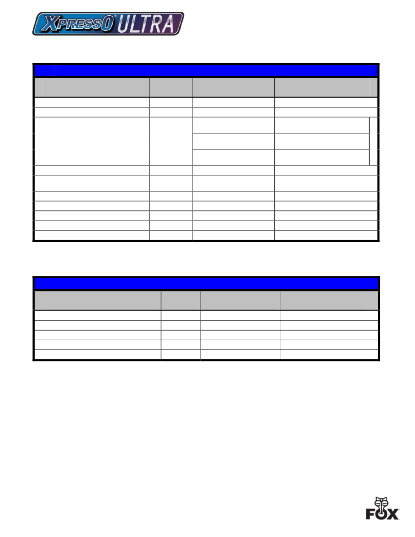

Electrical Characteristics
Parameters
Frequency Range
Frequency Stability
O
O
Condition
Maximum Value
(unless otherwise noted)
0.016 MHz to 670 MHz
100, 50, 25, 20
PPM
Standard operating
0.016 to 670 MHz
Optional operating
0.016 to 670 MHz
Storage
Standard
0.016 to 250 MHz
250+ to 670 MHz
Standard
-20°C to +70°C
-40°C to +85°C
-55°C to +125°C
1.8 V ± 5%
75 mA
97 mA
50 Ohms to GND Typ.
10 mS
100 nS
Au
Temperature Range
STG
Supply Voltage
Input Current
(@ Standard Load)
Output Load
Start-Up Time
Output Enable / Disable Time
Moisture Sensitivity Level
Termination Finish
DD
DD
MSL
JEDEC J-STD-020
Note 1 – Higher frequencies are available. Contact Fox Technical Support for details.
Note 2 - Stability is inclusive of 25°C tolerance, operating temperature range, input voltage change, load change, aging, shock and vibration
Note 3 –. ±20 PPM stability -20°C to +70°C only.
Absolute Maximum Ratings
(Useful life may be impaired.
Parameters
Input Voltage
Operating Temperature
Storage Temperature
Junction Temperature
ESD Sensitivity
For user guidelines only, not tested)
DD
AMAX
STG
HBM
Condition
Maximum Value
Human Body Model
–0.5V to +5.0V
–55°C to +85°C
–55°C to +125°C
125°C
1 kV

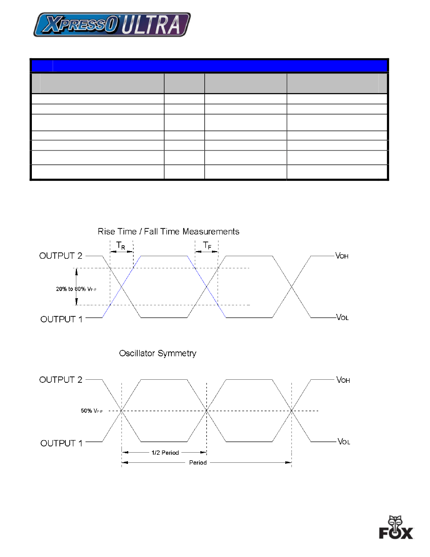

Output Wave Characteristics
Parameters
Low Output Voltage
High Output Voltage
Output Symmetry
@ 50% V
P-P
Level
(See Drawing Below)
Output Enable
Note1 (PIN # 1)
Voltage
Output Disable
Note1 (PIN # 1)
Voltage
Cycle Rise Time
(20%~80%V
P-P
- See Drawing Below)
OL
OH
Condition
0.016 to 670 MHz
0.016 to 670 MHz
0.016 to 670 MHz
Maximum Value
0V to 0.25V
0.5V to 0.8V
45% ~ 55%
70% V
DD
30% V
DD
IH
IL
0.016 to 670 MHz
0.016 to 670 MHz
350 pS
350 pS
Cycle Fall Time
(80%~20%V
P-P
Note1
An optional PIN # 2 as Enable / Disable is available – see Model Selection Guide (page 2)

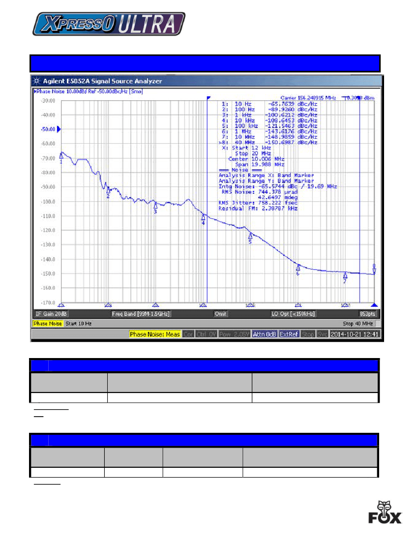

Phase Noise (typical measurements at 156.25 MHz)
Jitter is frequency dependent. Below are typical values at 156.25 MHz.
LVPECL Phase Jitter & Time Interval Error (TIE)
Frequency
156.25 MHz
Phase Jitter (pS)
(12kHz to 20MHz)
TIE (pS)
(sigma of jitter distribution)
0.75
2.5
Phase Jitter
is integrated from Agilent 5052A Signal Noise Analyzer; measured directly into 50 ohm input; V
DD
= 1.8V.
TIE
was measured on LeCroy SDA-6000A Digital Storage Scope, directly into 50 ohm input, with Amherst M1 software; V
DD
= 1.8V.
Per
MJSQ
spec (Methodologies for Jitter and Signal Quality specifications)
LVPECL Random & Deterministic Jitter Composition
Frequency
156.25 MHz
Random (Rj)
(pS RMS)
Deterministic (Dj)
(pS P-P)
Total Jitter (Tj)
(14 x Rj) + Dj
19.5
0.9
6.0
Rj and Dj
, measured on LeCroy SDA-6000A Digital Storage Scope, directly into 50 ohm input, with Amherst M1 software.
Per
MJSQ
