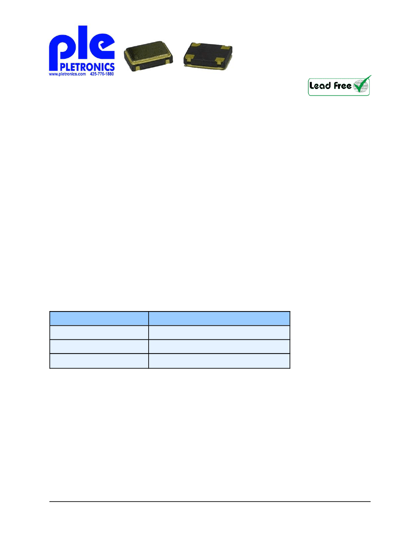

SM77D Series 1.8 V
CMOS Clock Oscillators
April 2010
• Pletronics’ SM77D Series is a quartz crystal
controlled precision square wave generator with a
CMOS output.
• The SM77D series will directly interface TTL
devices also.
• The package is designed for high density surface
mount designs.
• This is a low cost mass produced oscillator.
• Tape and Reel or cut tape packaging is available.
70 to 165 MHz
5 x 7 mm LCC Ceramic Package
Enable/Disable Function
Disable function includes low standby power
mode
• 3
rd
Overtone Crystals used
• Improved circuit to minimize oscillator issues
such as multi-mode output signal.
• Low Jitter
Capable of driving up to 15pF capacitive loads
Pletronics Inc. certifies this device is in accordance with the
RoHS 6/6 (2002/95/EC) and WEEE (2002/96/EC) directives.
Pletronics Inc. guarantees the device does not contain the following:
Cadmium, Hexavalent Chromium, Lead, Mercury, PBB’s, PBDE’s
Weight of the Device: 0.17 grams
Moisture Sensitivity Level: 1 As defined in J-STD-020C
Second Level Interconnect code: e4
