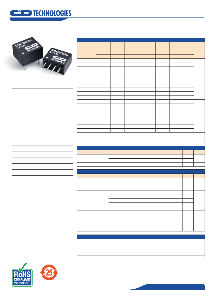

DESCRIPTION
The NME series of DC/DC Converters is particular-
ly suited to isolating and/or converting DC power
rails. The galvanic isolation allows the device to be
configured to provide an isolated negative rail in
systems where only positive rails exist. The wide
temperature range guarantees startup from –40°C
and full 1 watt output at 85°C. For lower ripple,
refer to output ripple reduction section.

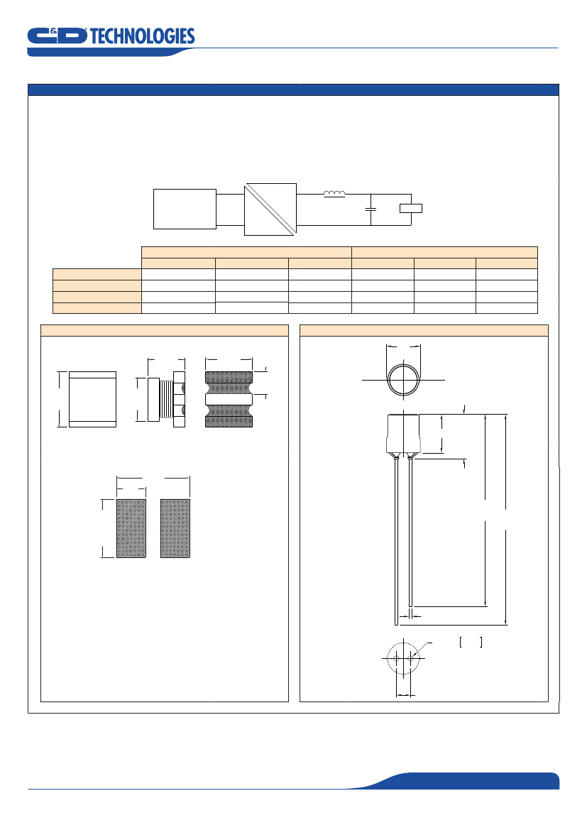

OUTPUT RIPPLE REDUCTION
By using the values of inductance and capacitance stated, the output ripple at the rated load is lowered to 5mV p-p max.
Component selection
Capacitor: Ceramic chip capacitors are recommended. It is required that the ESR (Equivalent Series Resistance) should be as low as possible, X7R types are recommended.
The voltage rating should be at least twice (except for 15V output), the rated output voltage of the DC/DC converter.
Inductor: The rated current of the inductor should not be less than that of the output of the DC/DC converter. At the rated current, the DC resistance of the inductor should be
such that the voltage drop across the inductor is <2% of the rated voltage of the DC/DC converter. The SRF (Self Resonant Frequency) should be >20MHz.
Power
Source
DC
DC
Inductor
Through Hole
22R103C
22R473C
22R683C
22R104C
Load
5V output types
9V output types
12V output types
15V output types
L, µH
47
68
SMD
82103C
82473C
82683C
82104C
C, µF
4.70
1.00
0.47
0.47
Capacitor
Size
1206
1206
0805
0805
V rating, V
SMD option 8200 Inductor Series Mechanical Dimensions
2.0 (0.080)
±0.3 (0.012)
2.5 (0.098)
±0.2 (0.008)
Through hole option 2200R Inductor Series Mechanical Dimensions
0.283±0.020
(7.2±0.50)
3.81 (0.15)
1.52
(0.060)
332C
3.2 (0.126)
±0.3 (0.012)
2.5 (0.0984)
±0.2 (0.008)
0.7
(0.028)
Min.
103C
3.05 (0.120)
0.335±0.020
(8.5±0.50)
Recommended pad layout
1.75 (0.069)
Direction of unreeling
3.81 (0.15)
1.52
(0.060)
(0.0
4.0
(0.157)
5.50
(0.217)
12.0 (0.472)
1.614±0.130
(41.00±3.30)
59)
332
332
332
0.413 (10.50) Max.
3.05 (0.120)
0.6 (0.024)
2.4 (0.095)
0.024±0.002
(0.60±0.05)
Recommended footprint
Ø0.047
+0.006
+0.15
Ø1.20
-0.000
-0.00
4)
95)
All dimensions in inches (mm).

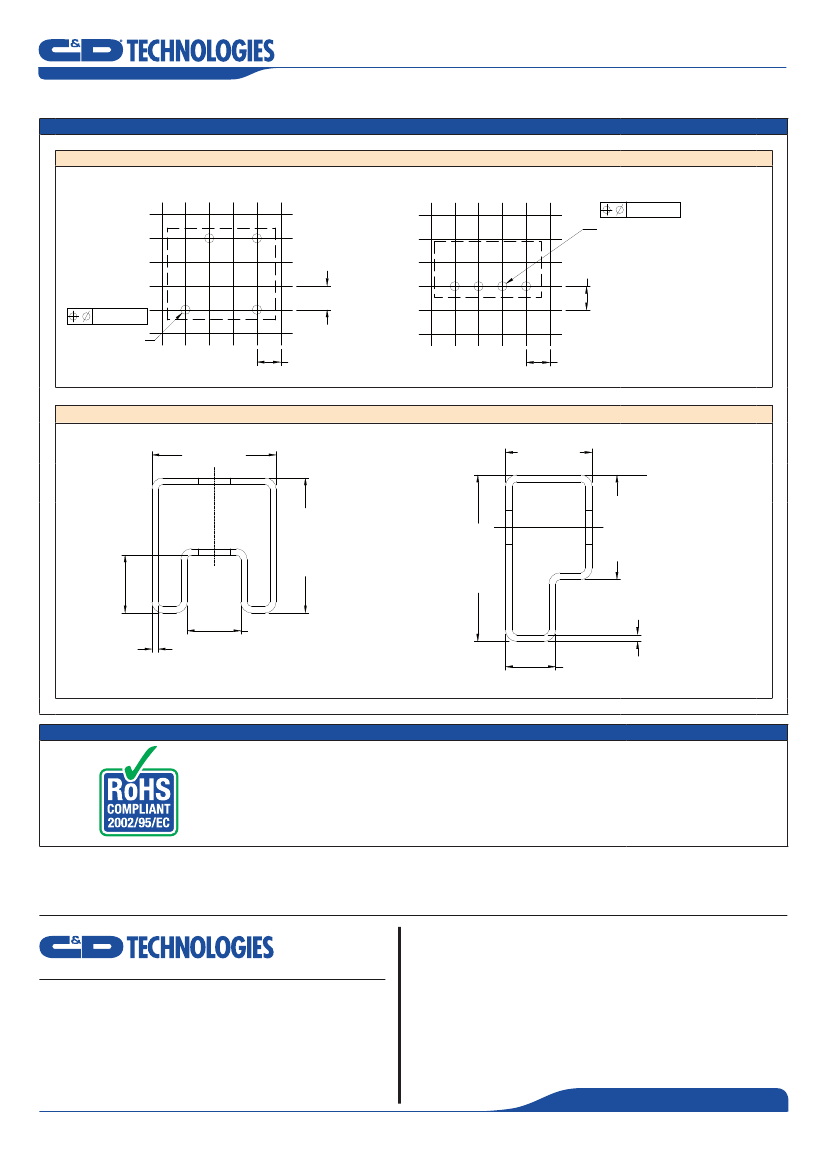

PACKAGE SPECIFICATIONS
MECHANICAL DIMENSIONS
DIP Package
SIP Package
PIN CONNECTIONS - 8 PIN DIP
Pin
Function
-V
IN
+V
IN
+V
OUT
-V
OUT
PIN CONNECTIONS - 4 PIN SIP
Pin
Function
-V
IN
+V
IN
-V
OUT
+V
OUT
All dimensions in inches ±0.01 (mm ±0.25mm). All pins on a 0.1 (2.54) pitch and within ±0.01 (0.25) of true position.
Weight: 1.30g (SIP) 1.48g (DIP)
D C / D C
C O N V E R T E R S
KDC_NMEC.E02
Page 4 of 5
www.cd4power.com
Technical enquiries
email: mk@cdtechno.com, tel:
+44 (0)1908 615232
POWER ELECTRONICS DIVISION
NME 5V & 12V SERIES
Isolated 1W Single Output DC/DC Converters
PACKAGE SPECIFICATIONS (continued)
RECOMMENDED FOOTPRINT DETAILS
8 Pin DIP Package
4 Pin SIP Package
TUBE OUTLINE DIMENSIONS
8 Pin DIP Tube
4 Pin SIP Tube
Unless otherwise stated all dimensions in inches (mm) ±0.5mm.
Tube length (8 Pin DIP) : 20.47 (520mm ±2mm).
Tube length (4 Pin SIP) : 20.47 (520mm ±2mm).
Tube Quantity : 35
