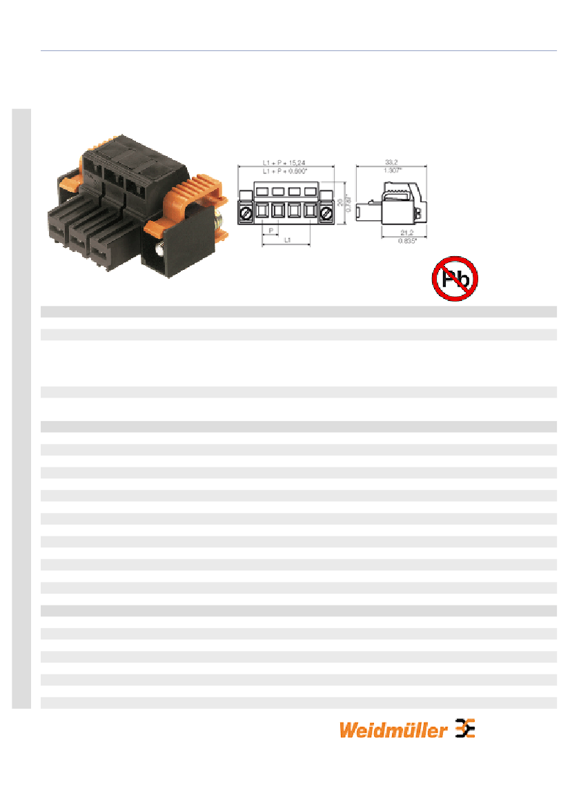

1853280000
BVZF 7.62/11SF SW
PCB plug-in connector, Female connectors,
Tension clamp connection, Clamping range, max.:
6 mm², Pitch: 7.62 mm, No. of poles: 11, 180°,
Box
4032248388004
50 pc(s).
180°
7.62 mm
0.3 inch
0.8 x 4.0
DIN 5264-A
M 2.5
8 mm
76.2 mm
3 inch
IP 20
Safe from finger touch
PBT
black
Similar to RAL 9011
IIIa
V-0
>= 200
Copper alloy
tinned
