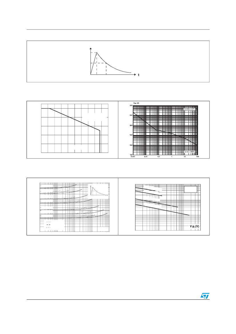

Figure 2.
Pulse definition for electrical characteristics
% Ipp
Repetitive pulse current
tr = rise time (µs)
tp = pulse duration time (µs)
1.5KE
tr
tp
Figure 3.
Peak pulse power dissipation
versus initial junction temperature
(printed circuit board)
Figure 4.
Peak pulse power versus
exponential pulse duration
100%
80%
Peak power
(on printed circuit)
60%
40%
20%
Tj initial
0%
100 120 140
160
180 200
Figure 5.
Clamping voltage versus peak
pulse current
Figure 6.
Capacitance versus reverse applied
voltage for unidirectional types
(typical values)
1. 5K E
1.5KE
1000
vcl (v)
1.5KE440A
% Ipp
Tj initial = 25°C
C (pF)
10000
1.5KE220A
7V 5
68
1 00
Tj = 25 °C
F = 1 MHz
1.5KE100A
tr
tp
tr <10µs
1.5KE56A
1. 5K E
1000
1. 5 K E
1.5KE22A
1.5KE12A
1.5KE6V8A
tp = 20 µs
tp = 1 ms
tp = 10 ms
0.1
Ipp (A)
1000
The curves of
Figure 5
are specified for a junction temperature of 25 °C before surge. The
given results may be extrapolated for other junction temperatures by using the following
formula:
ΔV
BR
αT ×
(Tamb - 25)
BR
(25 °C).
For intermediate voltages, extrapolate the given results.
4/10
Doc ID 2913 Rev 4

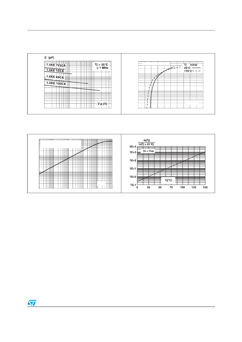

Figure 7.
Capacitance versus reverse applied Figure 8.
voltage for bidirectional types
(typical values)
Peak forward voltage drop versus
peak forward current (typical values
for unidirectional types)
10000
IFM (A)
Multiply by 2 for units with V
BR
> 220 V
1000
VFM (V)
2.5
3.5
4.5
Figure 9.
Transient thermal impedance
junction-ambient versus pulse
duration
Figure 10. Relative variation of leakage
current versus junction
temperature
Zth (j-a) (°C/W)
Epoxy printed circuit board, FR4
copper thickness = 35 µm
tp (s)
0.1
0.01
0.1
1000
Doc ID 2913 Rev 4
5/10
