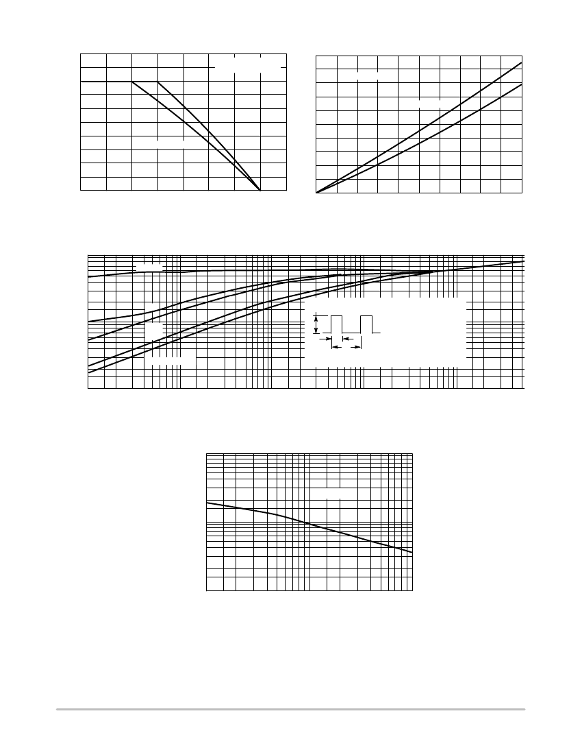

Figure 1. Typical Forward Voltage, Per Leg
Figure 2. Typical Reverse Current, Per Leg*

Figure 3. Current Derating Case, Per Leg
r(t), TRANSIENT THERMAL RESISTANCE (NORMALIZED
D = 0.5
Figure 4. Power Dissipation, Per Leg

Figure 5. Thermal Response
1K
C, CAPACITANCE (pF)
= 25°C
, REVERSE VOLTAGE (V)
Figure 6. Typical Capacitance, Per Leg
