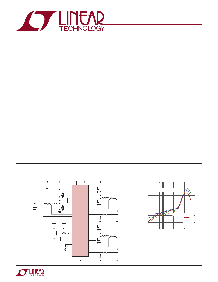

LTC3899
60V Low I
Q
, Triple
Output, Buck/Buck/Boost
Synchronous Controller
DESCRIPTION
The
LTC
3899
is a high performance triple output (buck/
buck/boost) DC/DC switching regulator controller that
drives all N-channel synchronous power MOSFET stages.
The constant frequency current mode architecture allows
a phase-lockable frequency of up to 850kHz. The LTC3899
operates from a wide 4.5V to 60V input supply range.
When biased from the output of the boost converter or
another auxiliary supply, the LTC3899 can operate from
an input supply as low as 2.2V after start-up.
The gate drive for the LTC3899 can be programmed from
5V to 10V to allow the use of logic-level or standard-level
FETs and to maximize efficiency. Internal switches in the
top gate drivers eliminate the need for external bootstrap
diodes. The 29μA no-load quiescent current extends op-
erating run time in battery-powered systems. OPTI-LOOP
compensation allows the transient response to be optimized
over a wide range of output capacitance and ESR values.

Dual Buck Plus Single Boost Synchronous Controllers
Wide Bias Input Voltage Range: 4.5V to 60V
Outputs Remain in Regulation Through Cold Crank
Down to a 2.2V Input Supply Voltage
Buck and Boost Output Voltages Up to 60V
Adjustable Gate Drive Level 5V to 10V (OPTI-DRIVE)
No External Bootstrap Diodes Required
Low Operating I
Q
: 29μA (One Channel On)
100% Duty Cycle for Boost Synchronous MOSFET
Phase-Lockable Frequency (75kHz to 850kHz)
Programmable Fixed Frequency (50kHz to 900kHz)
Very Low Dropout Operation: 99% Duty Cycle (Bucks)
Low Shutdown I
Q
: 3.6μA
Fixed or Adjustable Boost Output Voltage Saves I
Q
Small 38-Lead 5mm
7mm QFN and TSSOP Packages

TYPICAL APPLICATION
OUT3
REGULATED AT 10V
WHEN V
IN
< 10V
FOLLOWS V
IN
WHEN
IN
> 10V
33µF
High Efficiency Wide Input Range Dual 5V/8.5V Converter
95
RUN1, 2, 3 V
BIAS
TG1
FB3
0.1µF
TG3
BOOST3
SW3
BG3
LTC3899
BOOST1
SW1
BG1
SENSE1
SENSE1
FB1
Efficiency vs Output Current
IN
= 12V
OUT
= 5V
94 Burst Mode OPERATION
0.1µF
4.9µH
9m
IN
2.2V TO 60V
(START-UP
ABOVE 5V)
3m
33µF
1.2µH
EFFICIENCY (%)
OUT1
5V
5A
93
92
91
90
89
GATE DRIVE (DRV
CC
5V
6V
8V
10V
0.1
OUTPUT CURRENT(A)
3899 TA01b
SENSE3
SENSE3
DRV
CC
INTV
CC
357k
68.1k
220µF
4.7µF
0.1µF
TG2
ITH1,2,3 BOOST2
SW2
BG2
DRVSET
SENSE2
SENSE2
FB2
0.1µF
6.5µH
15m
OUT2
8.5V
3A
88
0.01
VPRG3
649k
68.1k
68µF
3899 TA01a
GND
